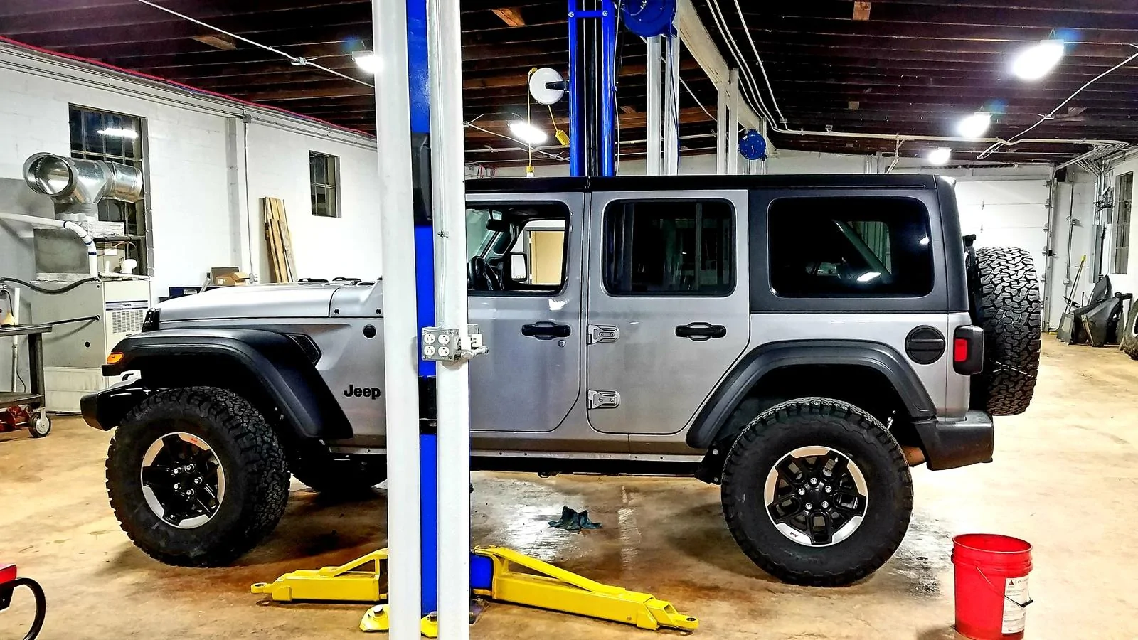

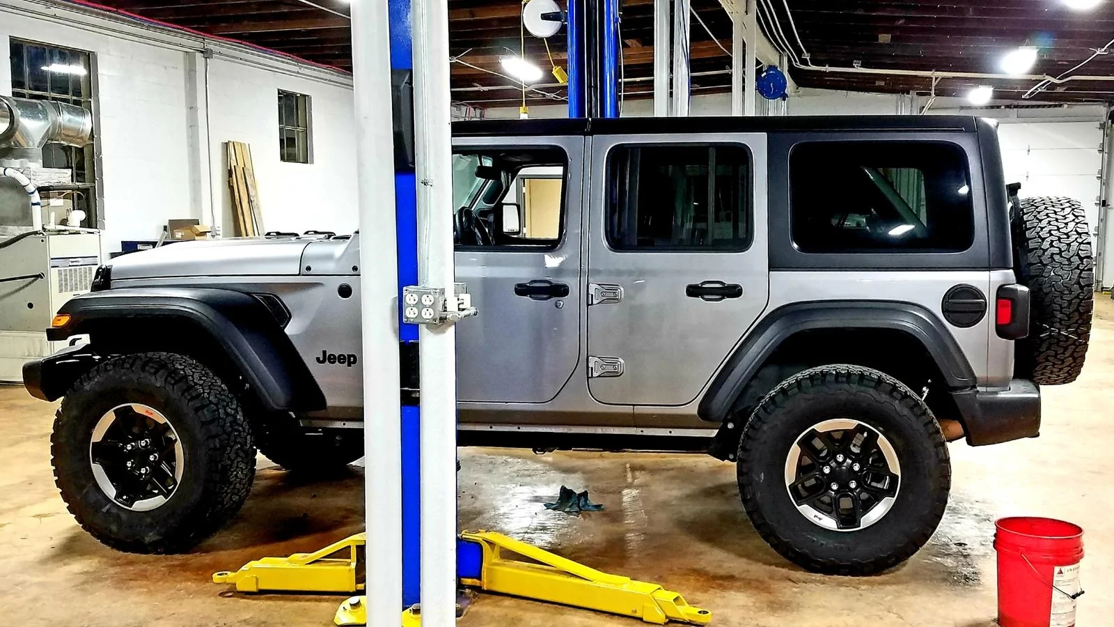

Had the RK adventure 2.5" stage 1 with RK TT shocks installed today on my daily driver jl sport. It gained 1.5" of height in addition to the previous takeoff rubi suspension that lifted it 1.5". I chose the RK Adventure series bc it's supposed to be daily driver friendly and keep a smooth on road ride.
After the lift, the on road ride felt like it stiffened up significantly vs. the takeoff rubi suspension that rode well on the road with same ko2 tires. During the drive home tonight, I pulled over bc it felt like I may have a flat tire and was somehow riding on a rim. Driving over normal on road train track crossings at 10 mph was rough. Tires were the same 315/70/17 bfg ko2 class c at 33psi...so it wasnt the tires. I have a lighter weight sport with plastic bumpers and no skids currently. I understand that there's a break-in period and the ride/height will soften/settle a little, but the current amount of stiffness compared to the previous rubi suspension isnt comparable. I'm going to call RK Monday AM. Otherwise, I like the height...just want the ride to feel more daily driver friendly.
Pre RK lift with takeoff rubi suspension and 315/70/17 ko2's:
Jeep Wrangler JL Rock Krawler 2.5? obRGOwg
Added RK 2.5" Adventure lift with same 315/70/17 ko2's:
Jeep Wrangler JL Rock Krawler 2.5? 873PaGh

I added lockers and wanted to go up a few inches to raise the belly and went to 315/70/17 tires. There wasnt alot of clearance with the lower sport fenders and I was told Rock Krawler Adventure series rode well for daily drivers and wasnt much stiffer than the rubi suspension. As the pics show, I didnt get 2.5" in height, my suspension creaks and I feel about every bump in the road. I wonder if my jeep is too light for a RK suspension?
