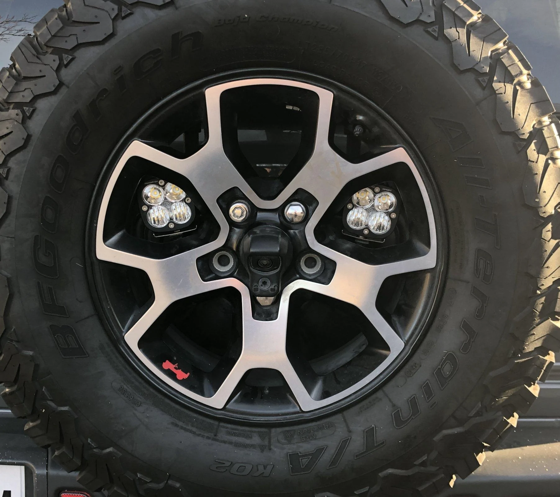

Excellent install. Thank you for the pics. I like the flush mount look and will be doing this on mine.

Do most lights cause the backup camera to bloom like crazy? i.e. almost unusable?

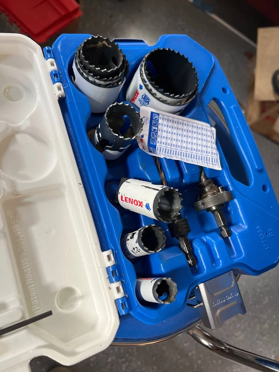

Yes, steel bumpers. I used a 1 3/4” bimetal hole saw. As long as it’s a sharp hole saw, it’ll cut through pretty quick. I pulled it off and did it on a set of saw horses. There is some internal structure in the bumper that you want to avoid to make things easy and you can only see it all with the bumper off especially with the hitch in the way
Going to follow your lead, but have gone down a hole saw rabbit hole….. what brand bi-metal did you use? Thanks!
