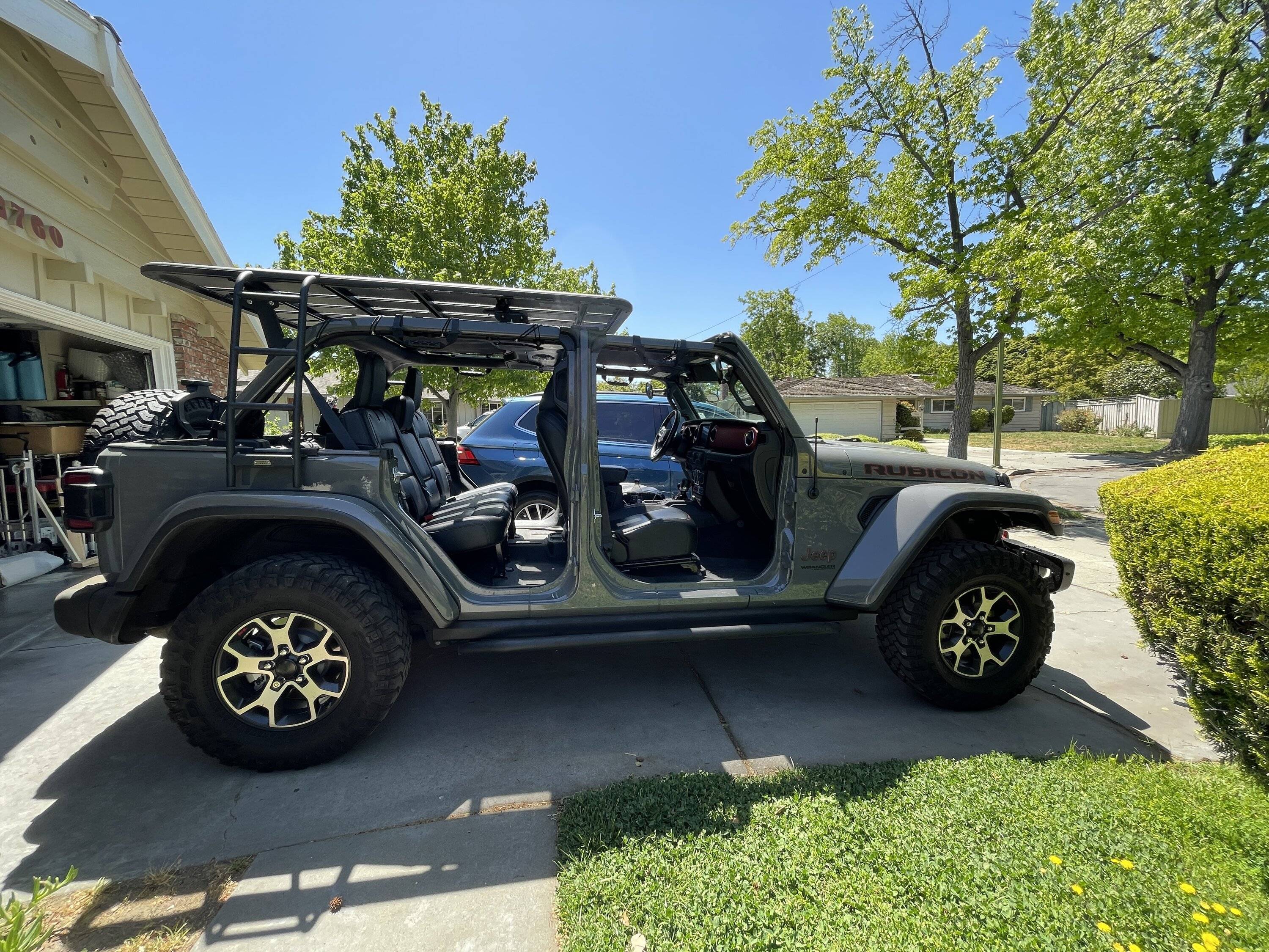

Skip
If you want to never take your hardtop off, go with the Maximus-3. The Maximus-3 has a much higher capacity that would be ideal for an RTT or heavy gear. Otherwise go with the rhino rack. The Maximus-3 is super quiet too. If you’re going to go with the Maximus-3 I’d be happy to answer questions.

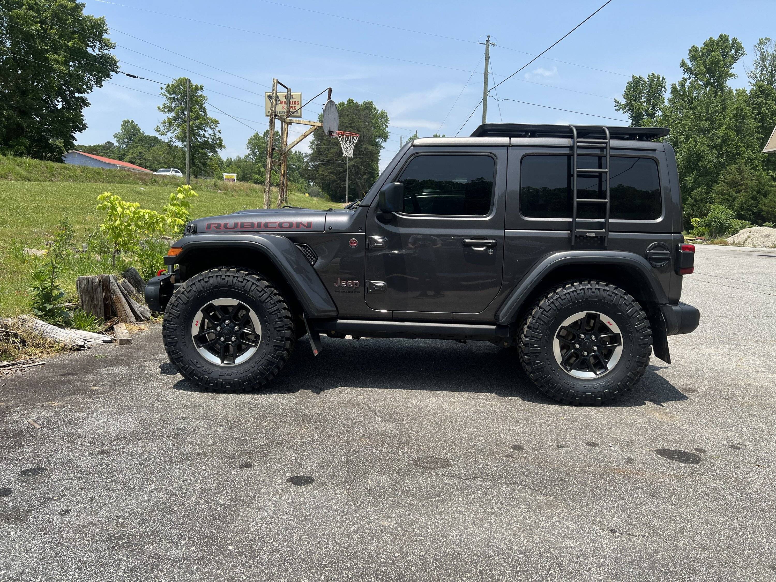

I went Maximus 3, has a cleaner lower profile in my opinion, and they sell ladders which match the kit. .no issue with roof cracks or anything, and it’s been on for a couple of years now. As mentioned, it’s not a breeze to take off the roof once it’s installed. But it is doable, and then you can still have the roof rack minus the roof. A 15 min job turns into an hr, plus some swearing. Completely worth it though

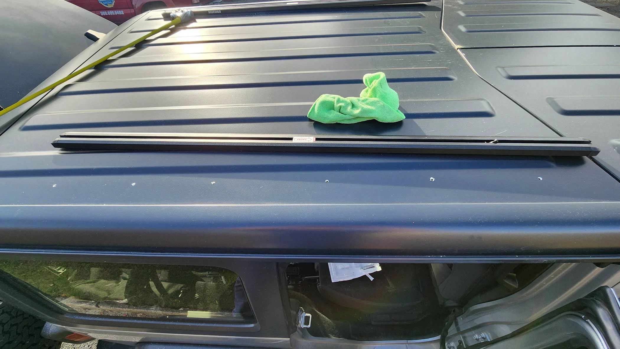

Today I installed the JL Ribcage. Working solo at pace it took me @ 4hrs. Drilling 12 holes into the HT was fun! The back brackets were a PITA to do solo, but a few curses and resets saw it through. The paper install instructions suck, but the video was a great help. I don't think Yakima has done a good job yet of explaning the various options of connecting their various tracks, towers and platforms. I reached out to support and have still not heard back from them. I ordered the LockNLoad B Platform (2-bar) and 6 TrackTowers and the LockNLoad Expansion Pack. This will provide two more connection points (i.e., 3-bar) between the tracks and platform for greater weight distribution. Not that I'm planning on really loading up with alot of weight, but any additional structural distribution will be good. Removing the HT will require unscrewing an additional 8 bolts and I expect it will be a bit finicky re-aligning when putting the HT back on, but here in the PNW, we can't go naked all that often. So I'm hoping this low profile and versatile track/platform will give us plenty of flexibility. Fingers crossed!
