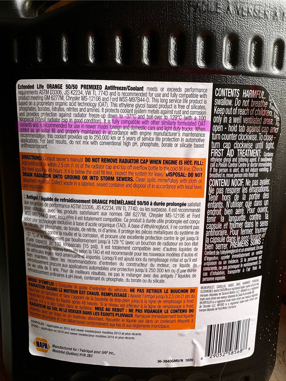

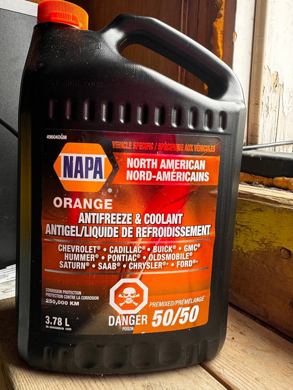

My new-to -me 2019 Rubicon unlimited had a coolant leak last week, and my husband is repairing tonight. He got me to pickup some coolant-last time I just stopped by the dealership & picked up a jug, but I suspect the cost is what made him as me to go to the local Napa & get 2 jugs of this.
On a previous vehicle we had caused problems from using inferior product. Will this be ok for my Jeep??

That coolant looks like it would work in your Jeep, However it doesn't meet the Jeep MS.90032 specifications. Additionally this NAPA coolant is only rated for 5 years whereas the Mopar coolant is rated for 10 years. In my area the Mopar coolant is the same price as this NAPA coolant.

Double check the language in the Owner's Manual, Tammy. It probably stipulates a coolant that is "OAT" only, meaning Organic Additive (or Acid) Technology. Avoid coolants with HOAT, POAT, or particularly any that are sold as "universal", which blends the ratings.
Yes, it's best to use OEM-branded antifreeze, if you can source some easily.

The Mopar is double the price here, but I’d rather pay it than wreck something else…

Don't use that orange crap, that is the old version of coolant and they are incompatible. Napa doesn't have a violet generic coolant yet. Zerex G30 or OEM.
Gotta love that weasel wording they did there. It is "compatible" with MS-12106 coolant. Not that it meets the spec. I still wouldn't use it.
