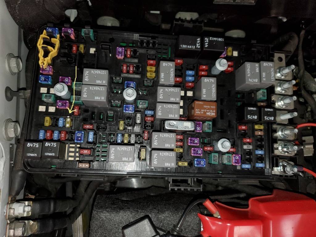

Ok here’s another suggestion from @Rhinebeck01 to reset Uconnect. His suggestions are usually spot on. But ymmv.
To reset UConnect,(your radio) you can pull fuse F97 while your JL is running, wait say 10-15 seconds and then plug the fuse back in... now turn off the JL and then restart your JL.
Yellow arrow points to F97 .
I will definitely be trying this tomorrow!! Thank you so much, I’ll let you know how it goes!!
