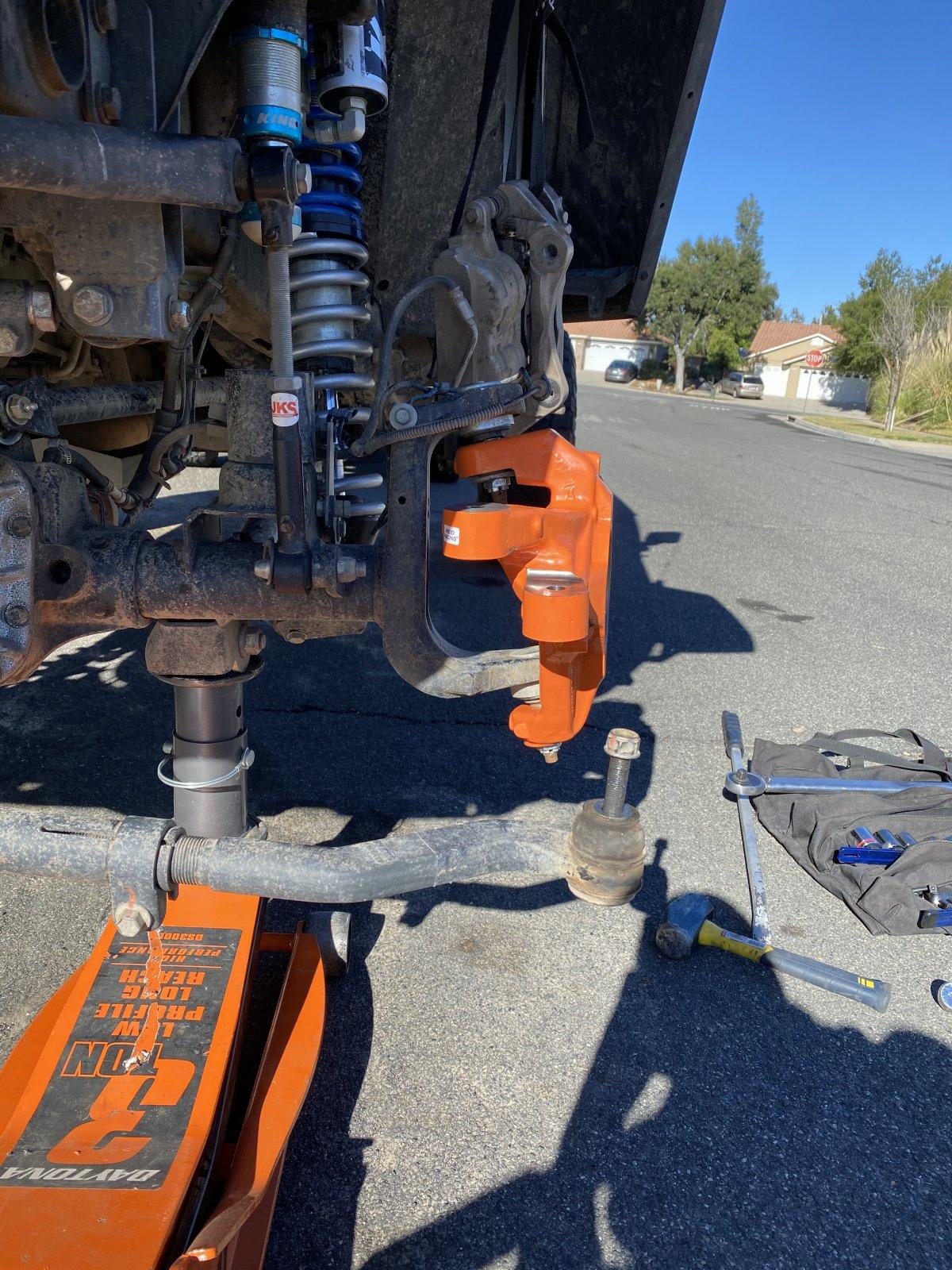

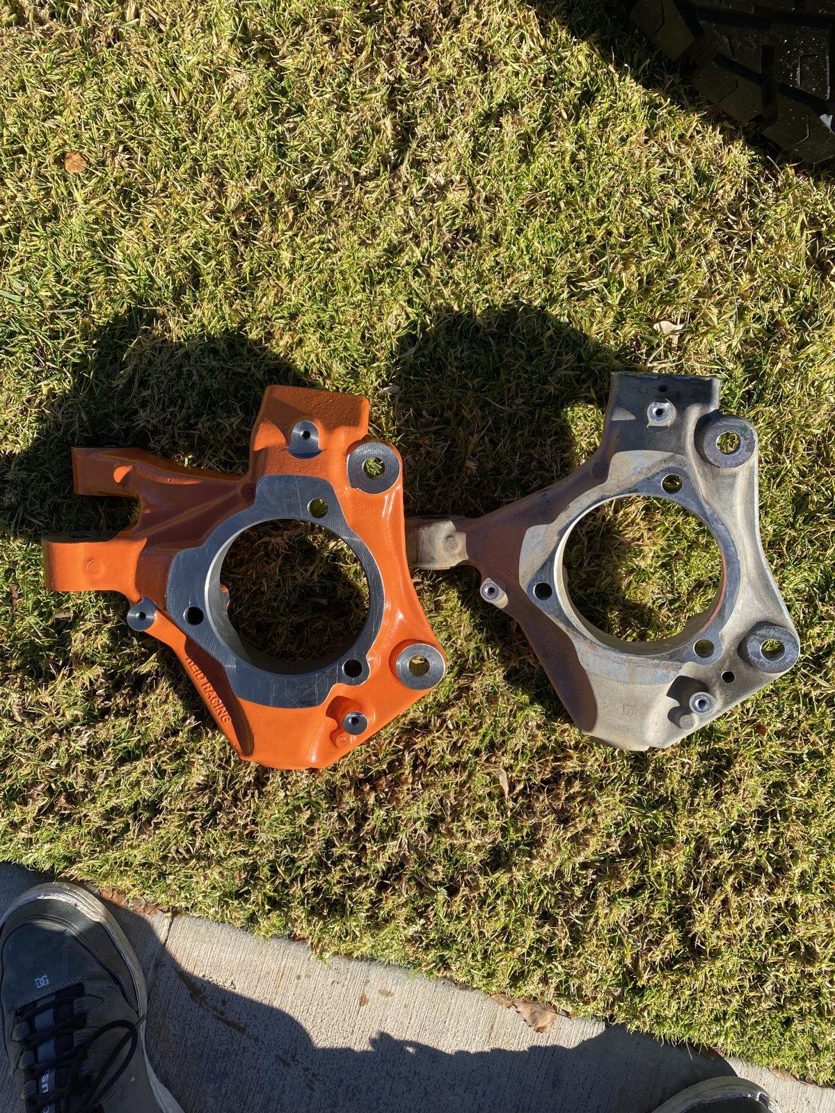

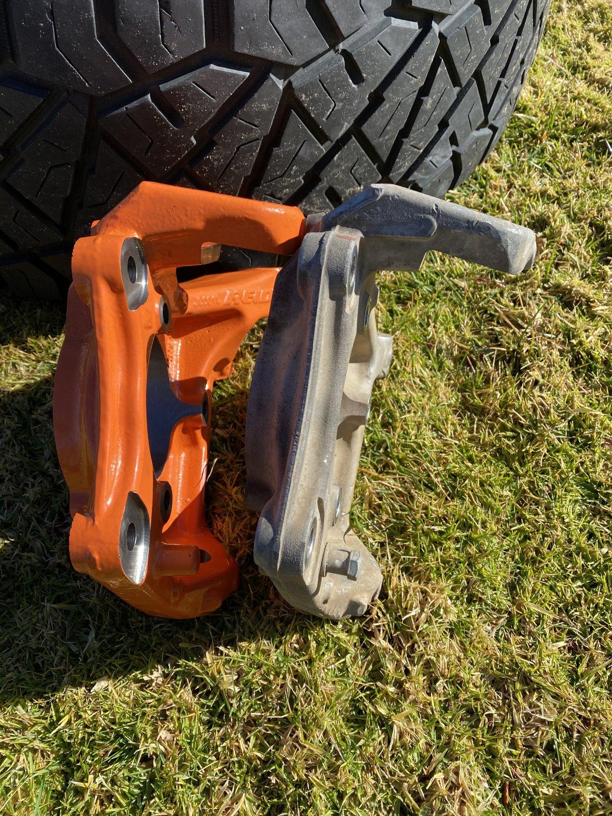

Right on. They were my last part lol. I have nothing stock up front besides the hubs, which are brand new.Mine are supposed to ship on the 10th, hopefully I get the ball joints sorted out by then. Glad to hear you think that they made a difference in the steering. Hopefully these will be the last piece of the puzzle.
I found some play in both the wheels today I would have put money on the fact it was the hub bearings. Unfortunately it’s the brand Ned Dana HD ball joints I just put in a few weeks ago. The lowers have about 1/16th play. I’m hoping I can get Dana to reimburse me and just go with the Dynatrac.Right on. They were my last part lol. I have nothing stock up front besides the hubs, which are brand new.
Oh thats a bummer, i love these dynatrac ones. Yeah they still take the camber sleeves, but they fit much better than in the aluminum, one was always high and one was always low, now they are dead even. And I didnt take any off the steering stops they were perfect for meI found some play in both the wheels today I would have put money on the fact it was the hub bearings. Unfortunately it’s the brand Ned Dana HD ball joints I just put in a few weeks ago. The lowers have about 1/16th play. I’m hoping I can get Dana to reimburse me and just go with the Dynatrac.
Do the Reid knuckles still take the upper camber correction sleeves? How much did you have to cut off the steering stops?
