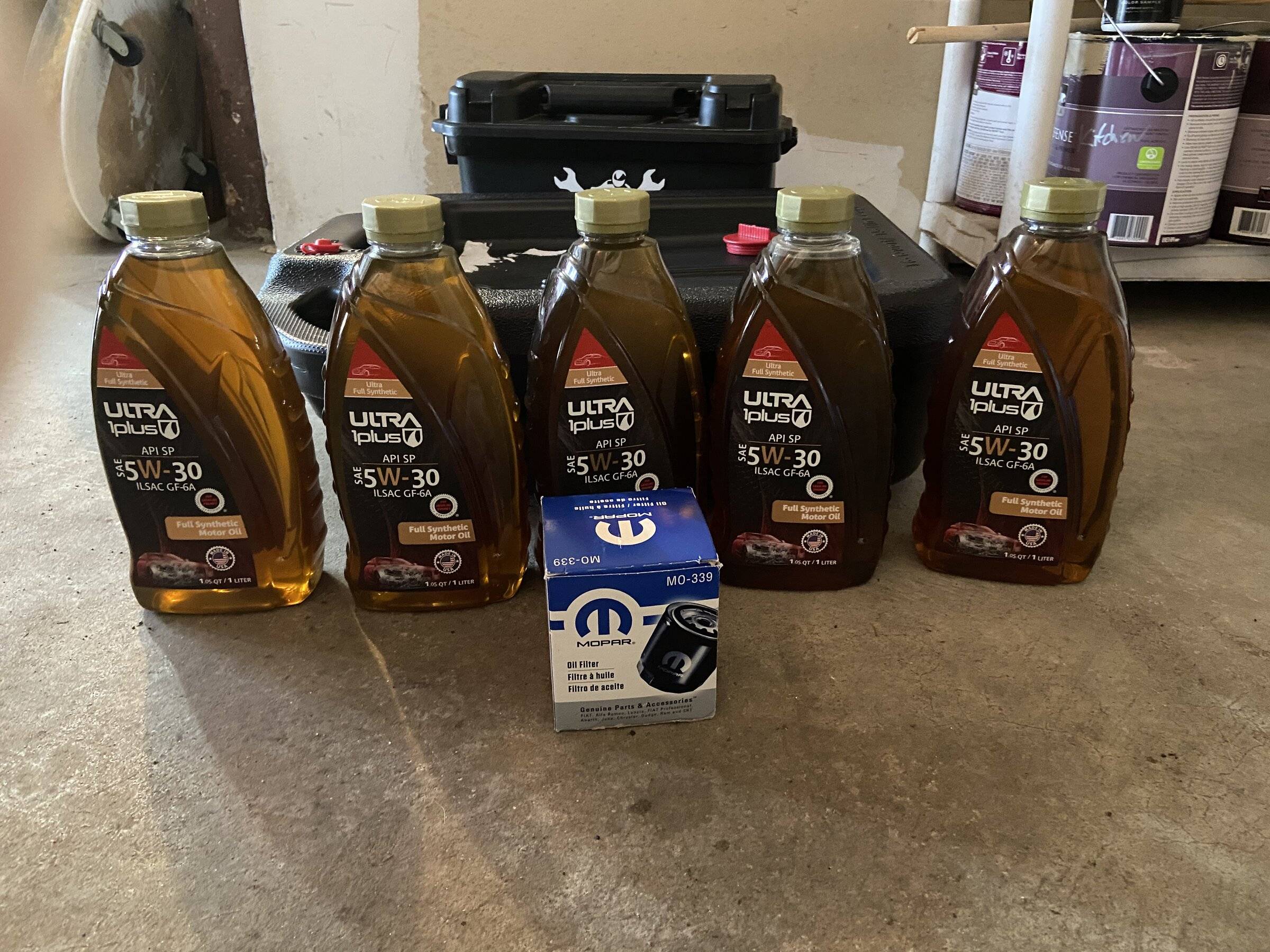

Did my very first Oil Change at 5K miles last month and this is what I use:
Jeep Wrangler JL Recommended Oil for 2.0L CB5528BA-244F-4D75-B3B1-4FED265CF6B3
Jeep Wrangler JL Recommended Oil for 2.0L D522B655-4E41-4EFB-9EEB-80E4EB885D6E
With an OEM Mopar Filter, I use Ultra1plus Full Synthetic Oil in my 2022 JLUR. It’s API SP (exceeding API SN Plus Certification) and American made (bottled in Texas and distributed in Florida). I have already clocked more than 2k miles in and the Oil still remains a light to medium brown hue. The 2.0 runs absolutely smooth in all driving conditions (highway, backroads, towing, and trails etc), and kept me going thru my most recent mini Road Trip last weekend.
I guess I could do a Full 5K Mile Review on this sometime soon, but I absolutely recommend this Brand!
