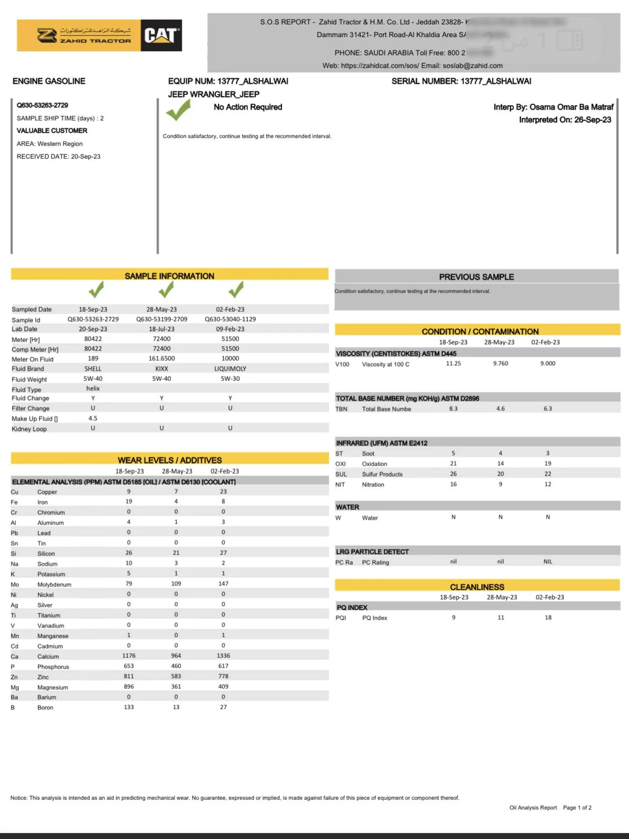

Chimico 👨🏻‍🔬
These numbers, 5W-30 and 0W-30, are not suitable for heavy-duty use. I have analyzed the Liqui Moly Molygen 5W-30 oil, which has API SP specifications. I have also tested different types of 5W-40 API SP oils, such as the Korean-made Kixx, Saudi-made Shell Helix Ultra from natural gas, and currently, I am in the process of testing the American-made Lucas oil.
I have come to realize that for heavy-duty use, in hot weather conditions, traffic congestion, and off-road environments, the oil viscosity should be very high.
Soon, I will conduct tests and analysis on 0W-40 oils, such as the Omani-made Shell Helix Ultra and the Amsoil Signature Series, which is made in the USA.
