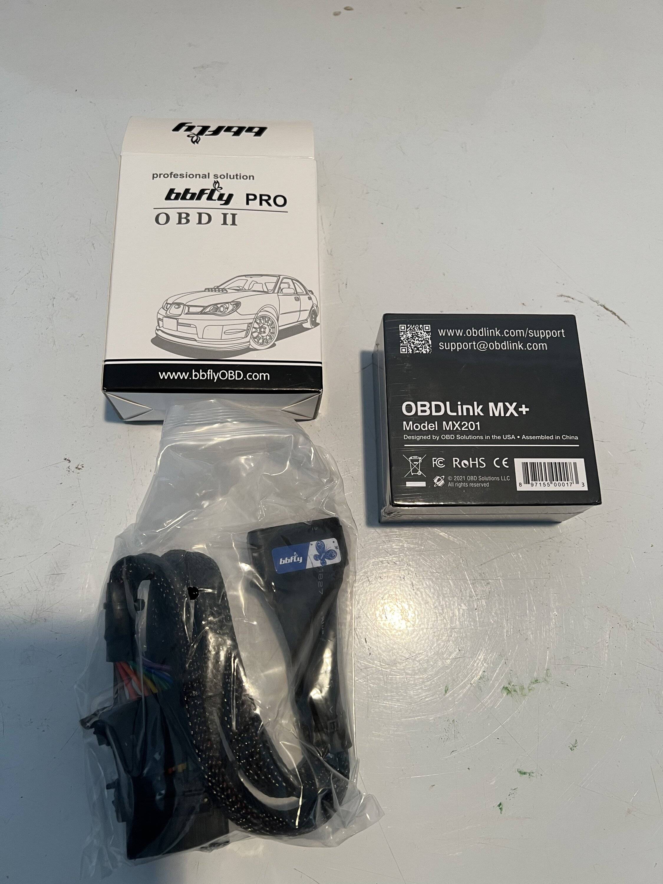

OK…I just got these for the JScan…do I need anything else?
Why the bbflyobd extension cable... The OBDll port is right there.... as in easy access... and the scan tool is Bluetooth enabled.
Return that bbflyobd extension cable and buy a ZAutomotive security gateway extension cable...
https://www.zautomotive.com/product/z_sgw_ext/
Remember you also need a SGW bypass... Do go with a dedicated security gateway bypass module and not Chrysler 12+8 cable..
https://ecri.app/products/ecri-secu...OgRhPDv9fRE2FfWLyBfbmjcqYb0uIWDikTq11iP0NLJZY
It actually came with the OBDLink MX+ and was actually surprised when I opened the package…got it from EBay.

Just bought…so what gets connected to what to use the JScan?
The two cables you disconnect from the security gateway plug into the ECRI dedicated bypass module. The OBDLink scan tool plugs into the OBDll port.
I strongly .... very strongly encourage you to buy the security gateway extension cable from ZAutomotive and wait for it to arrive before you fool with the SGW connections.. This way, you will only have to deal with the SGW cables once...
