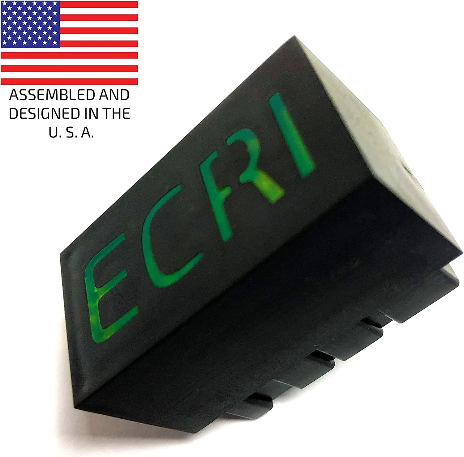

A far better way to go then going with old school / clunky / iffy 12+ 8 Chrysler programming cables is to go with a dedicated security gateway bypass module.
Such a dedicated module costs about $15 more then 12+8 Chrysler programming cables but resale $ amt. is very good on a dedicated security gateway bypass module.
Here is a decent SGW bypass module:
Jeep Wrangler JL Recommended OBD Scanner for 4xe? 111
https://ecri.app/products/ecri-secu...OgRhPDv9fRE2FfWLyBfbmjcqYb0uIWDikTq11iP0NLJZY
Note: IF, you have a Tazer JL, you do NOT need to buy 12+ 8 Chrysler Cables or a dedicated security gateway bypass module for use with JSCAN as the Tazer JL Mini or Lite will do the SGW bypass duties when you use JSCAN.
