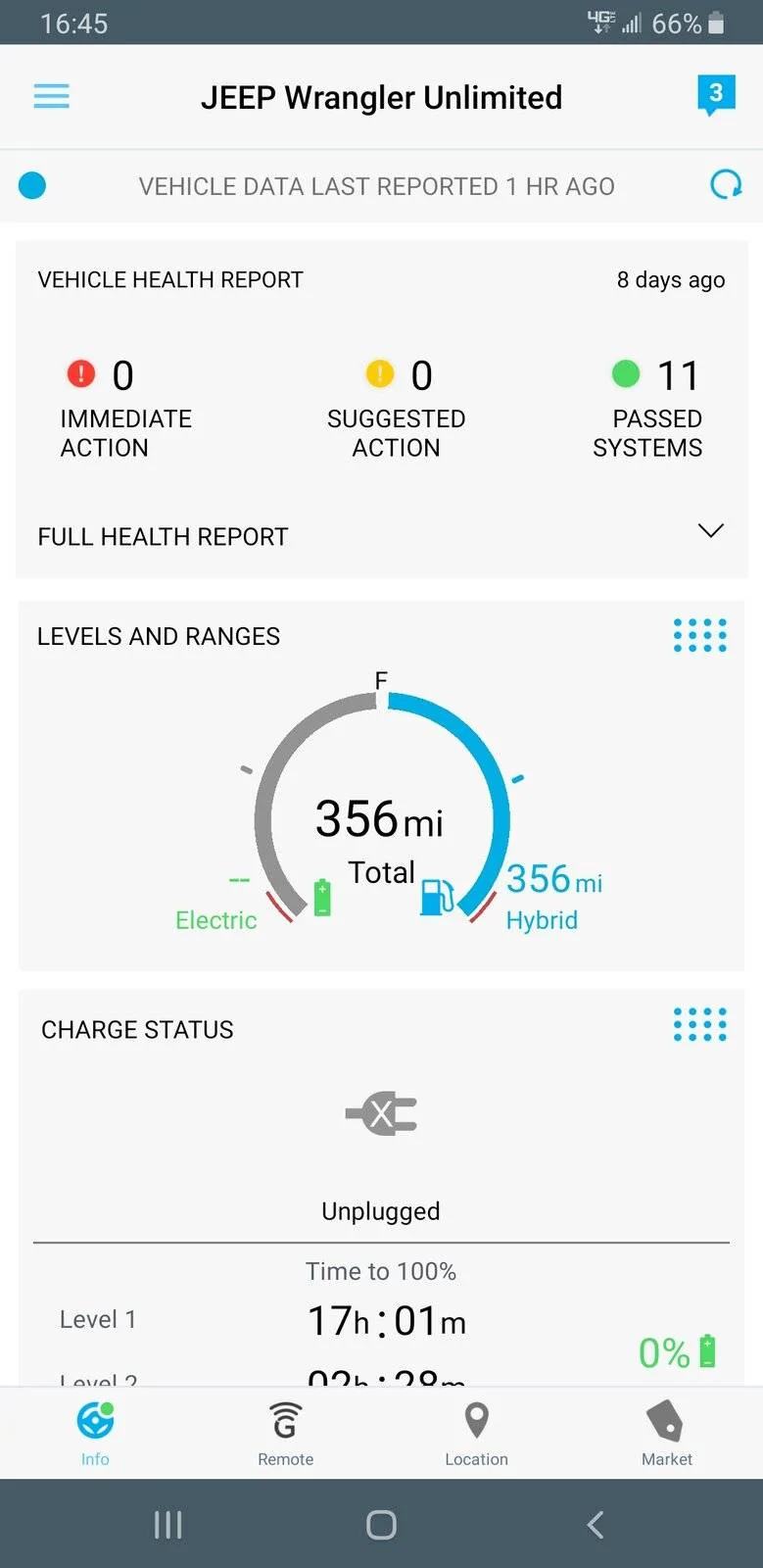

Weird. I can see information in my Uconnect mobile app. See screenshot.

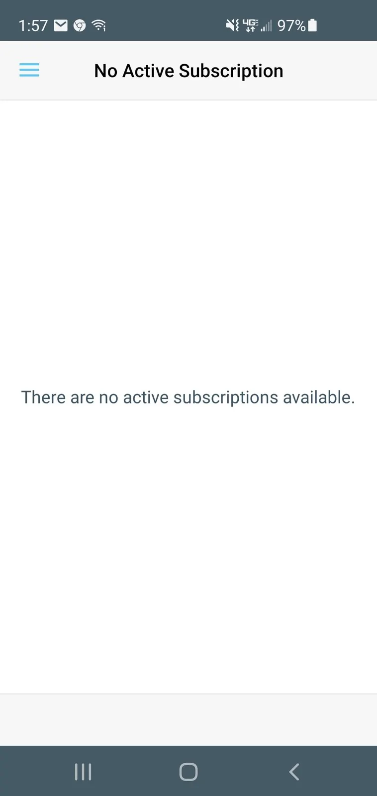

Here is what I see.
I must be missing a step somewhere....

I think your dealer needs to activate your account. They wouldn't let me leave without doing so.

I was using the wrong e-mail address for the owner account and Uconnect. Entered the e-mail address that my wife gave to the dealership and it worked fine. Just need to call Sirius and set up the PIN now....
Thanks for the help.

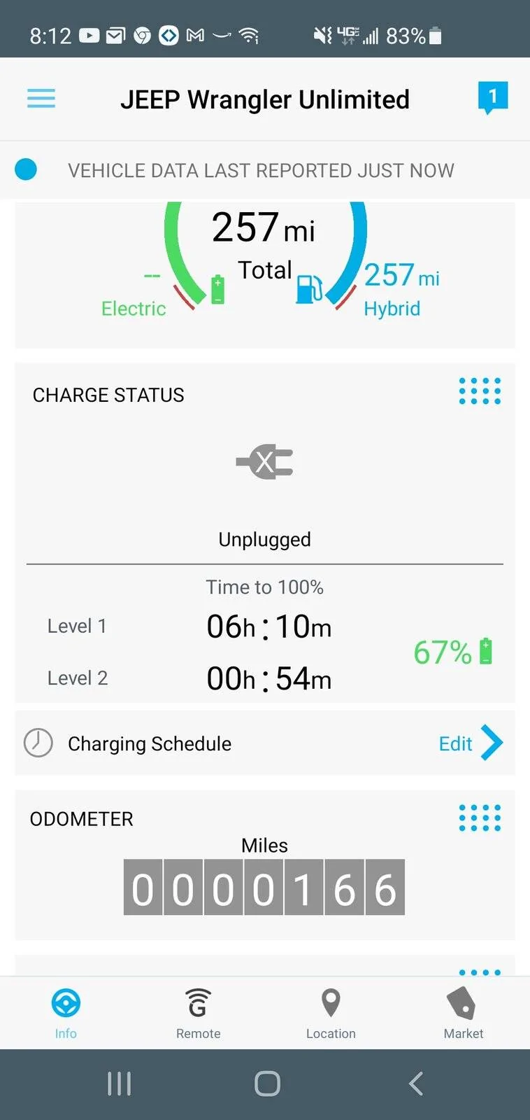

Full information from the vehicle, including charging information, etc.
So it seems the uConnect registration the dealer performs is apparently, very specific to the owner information. If you having issues, try updating your profile to match your personal info that you provided to the dealer (correct name, address).

Issue resolved. Thanks to everyone for the help. I had to call Sirius Guardian and set up a PIN. It started working after that.
