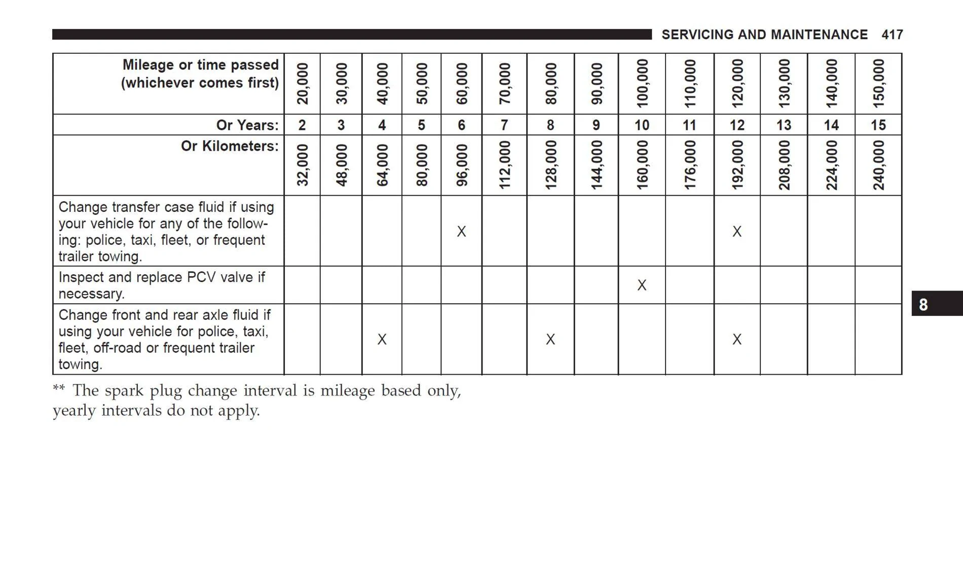

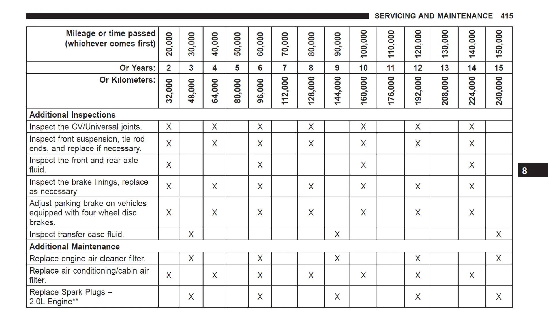

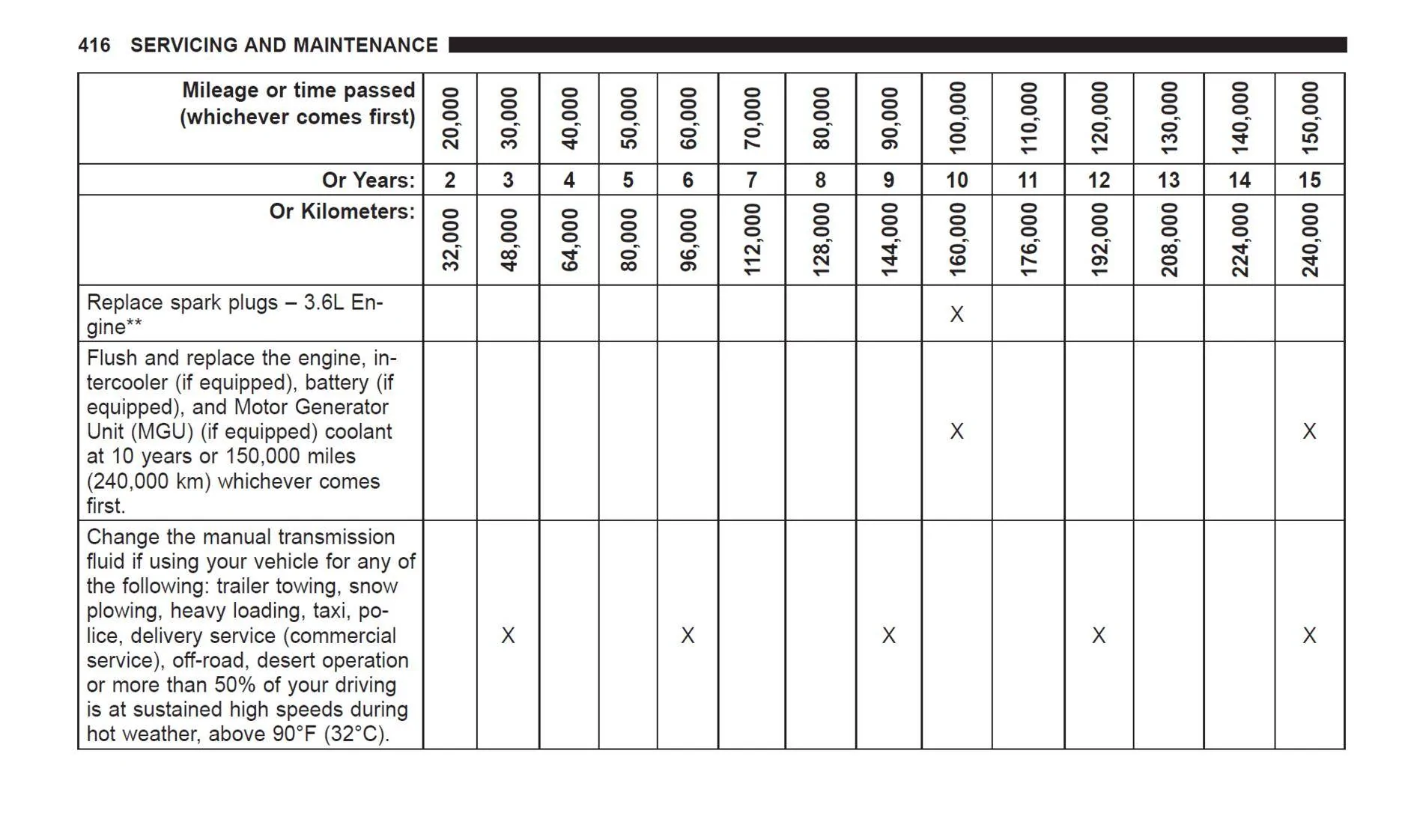

So he’s probably basing it off this. There’s really not anything at the 30/3 mark that is worth doing on a time basis. If you feel like changing your own air filter, that might be worth doing, but I sure as hell wouldn’t pay a dealer any money for the privilege. Note the note at the end that says the spark plug interval is ONLY mileage-based.

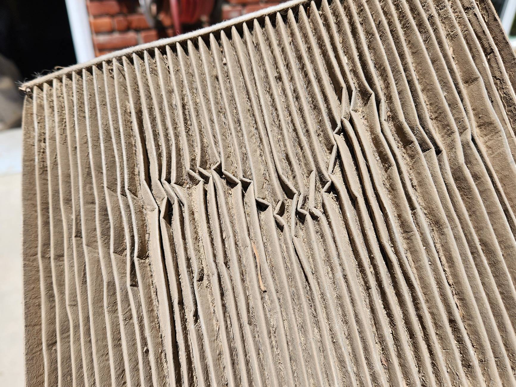

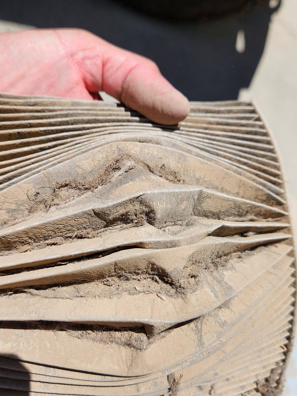

I can tell you that recommended service interval chart is bogus. It says to change the cabin air filter at 20,000 miles.
You want the truth? Here's the truth. 34,500 miles, 20 trails or more, on this cabin air filter and it was "fine". 🤣
