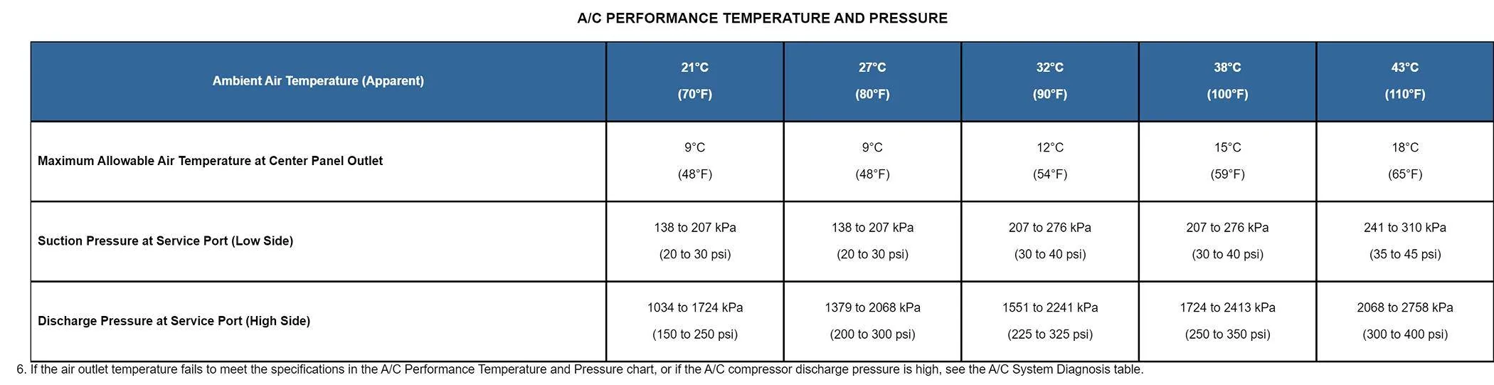

You can't know how low it is until you evacuate it. You need to evacuate it to see if it's low. It could be down 100-200g and you'd never know because the pressures would look identical.
Edit; looks like spec is a maximum of 59f at 100 degrees. Thought I doubt it was 100f where they were doing the actual testing.
Jeep Wrangler JL Recirculate not working? 1718833133947-63
Thanks. They didn’t evacuate it, just checked the pressure. I’ll try again. Unfortunately for me, it probably was 100. That’s just life here. But it isn’t blowing 59 or even 65 midday even though when I’m on the highway.
