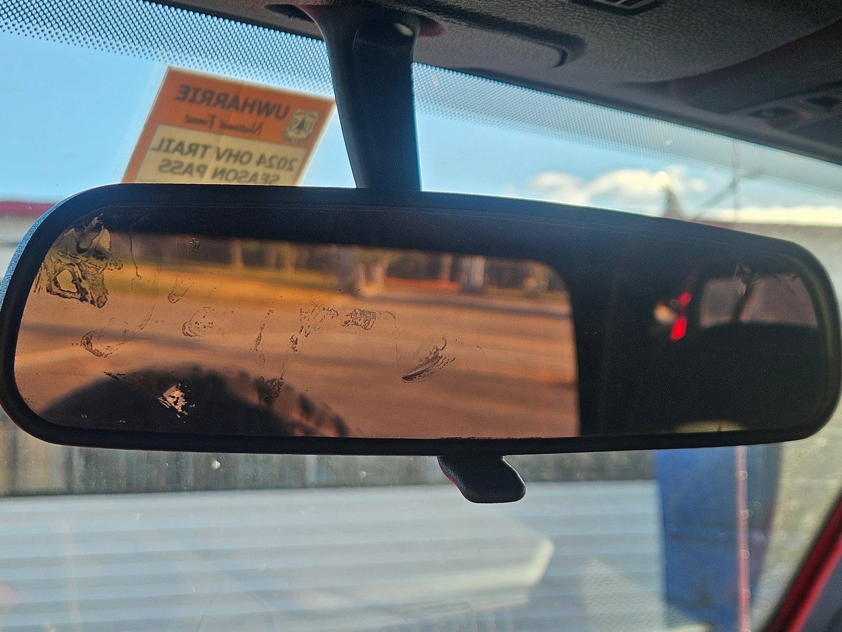

Well add me and my 2018 2dr to the club, and give me credit for searching before posting a new thread. I assume being 6 yrs old and past 36kmiles, there's no recourse thru Jeep corp. Has anyone bothered to replace their rear view mirror yet? Curious what p/n is needed, how much it costs, and how difficult the fix will be.

Just doing a quick search from a supporting vendor of this site, the mirrors without all the electric and auto-dimming options are pretty cheap...$35?
https://parts.allmoparparts.com/oem-parts/mopar-inside-rear-view-mirror-68297610aa
It is super easy to replace. I ordered a new mirror and replaces it myself. You need no tools. the mirror itself rotates 90 degrees in its position and then will drop out. you will have to use a bit of force. It is designed this way anyway for when the windshield is lowered. Mirror was like $40.
