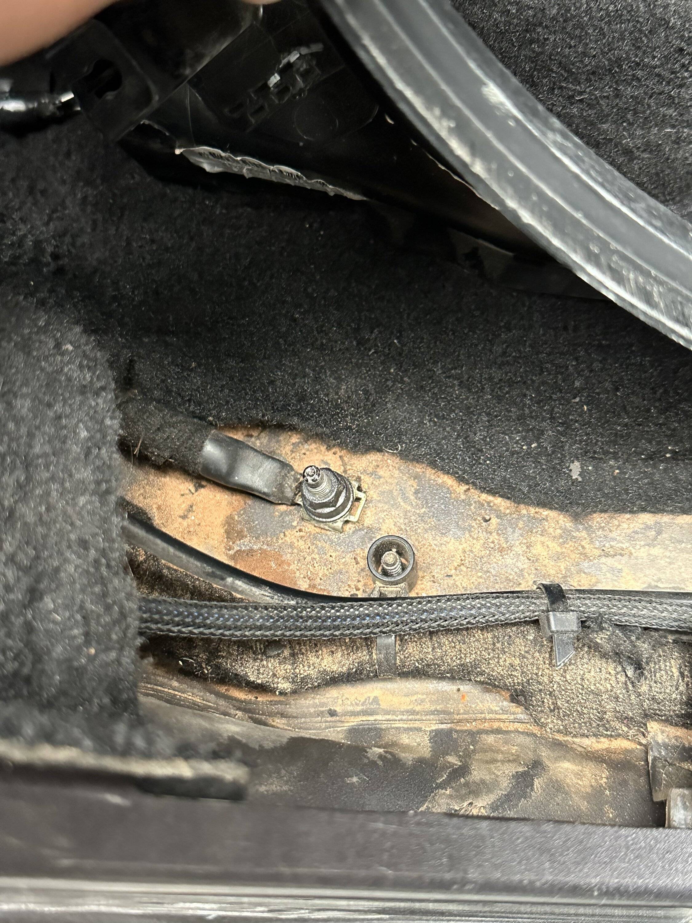

So my right rear tail light recently went out completely. At first I thought it was the Oracle light that went bad but I put on my OEM LED tail light and it still was out. B160Fb is the code I get (right tailamp 1 control circuit). Thought it would be just a fuse issue but I think it’s more than that. Anyone has any experience with this? Left rear tail light is working fine.

So this happened after getting the Jeep detailed. I went ahead and checked the grounds and one of them was loose. This was the one that leads to the tail light amongst other things I think. So this fixed the issue. Just wanted to share! Jeep on. Pic of the jeep getting detailed after five years.
