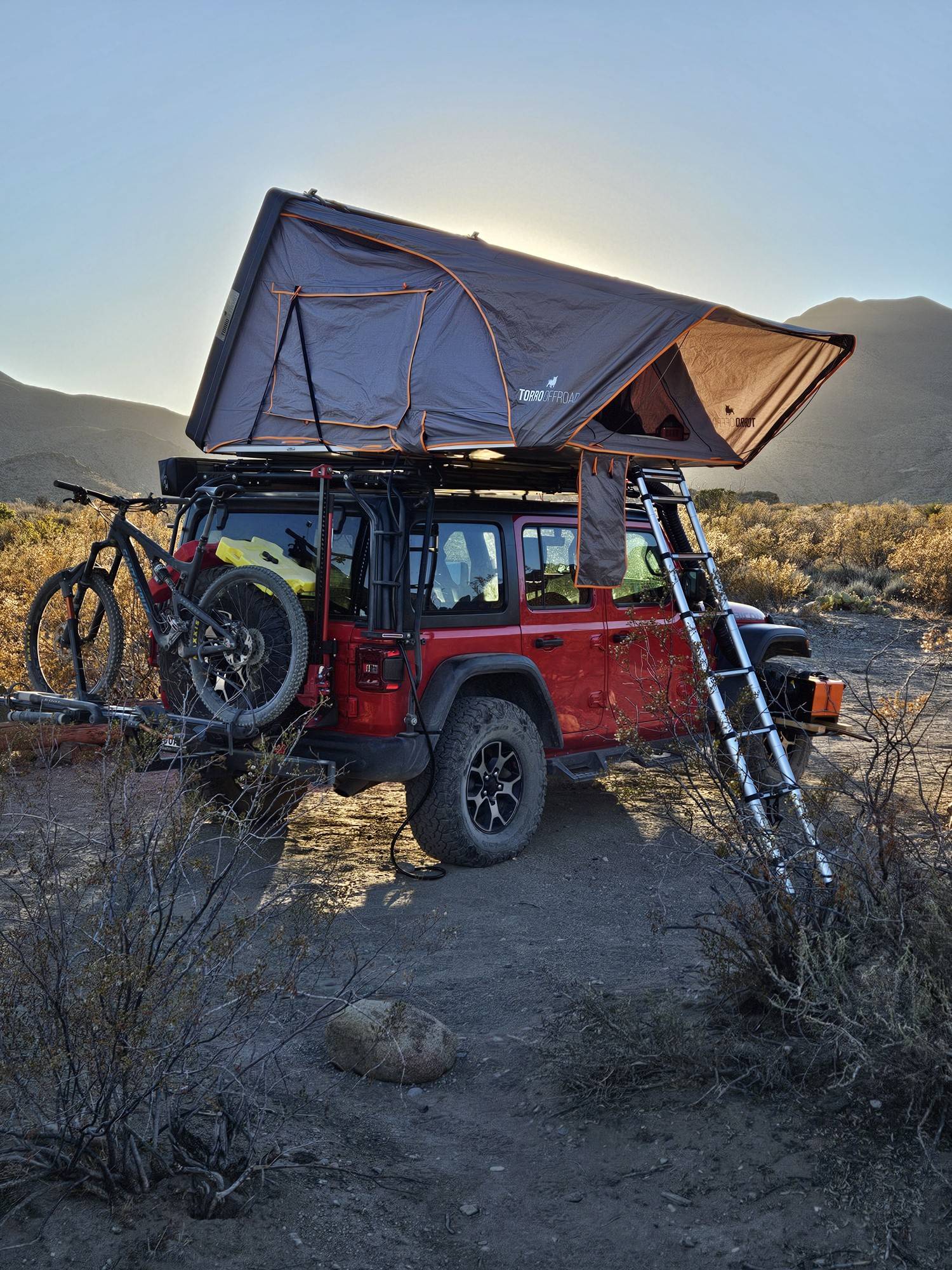

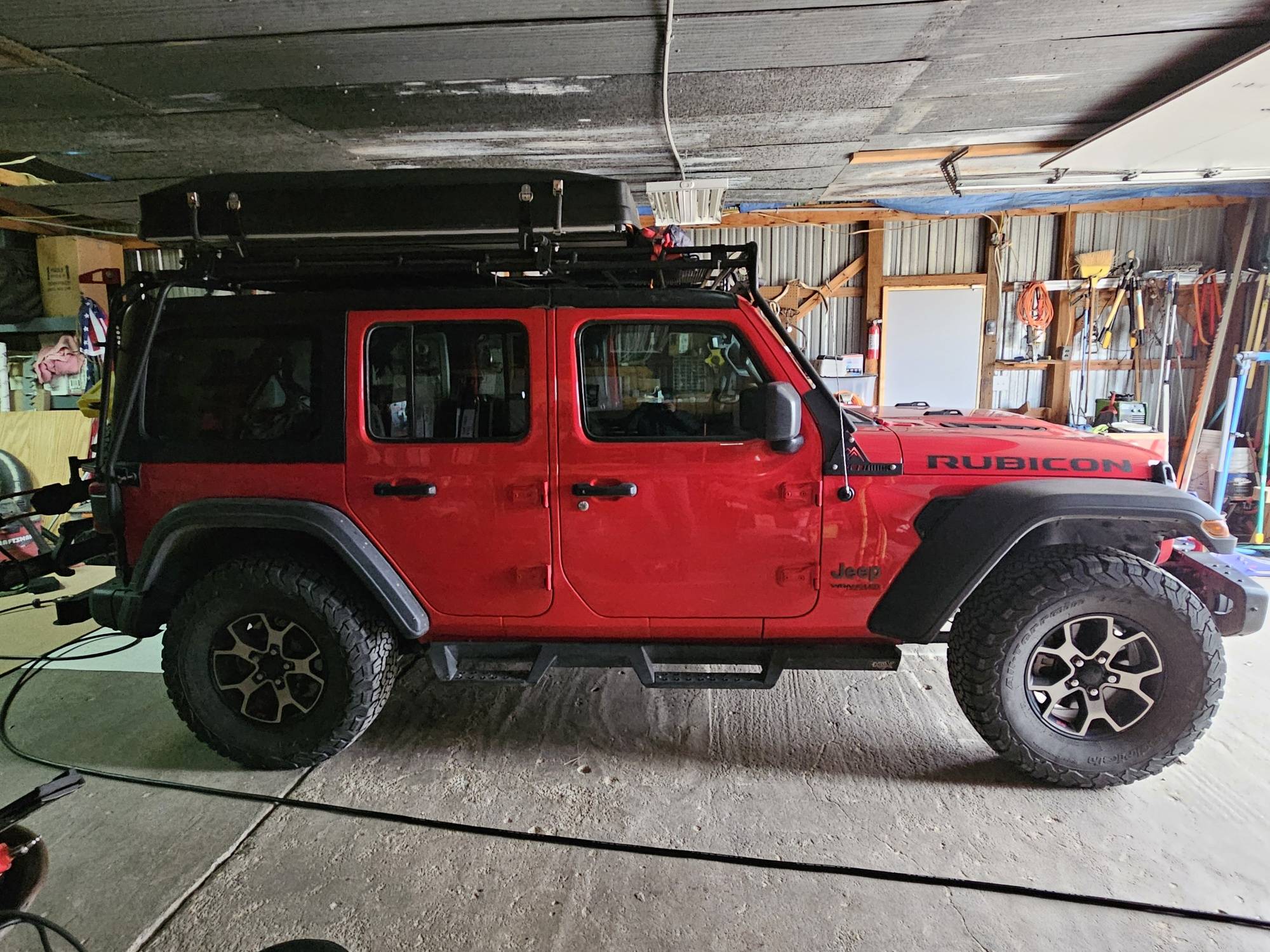

Recommendations please. I have a stock height 18 JLU Rubicon 3.6 with 35s on stock wheels. I travel loaded with a Gobi rack, roof top tent, bike rack on the back and inside loaded with gear. Needless to say the rear end sags significantly. I tried the air lift air spring helper which will lift the rear end but requires exceeding the recommended pressure and it gradually deflates. I'm looking for a more permanent/effective/reliable solution and honestly don't know enough about suspension to know what I need. I am 4-wheeling trails, mountain passes etc. not just dirt roads. Thanks in advance.

Check with Clayton. I went with their Dual Rate Springs and it solved my problem. More than likely, you will need to upgrade the shocks for the weights. Accutune Off-Road can help you with the shocks.

I would certainly consider heavier springs and maybe even a Timbren
I second the Timbrens. Cheap and easy solution. Looking to add a set to our Gladiator the we use to tow a travel trailer.

Can't go wrong with Old Man Emu.
