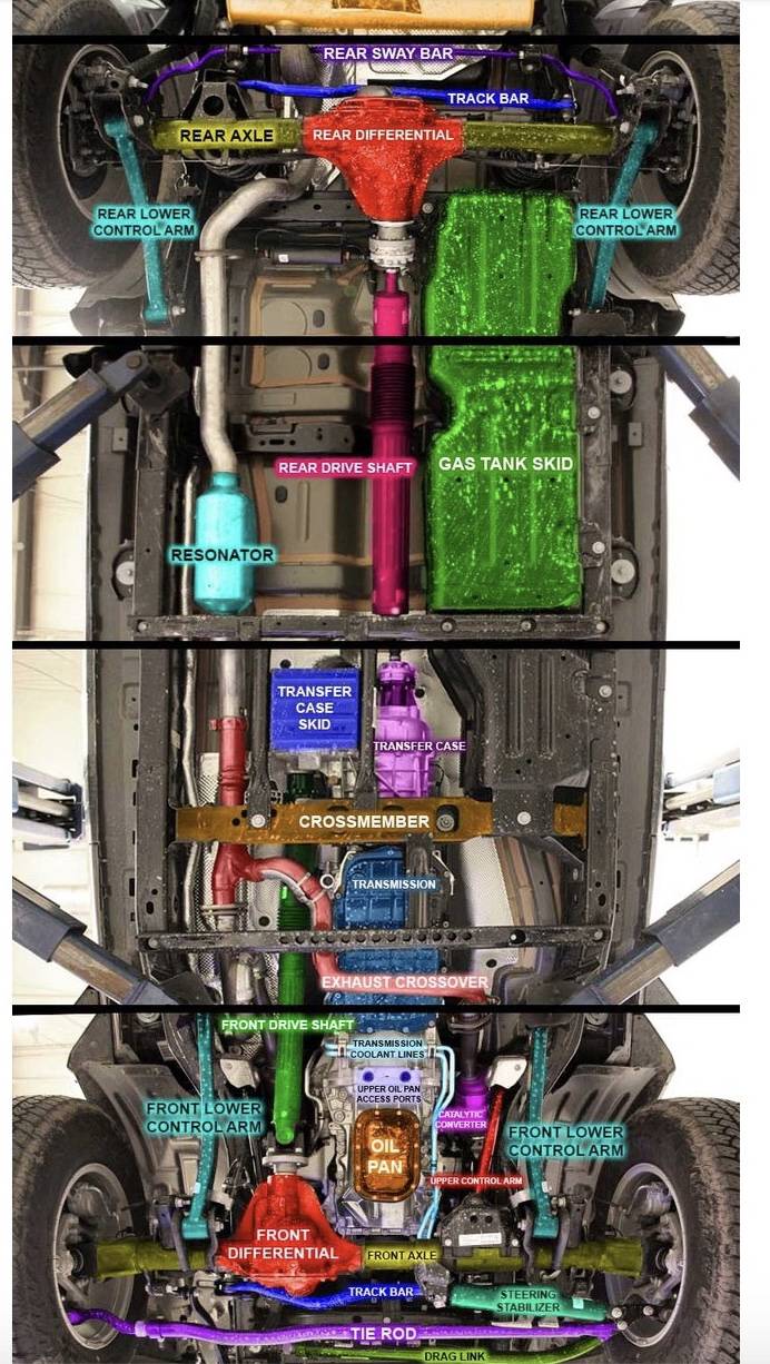

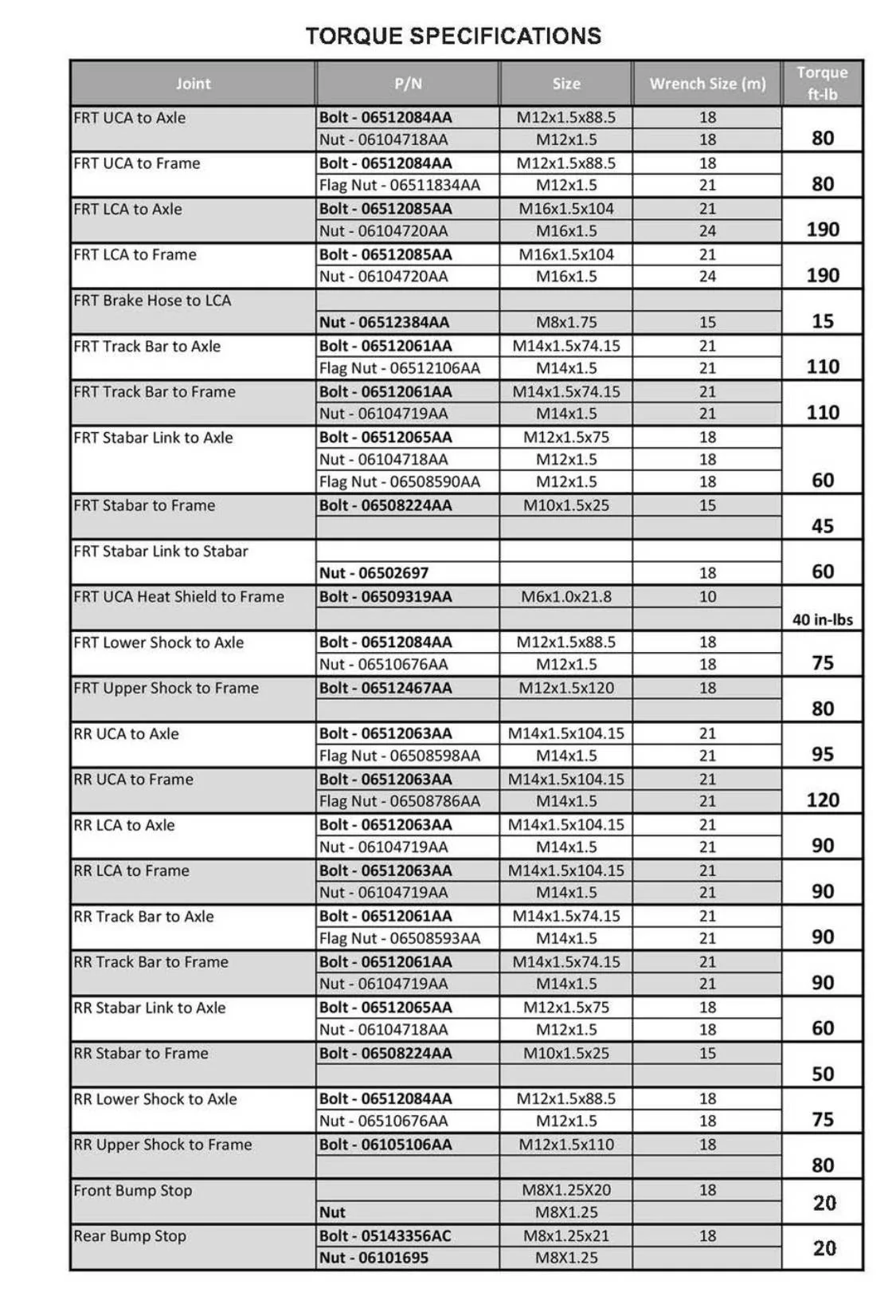

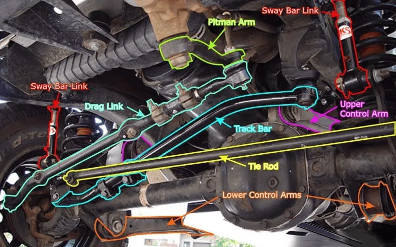

This may not be the right place for this question, but I also want to torque check everything on the chassis. The specs. Should be in the manual.
But being a jeep newb I don't know what parts are what under there. I remember seeing on here someone posted a pick of the suspension parts labeled so you knew what everything was.
Anybody know where that pic. Is on here. If not I guess I will do some Google searches.
Thanks again.

Thanks for the replies. I think I have it sorted.
Thanks again.
Jeep Wrangler JL Rear/Front axles/Fluid IMG_2024
Jeep Wrangler JL Rear/Front axles/Fluid IMG_1827

You guys are awesome. Thank you so much. It's my first time getting under there and torque checking everything.
I will save the info. For next time also.
Thanks again
