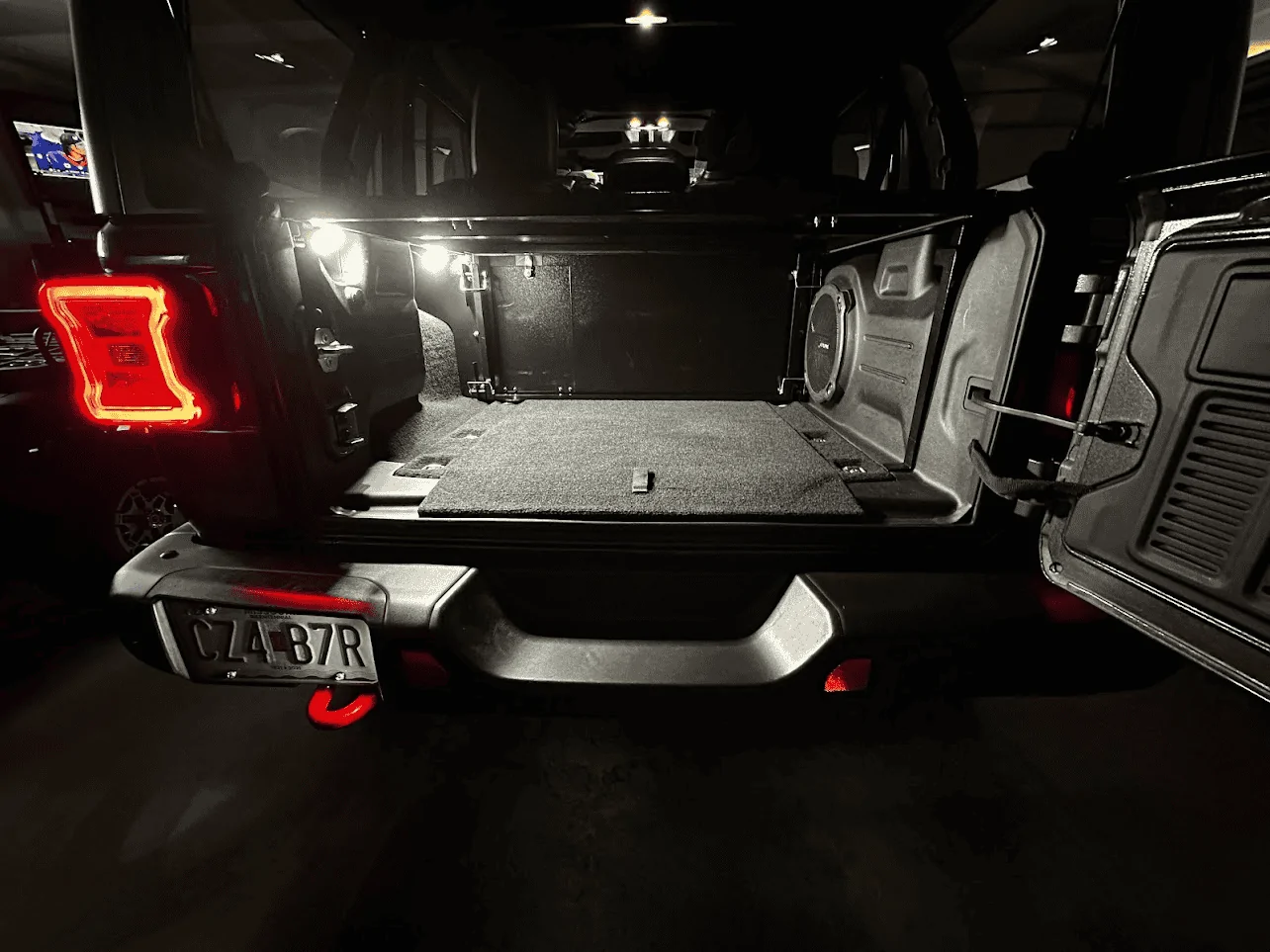

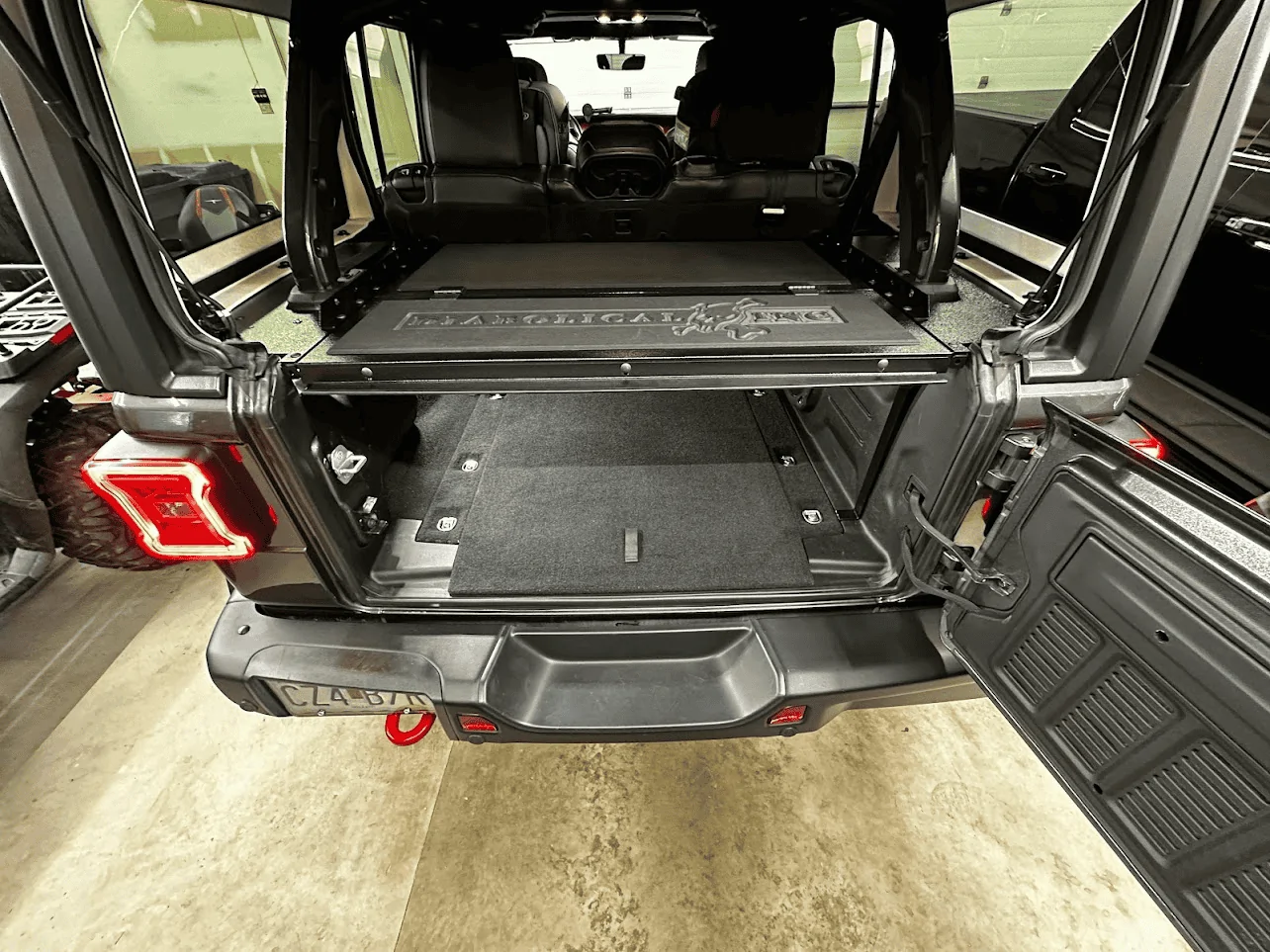

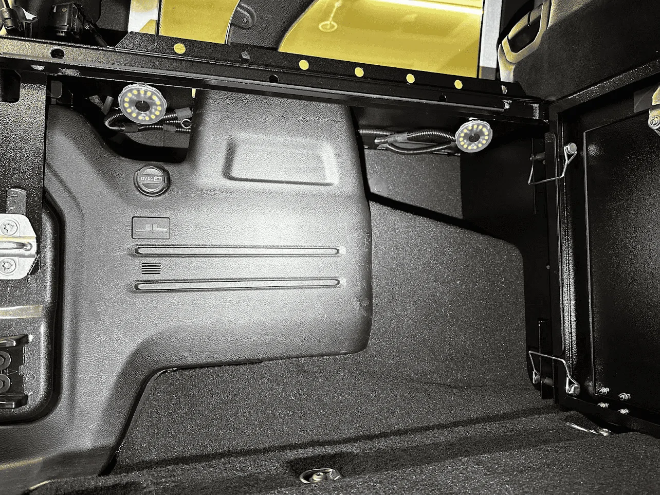

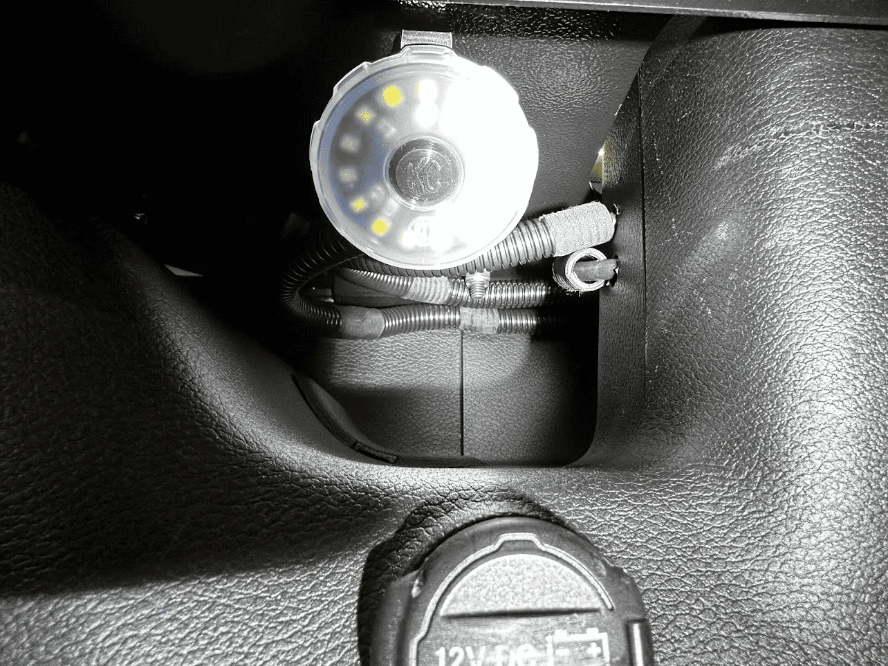

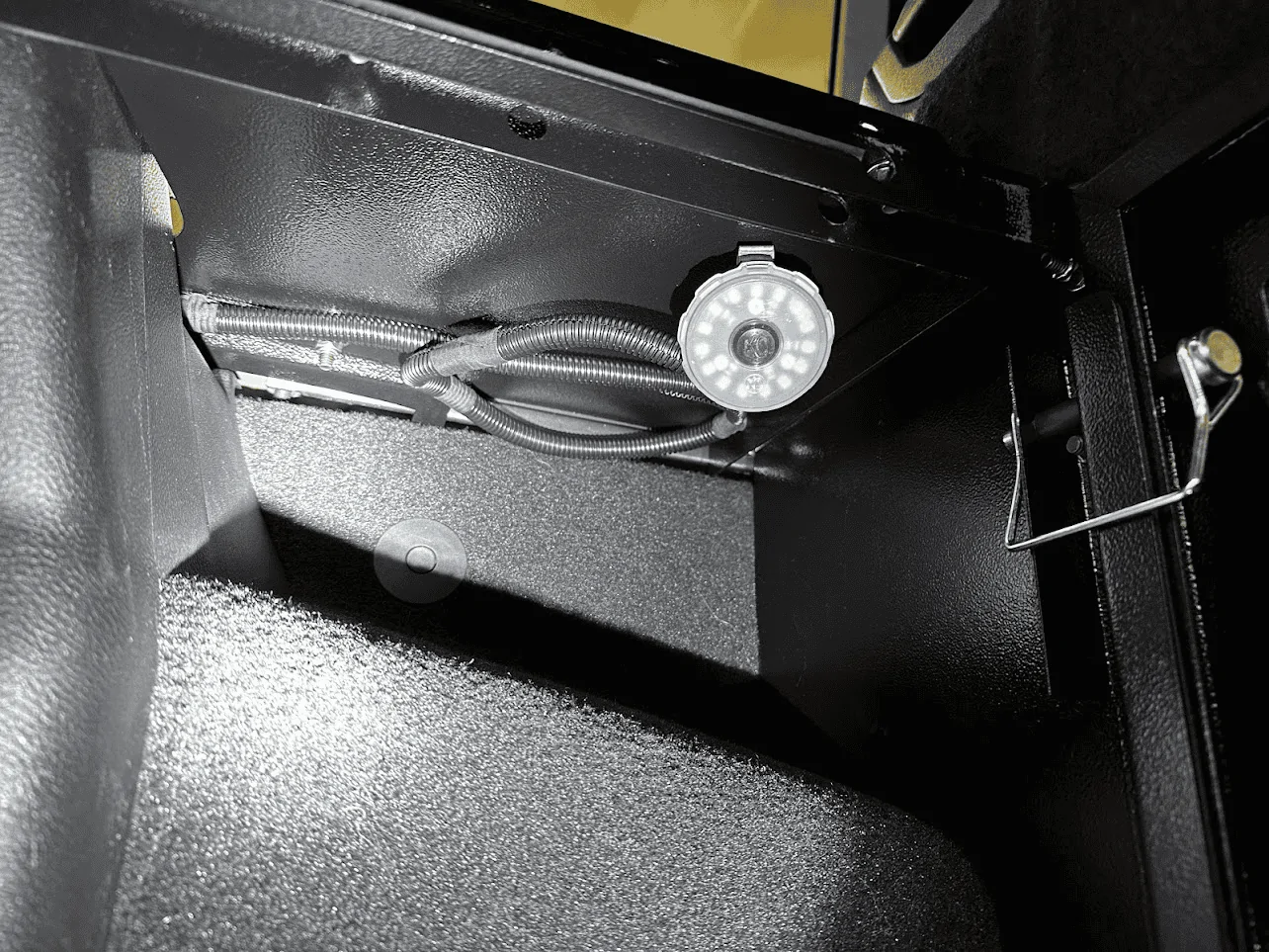

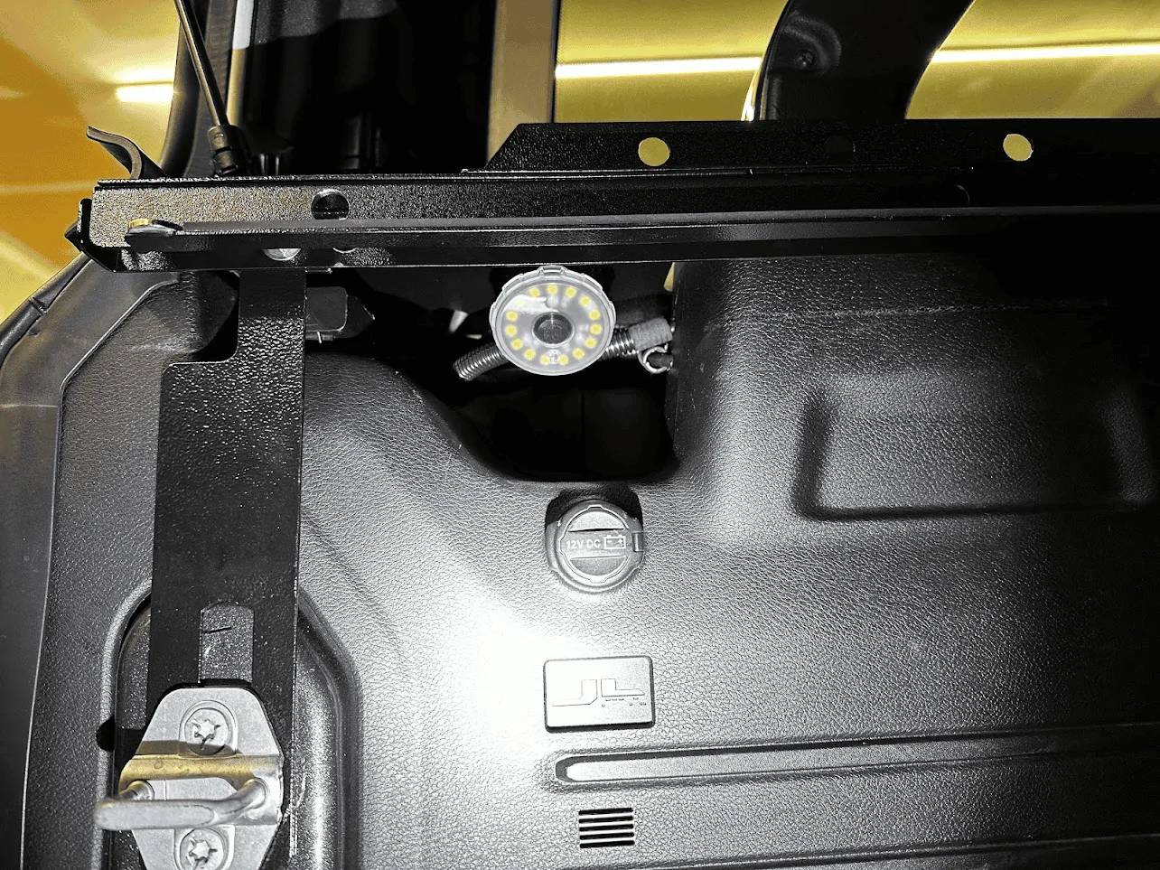

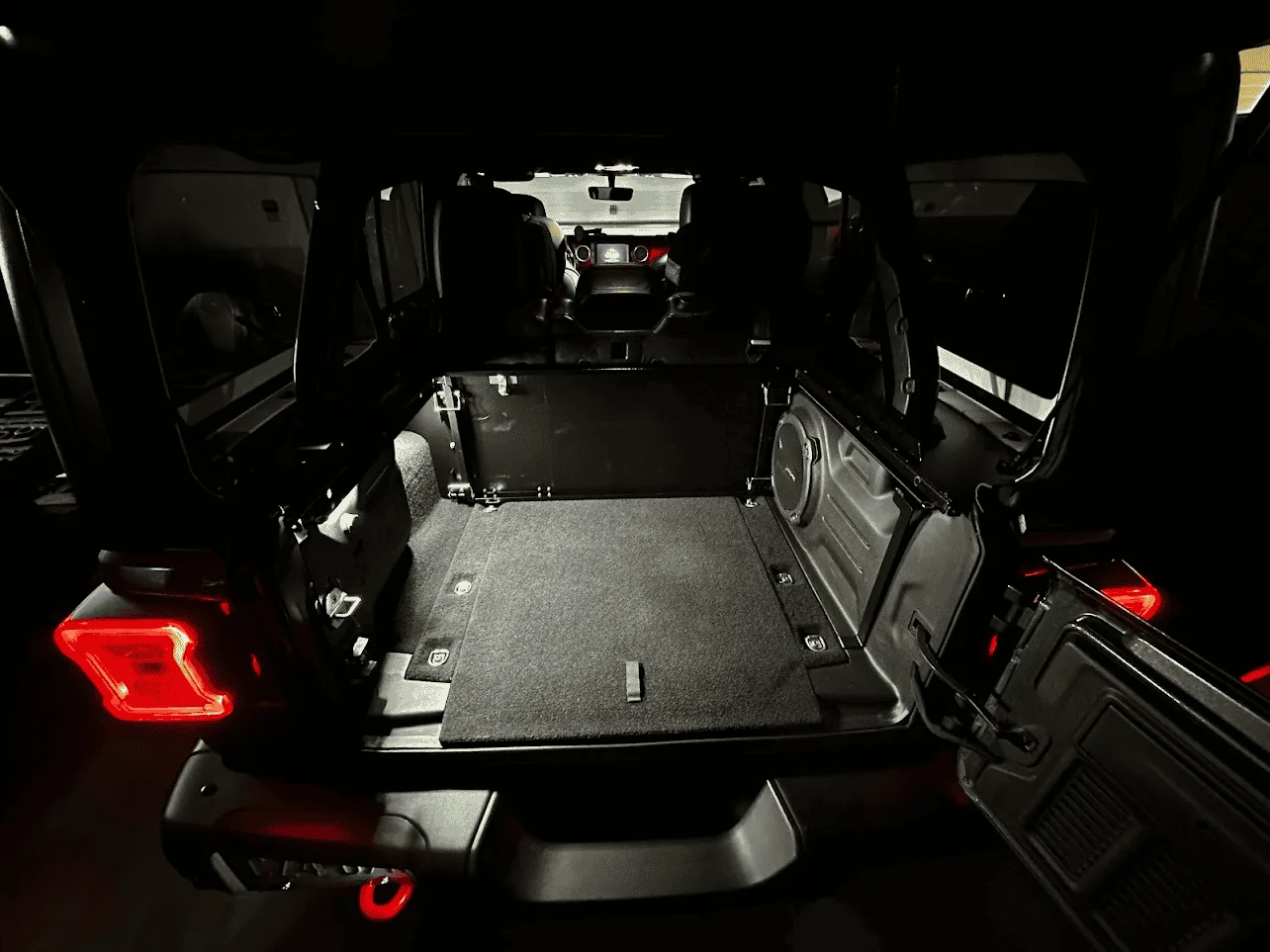

UPDATE - went with 2 KC Cyclone lights as the Brawlee light was too long for the setup I wanted. May go with the Brawlee on the rear window down the road. I ordered directly from KC, they offer a 2 light kit with wiring. Went with the diffused lenses as I don't need it to be crazy bright. I tapped them into the rear dome light and ran them down the driver side C pillar (thanks again @Terrymo for the install instructions - made it a breeze). I have the Diabolical Slipstream rear security system, so the lid is removable while the frame stays mounted. I bolted the 2 lights onto the driver side frame and taped magnets to the wire loom to keep them tucked up and away. This also kept the drill holes down to just the mounting brackets in case I go with a different setup in the future. I ran the wires long by the lights in case I want to move them. All mounting hardware is stainless steel for when I run no top, in case I get caught in rain.
Overall, I'm super happy with the outcome - appreciate everyone's input. Now I can see at night when I'm using the rear cargo area and the lid is on. Here are pics of the setup:
