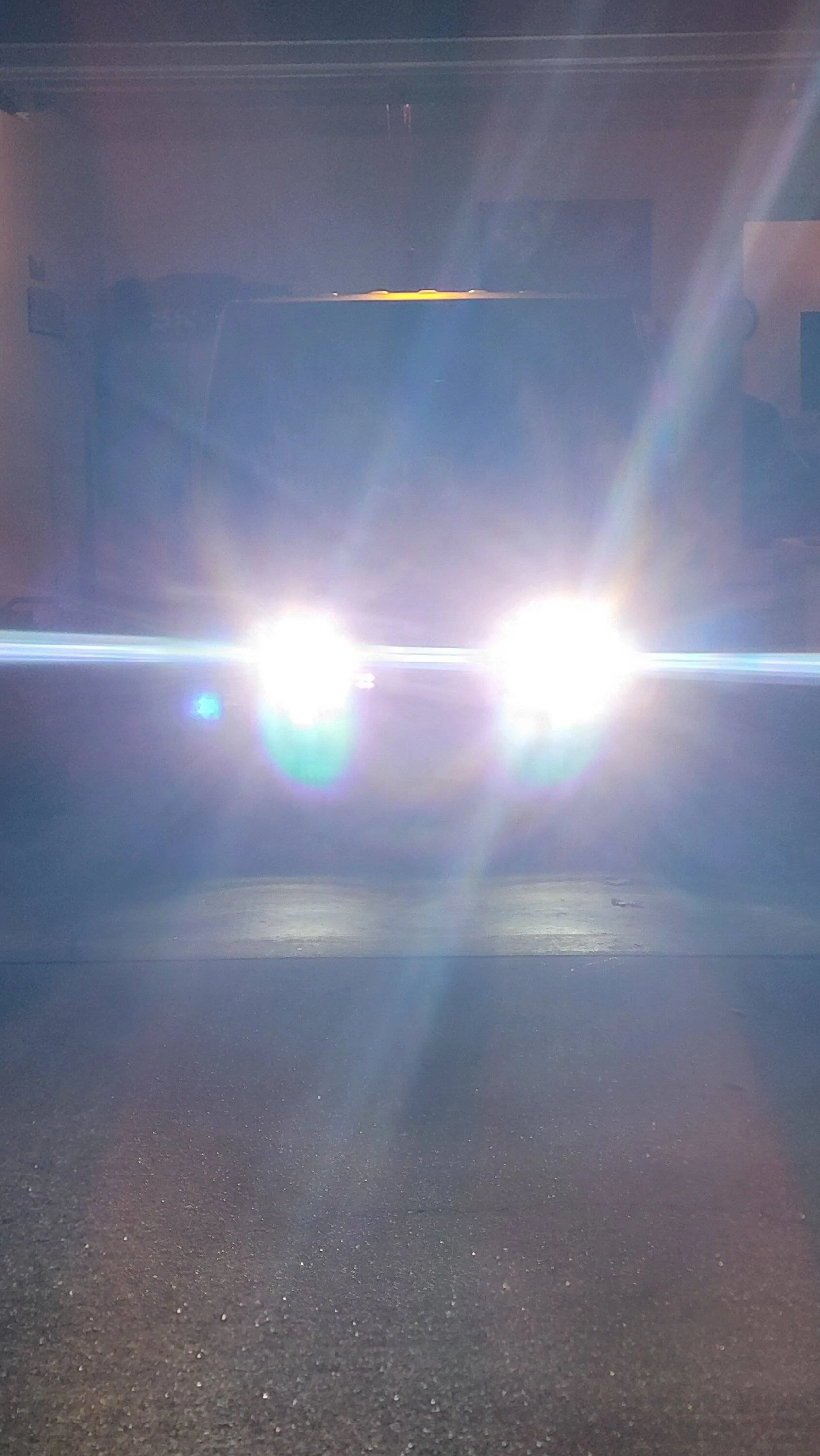

These spot lights are intense and I may switch them out the diffused lens version. These lights will absolutely blind you while looking at the back of my Jeep. All you will see are the two spot lights.

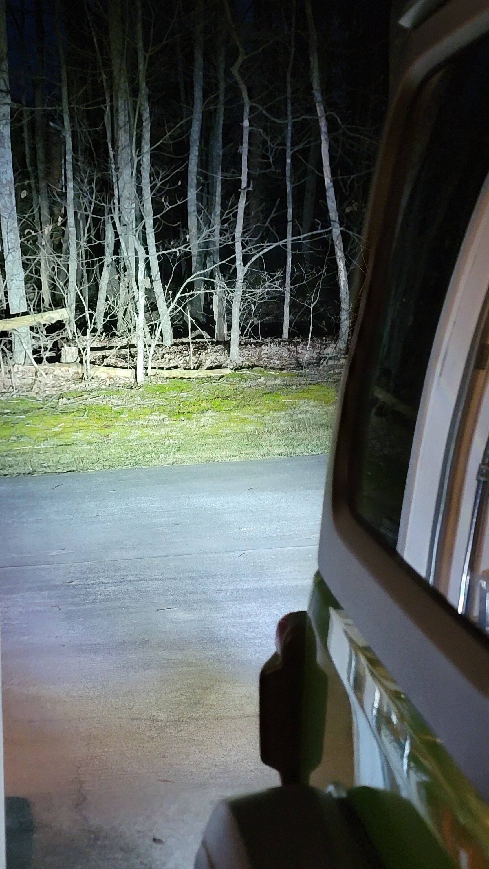

I'm mostly happy with my upgrade. I can see everything behind me while backing and the image in the backup camera is much more useful at night now. Unfortunately it's not good for people if they are walking by back there when I put it in reverse.
