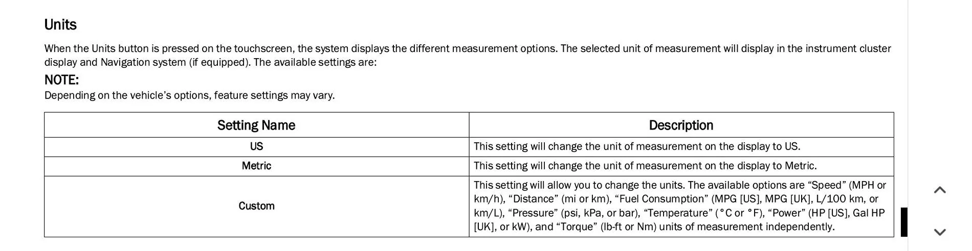

Not sure if this is what you’re looking for regarding temp settings
Jeep Wrangler JL Radio reverted to celcius IMG_1713

Yeah found this in my owners manual, the Units setting isn't there in my Settings in the radio, all the other ones are (Languge, Display etc).

After a couple hours went to check on the Jeep and all the apps are back and my units are back to US measurements. Haven't driven it, will check later today, but I'm willing to bet the backup camera is back to. From poking around forums I guess the uConnect takes time to relearn your Jeep when it loses power. Now hopefully the 1 second static sound in the speakers is gone as well. From looking aorund some suggested resetting/rebooting the radio (hold power/volume and tuning/skeep button in for 10 seconds). I'll give that a shot, anyone knows if this kicks off another required discovery for the radio losing all those features again?
