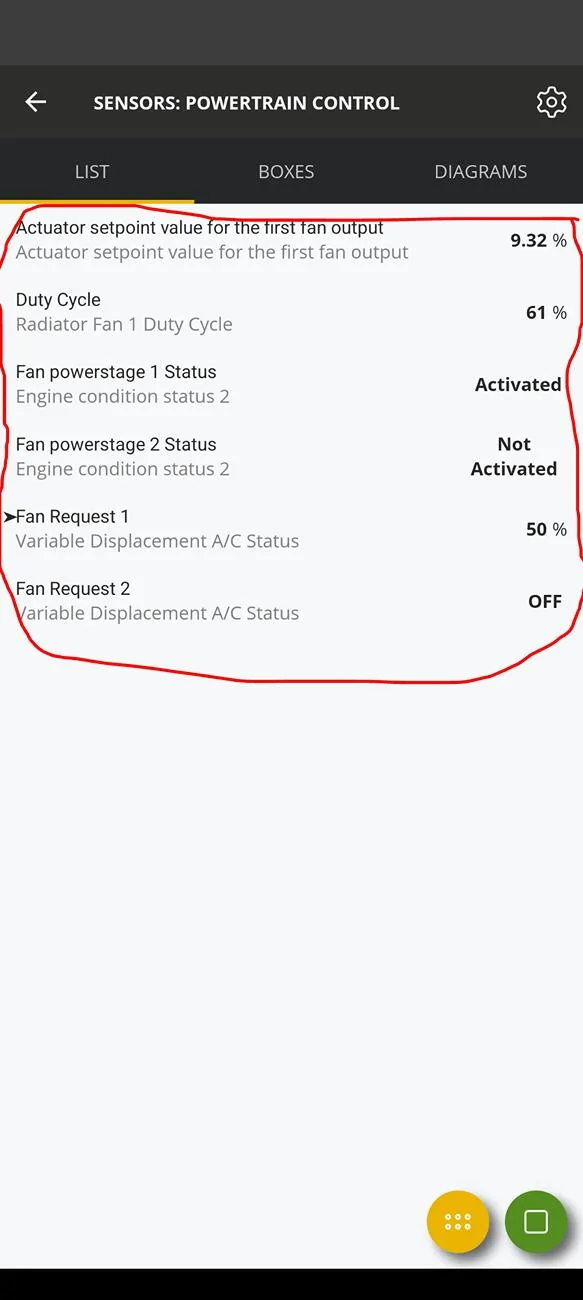

2. Got the car back one week later to find the radiator fan ALWAYS ON. So always on means exactly that, independently if AC is on or off, hot or cold outside...once I start the engine in the morning it starts spooling up.

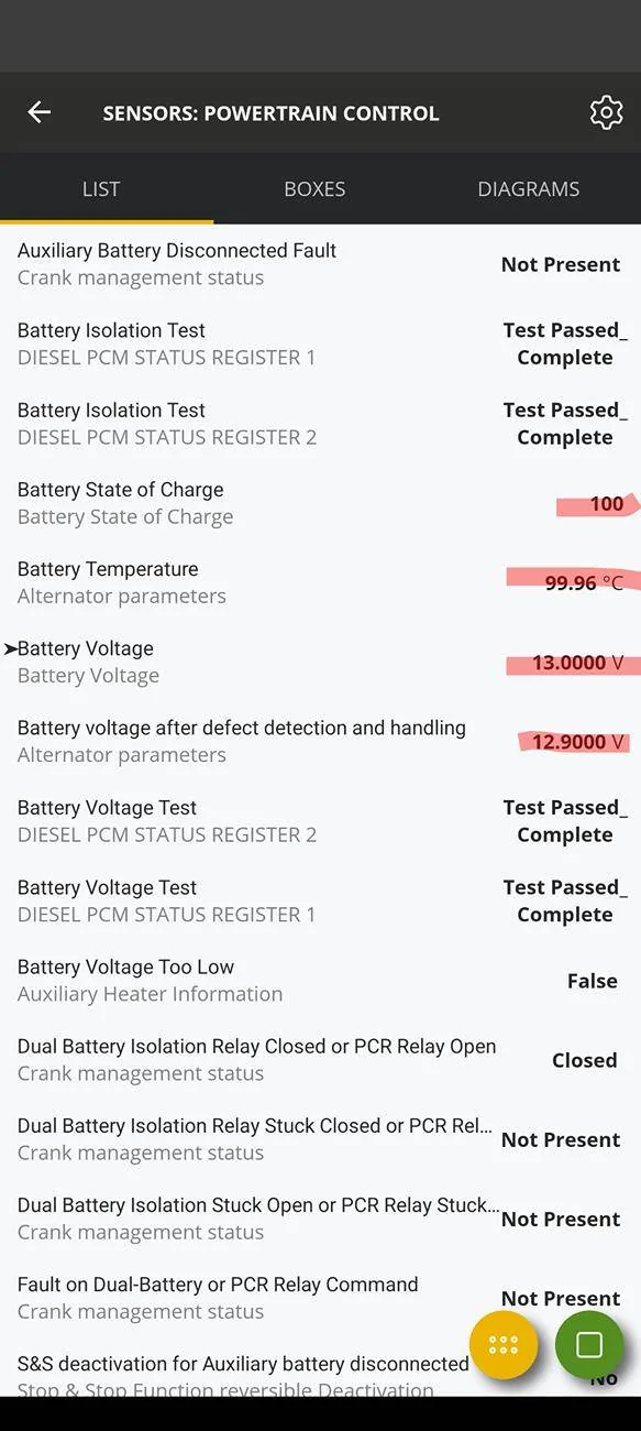

3. Recharged both batteries - they don't seem to be bad, at least according to JSCan Live Data readings. Couldn't get a multimeter to them yet though...

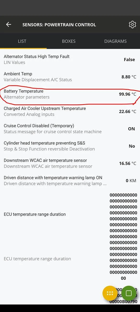

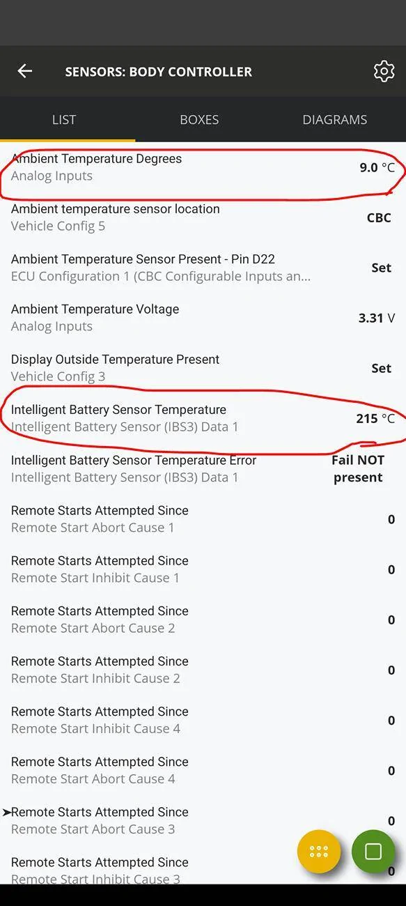

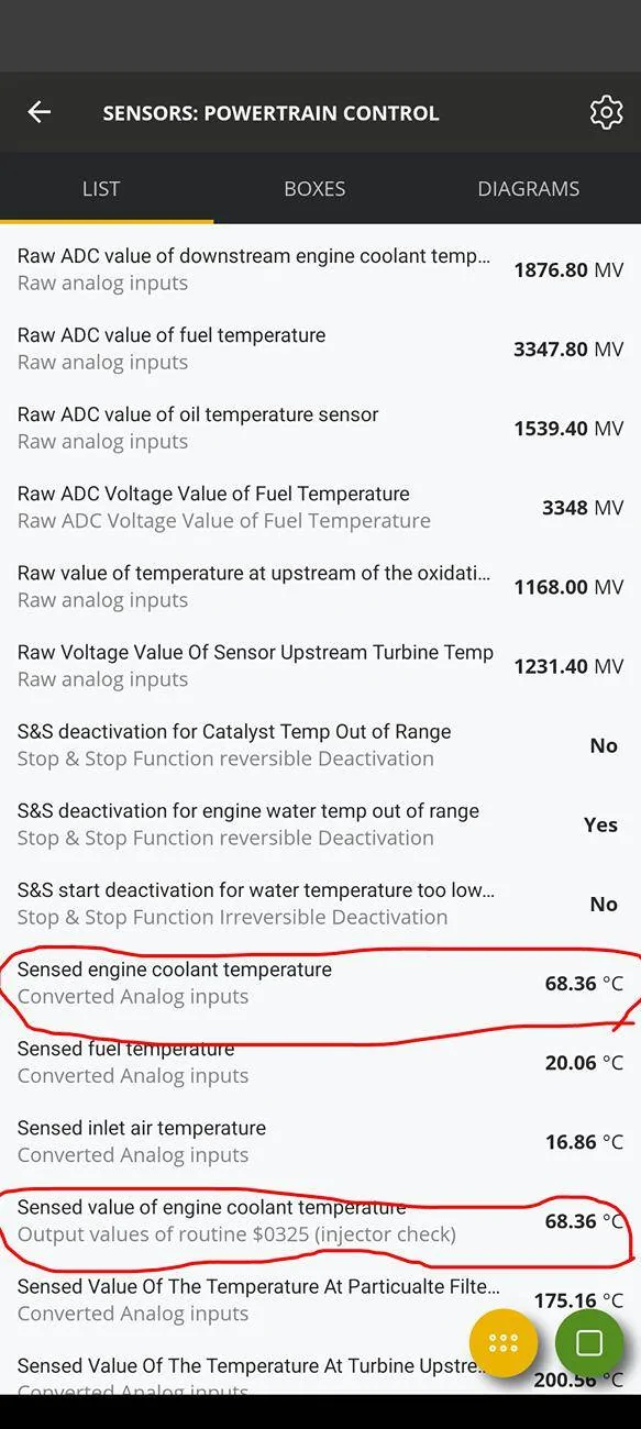

I attach the PCM and BCM live data for temperatures and voltages.
The only thing suspicious I see is the IBS - which seems fried, and thus I get the corresponding DTC + the default battery temperature value.

#P0480
cooling fan 1 control
active
=> This is obvious...PCM requests fan ON, but why?! Which criteria/surveillance sets this DTC? Can't find this information....

#U113E-00
lost communication with intelligent battery sensor ""a""-
lost communication with intelligent battery sensor-
active

battery temperature sensor circuit low-
active
=> Network comm issue, bad sensor or network
