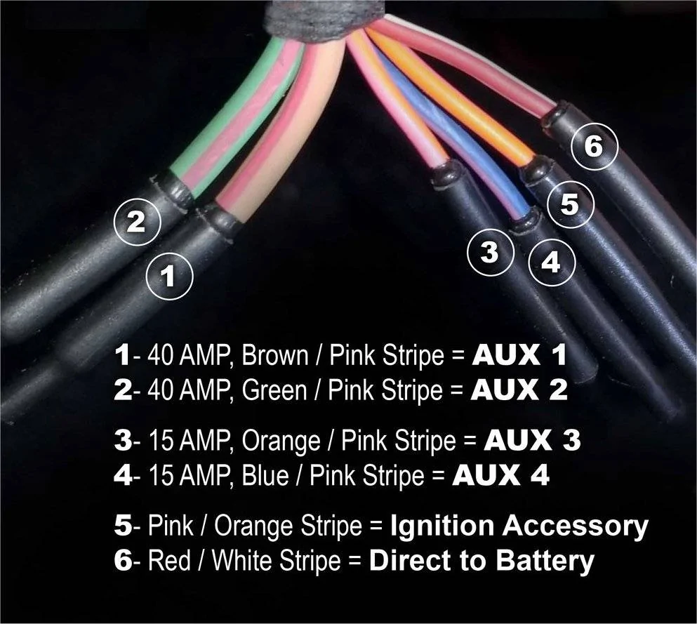

use wire #5 if you want it on - off with the ignition.
use wire #6 if you want it live all the time.

Consider wiring with the camera using the "Direct to Battery" wire (it's 10 amp fuse protected) in the front passenger side Aux bundle. Do that and also add an on/off switch to the mix, so you have the control your desire.
Using the direct to battery wire... no hiccups, no Aux unavailable issue.
