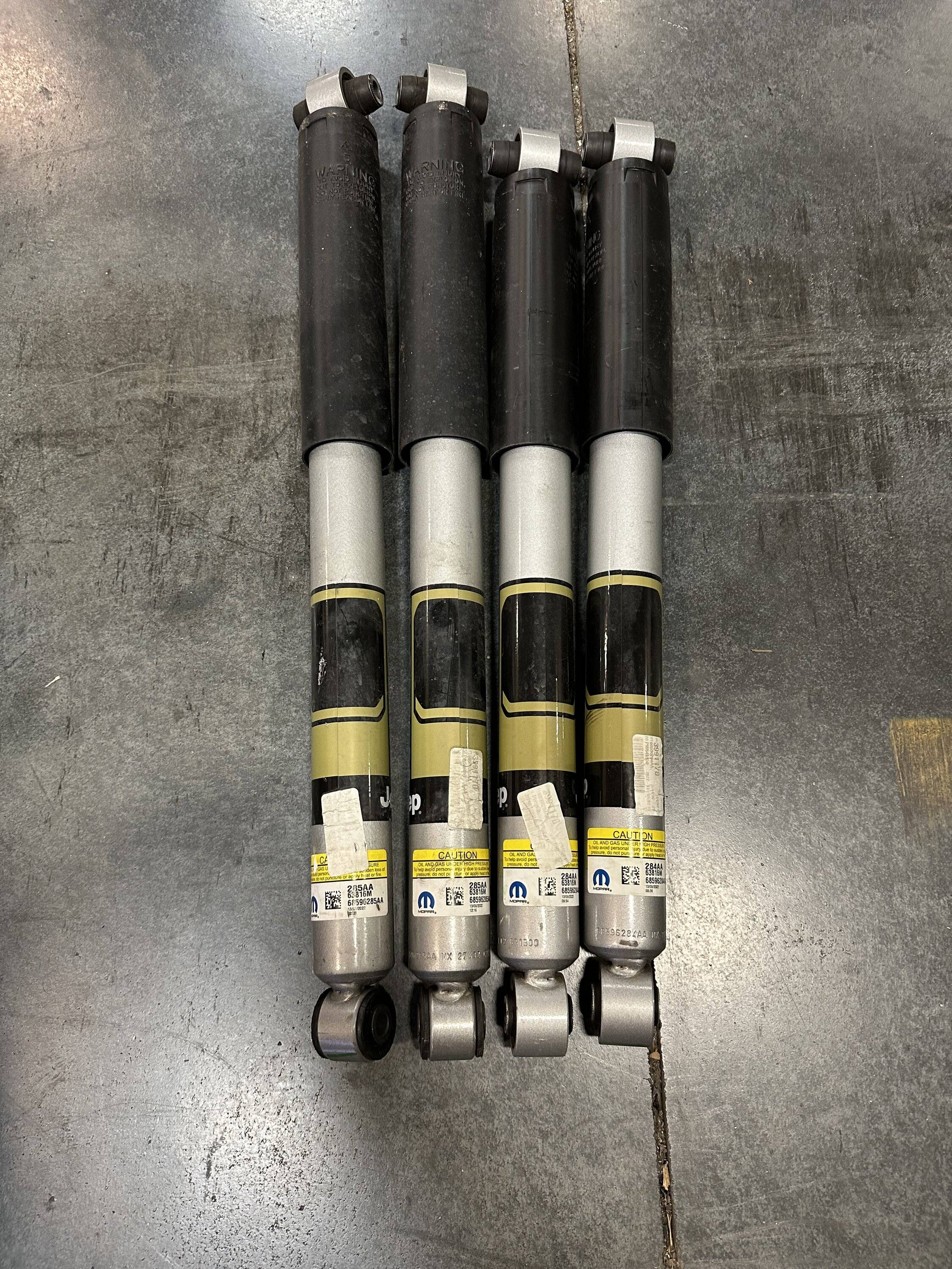

Thanks! Mine are not Fox shocks, the XR shocks are Mopar branded. Pics found from member who sold them:
Jeep Wrangler JL Questions for shocks/springs experts IMG_7072
Jeep Wrangler JL Questions for shocks/springs experts IMG_7071

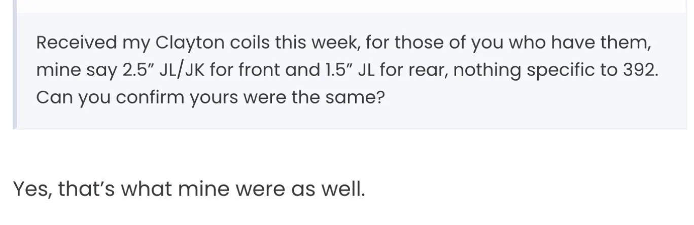

I think I can confirm the springs by referring some other members observations:
Jeep Wrangler JL Questions for shocks/springs experts IMG_7075
