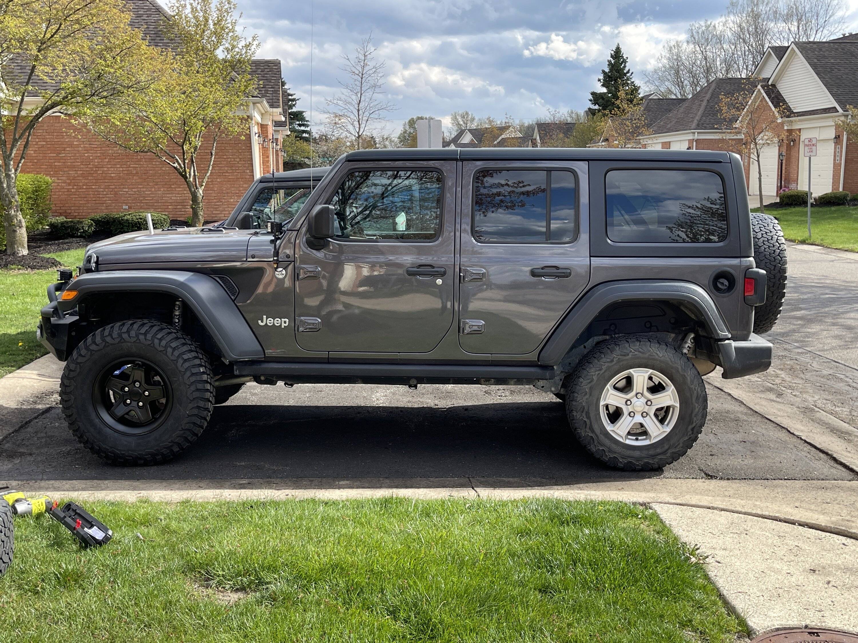

My sport S with a sagged front suspension from carrying a steel bumper and winch actually gained nearly 5” with the Mopar. It’s not complete though, and you’ll still need track bars and lower control arms. I like the springs, I like the shocks, but it’s not a “total” kit. When I got mine they were about $1300. So I was paying $1000 for the shocks, and $300 for springs.
As far as it looking odd, it did. I had 285’s too (rear) and they just looked small. 35x12.50’s (front) brought the proportions back. This pic was during my tire/ wheel swap after a couple years with the lift on and settled down to about 4” over the starting point.
