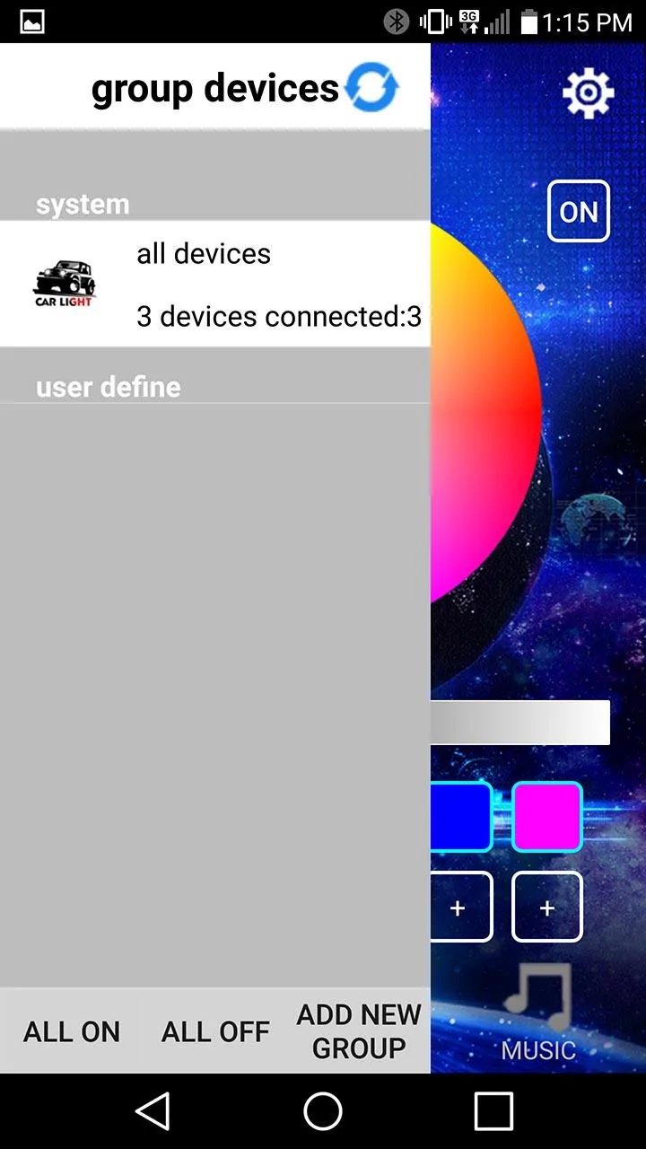

Here's a write up on how to manage multiple controllers.
Access the device menu by pressing button at the upper left.
Jeep Wrangler JL Quake RGB Halo effects using two controllers dev menu button 2
This brings up the group devices page that shows the detected devices and any user defined groups. If you tap the top of the menu, it will re-scan fro devices.

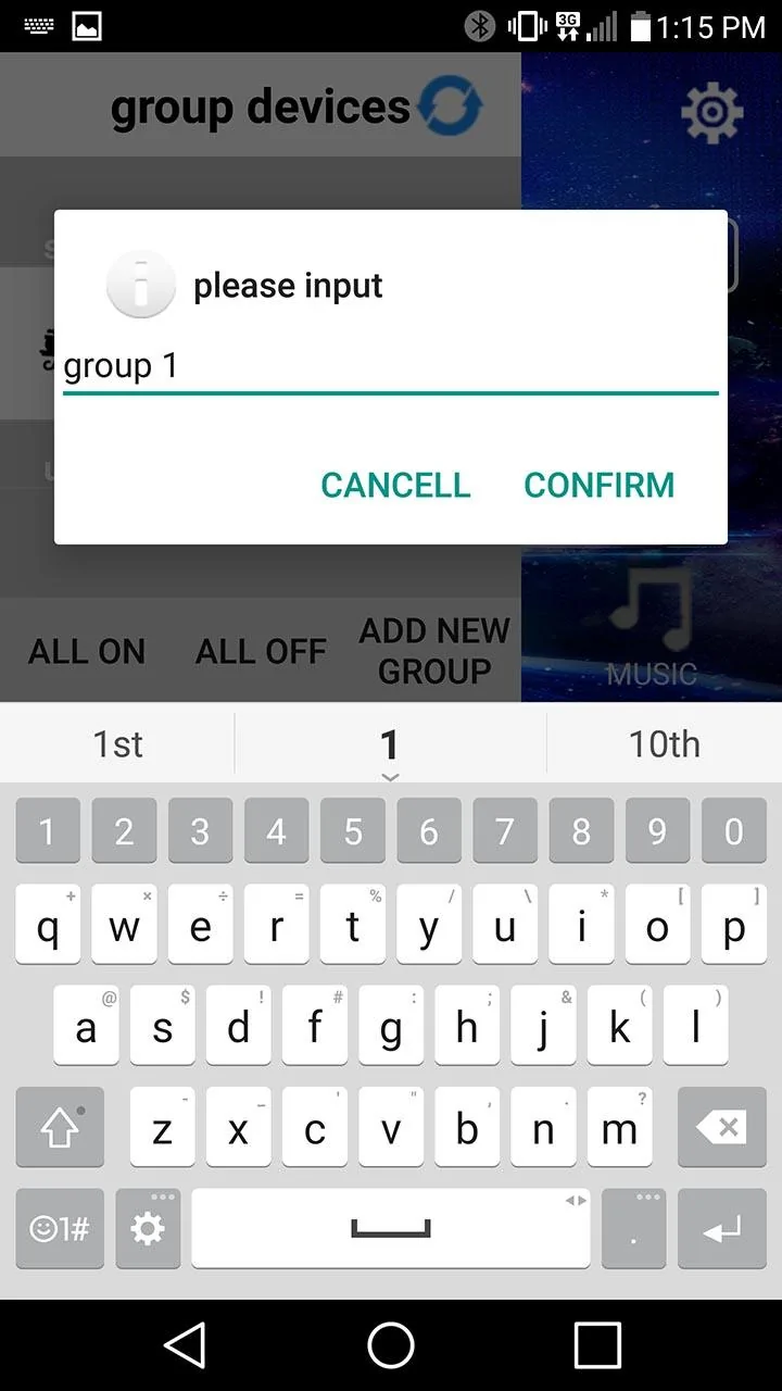

Click on ADD NEW GROUP to add a group and enter a name.
Jeep Wrangler JL Quake RGB Halo effects using two controllers group naming 2

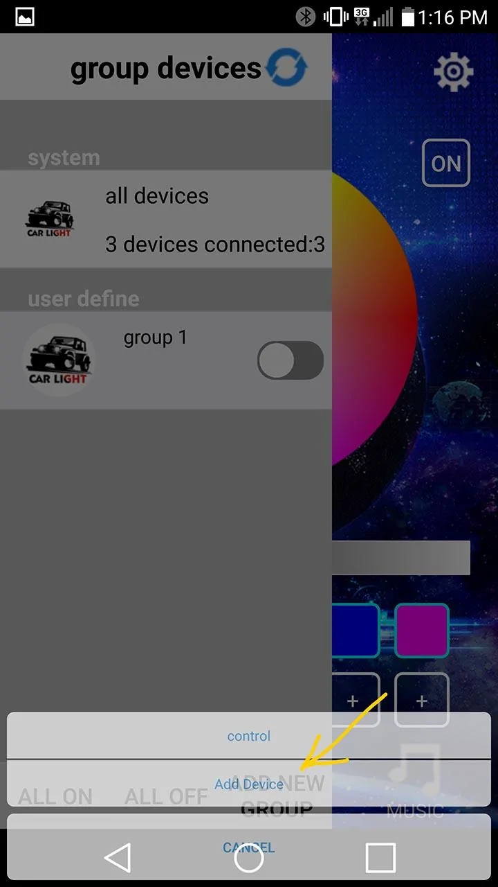

The new group will be added to the menu, tap on the new group to add devices.
Jeep Wrangler JL Quake RGB Halo effects using two controllers select add a device 2

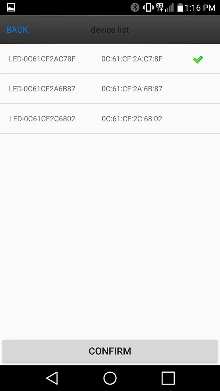

Select the device(s) to add to the group.
Jeep Wrangler JL Quake RGB Halo effects using two controllers adding devices 2

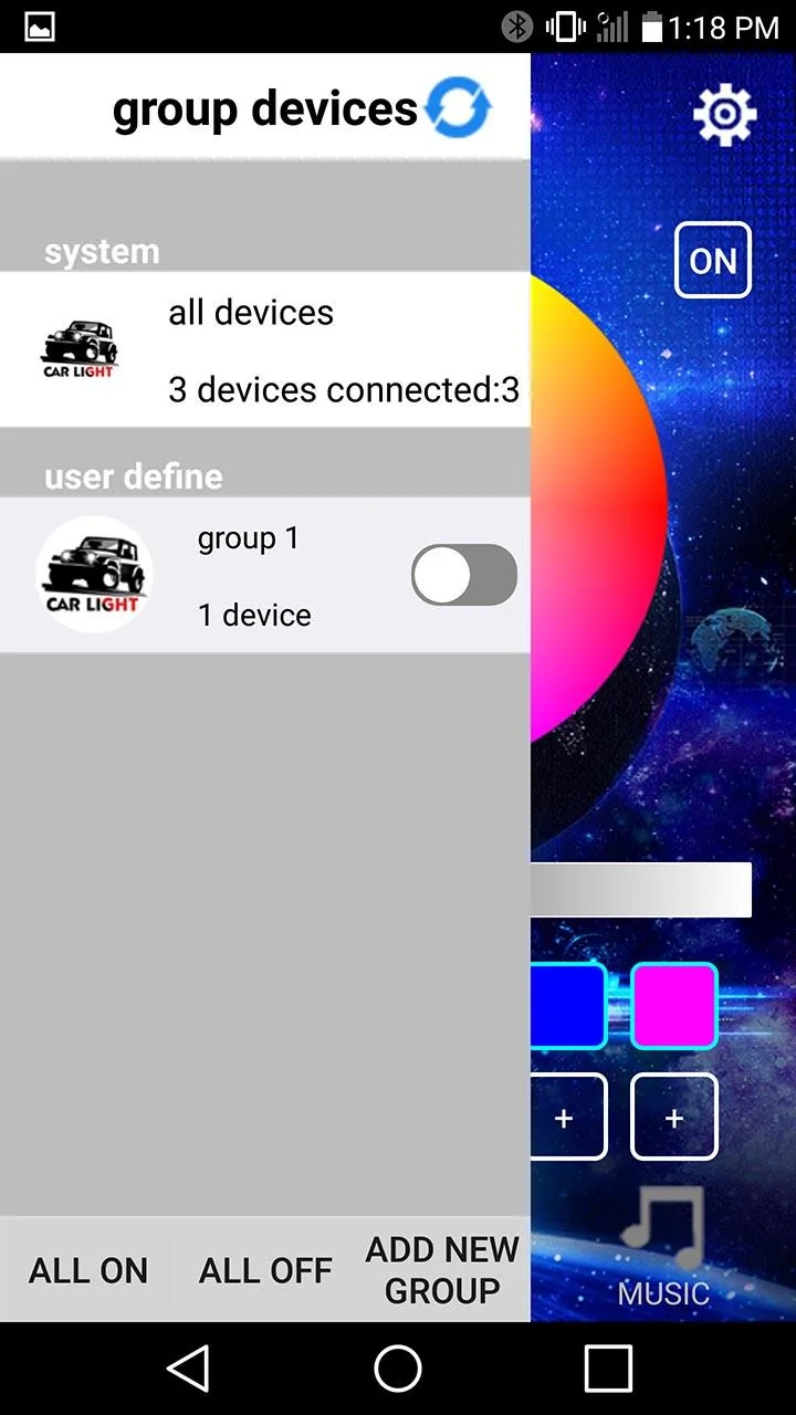

Here's the group with the device added.
Jeep Wrangler JL Quake RGB Halo effects using two controllers group added 2

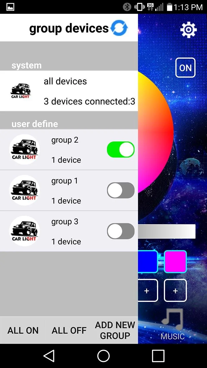

Once the groups are setup, you select a group to change it's current effect. Once an effect is set, it will stay in effect until it is changed through the app.
Jeep Wrangler JL Quake RGB Halo effects using two controllers gropu selected 2
