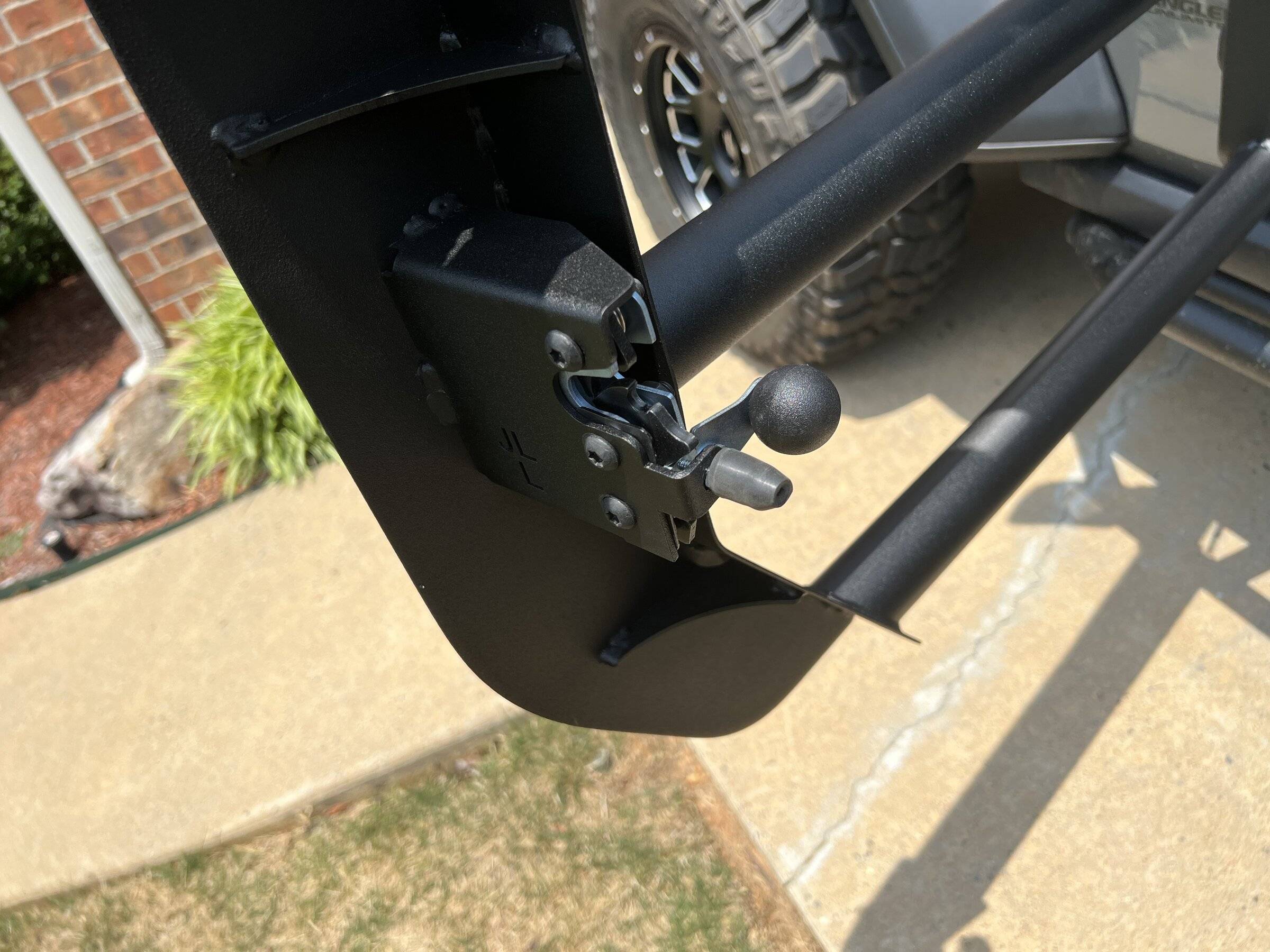

I sent an email to customer service about a lower front passenger hinge that will not accept the door bolt, have not heard back yet. I was able to hammer the doors in with a rubber mallet and create my owe stopper using parts from lowes, see pic below. If I can get the hinge worked out, I’m happy with them.

Used hammer on hinges and made my own stop since they were too short after all adjustments. Hopefully customer service will respond to my email about the threads on the lower front passenger door pin not accepting the factory bolt.
