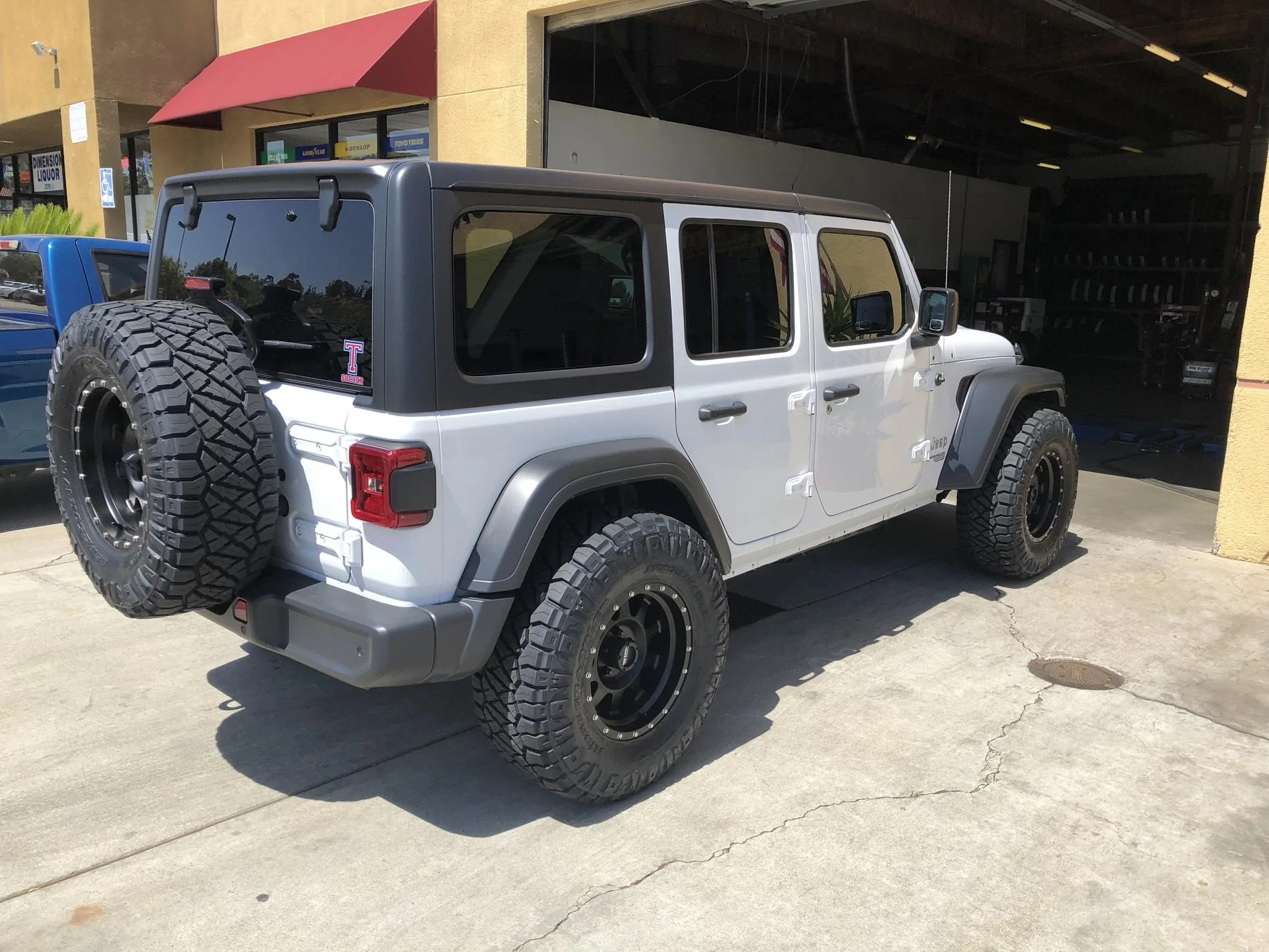

With some new rims and tires on the menu (that she picked by the way)
35x12.5 Nitto Trail grapplers, 17x9 method racing Standards MR301 matte black
Jeep Wrangler JL Project Jilly’s  white JLU 9_A534_DAB_B45_E_4_C8_C_8_C5_C_D77572462_E7_A

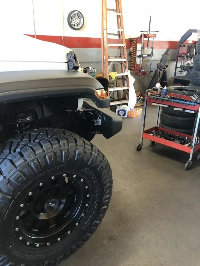

We Had to remove the front air dams between front bumper and fender for clearance
Jeep Wrangler JL Project Jilly’s  white JLU CC01_BBCE_9944_4_D50_B6_D8_525137_E52_B7_A

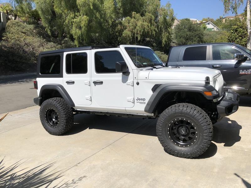

Sorry it Took so long to update... I have been traveling :(

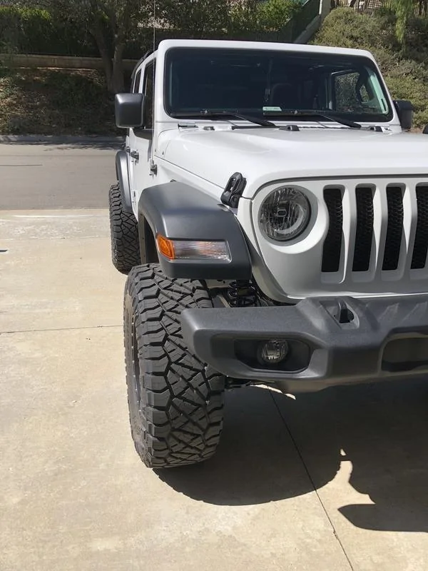

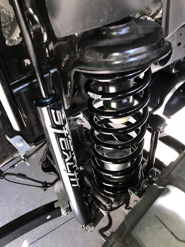

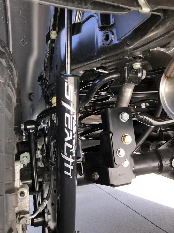

The Jeep is back form Fabtech Motorsports
Installed a 3" Sport system w/ Stealth Shocks
Here is a Link to the kit
https://fabtechmotorsports.com/product/3-sport-system-w-stealth-shocks-k4107m/
Updated Pics
Jeep Wrangler JL Project Jilly’s  white JLU IMG_1287_zpsmykssck
Jeep Wrangler JL Project Jilly’s  white JLU IMG_1285_zpsxjtcgqrz
Jeep Wrangler JL Project Jilly’s  white JLU IMG_1284_zpst5w5cwyy
Jeep Wrangler JL Project Jilly’s  white JLU IMG_1286_zpspbubghor
Front
Jeep Wrangler JL Project Jilly’s  white JLU IMG_1288_zpsm1ggeq3t
Rear
Jeep Wrangler JL Project Jilly’s  white JLU IMG_1289_zpst6fujtaz

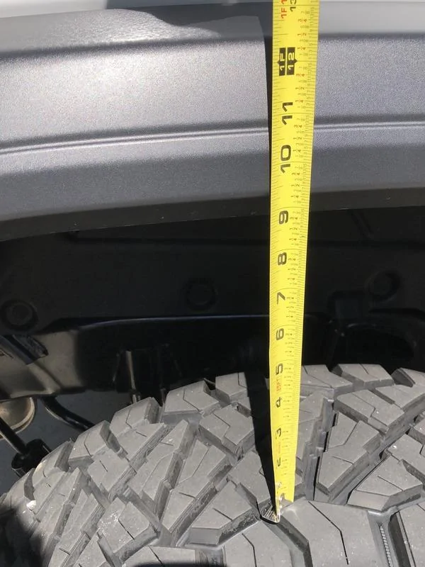

Front Wheel Well
Jeep Wrangler JL Project Jilly’s  white JLU IMG_1291_zpstxpia2o

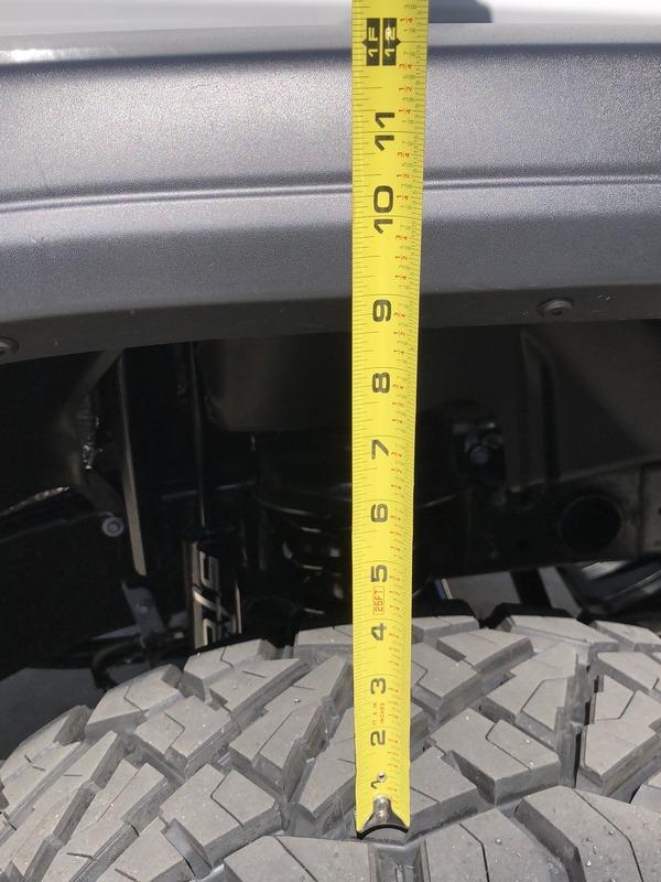

Rear Wheel Well Space
Jeep Wrangler JL Project Jilly’s  white JLU IMG_1292_zps6yiwv0qj
Rear door side
Jeep Wrangler JL Project Jilly’s  white JLU IMG_1293_zpsgbyphtud
Rear towards Rear
Jeep Wrangler JL Project Jilly’s  white JLU IMG_1294_zpsepbb7ym
The drive home, the ride was fantastic just a little stiffer than the stock ride.
As a reference The door sill is now 28" off the ground. Next is the Slider rails with integrated steps for the wife
One happy Kid! and maybe a dad too :)

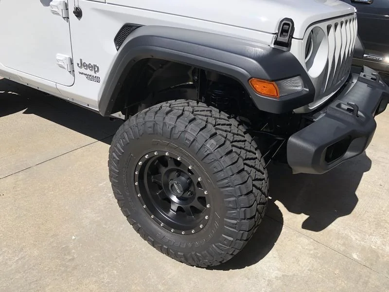

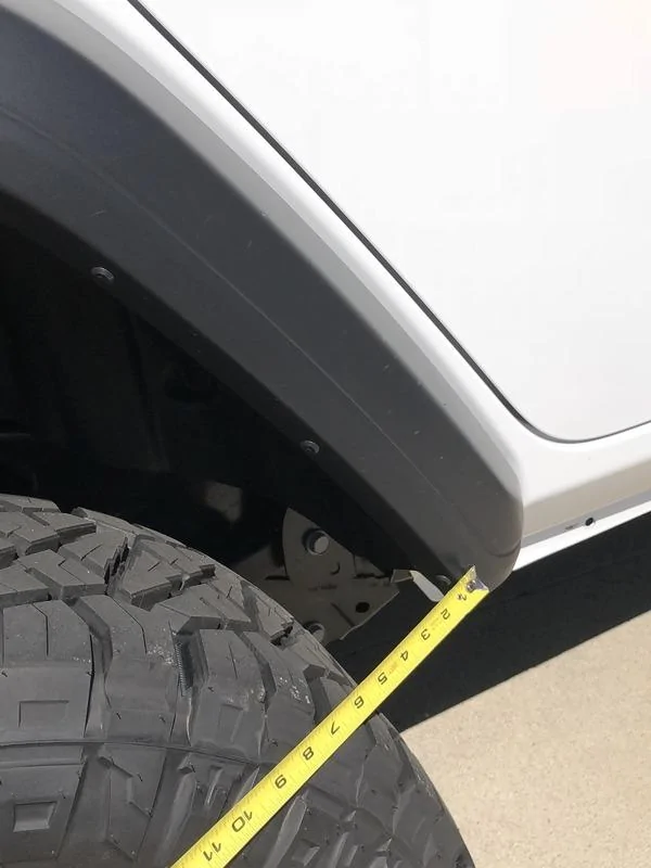

Service
Are you able to get full turn out of those tires without wheel spacers without rubbing? I'm not sure of the backspacing/offset of those wheels but they are thick.
Jdegid
Jdegid
Feb 16, 2018
51
135
Orange County CA
2018 wrangler JL unlimited
Yes, No rubbing at all, I do not have wheel Spacers. Rims are 17" Method Racing Standard MR301 with 4.5" Back Spacing
I did remove the front bumper Euro Air Dams between the bumper and the fender They would have rubbed those pieces.
