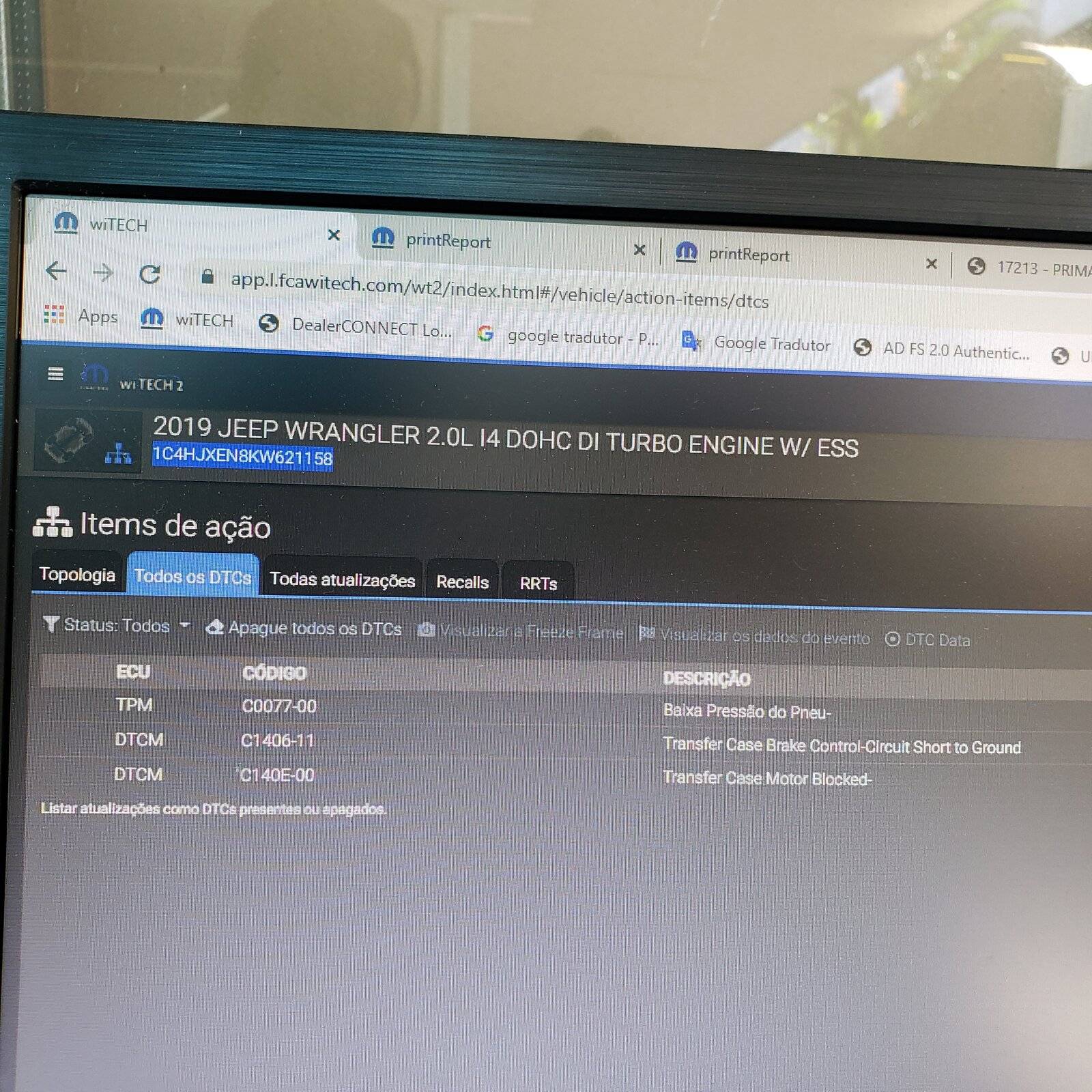

Attachment, forwards photo of the dealer's scanner record. This problem presents itself intermittently. What could be another factor as a cause of the problem?

In the Wrangler JLU 2019, does the 4WD system have a specific module and harness with ends only attached to that module up to the small motor next to the transfer box? The cause of the problem has not yet been discovered.

Good Morning. Can anyone tell me how many leads are connected to the same harness that is connected to the small motor located next to the transfer box? And these leads are terminals that connect and feed what? Or at least have a manufacturer's address that I can ask this technical question? This Jeep Wrangler Sahara model is imported from the USA and here in Brazil the dealerships do not have this information.
