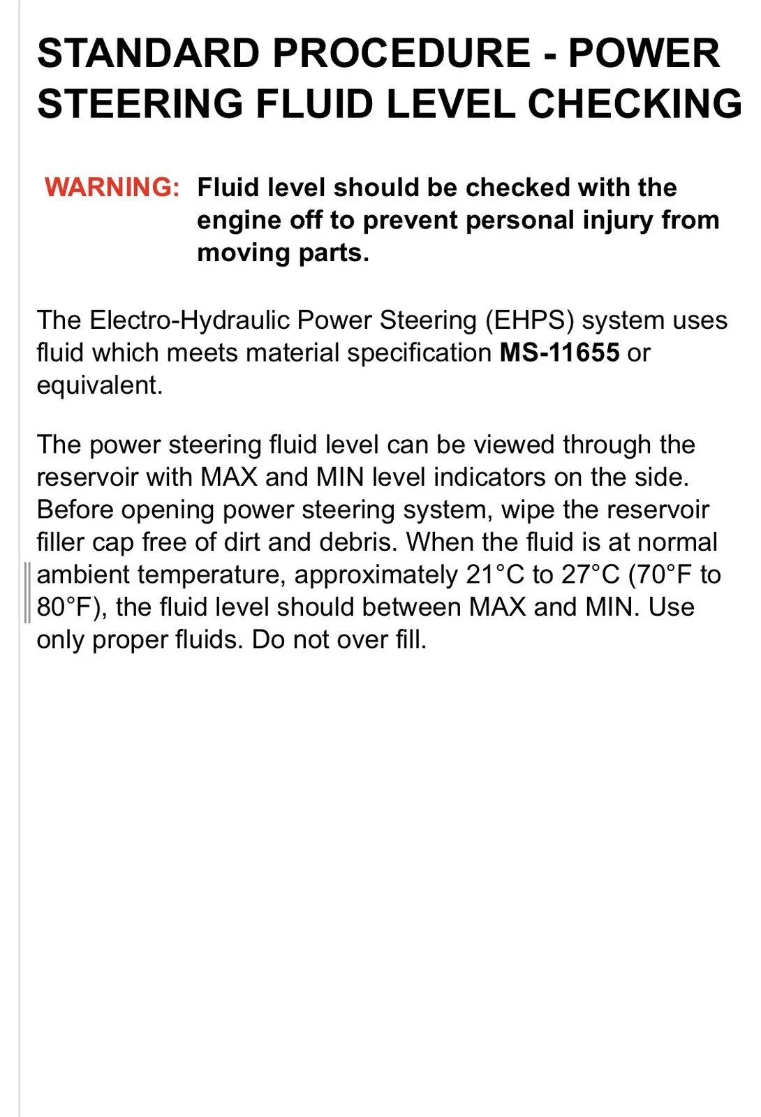

Jeep Wrangler JL Power steering fluid IMG_0660
The electric power steering requires a special type hydraulic fluid. Do not use ATF! Ust the Mopar fluid or the Pentosin.
