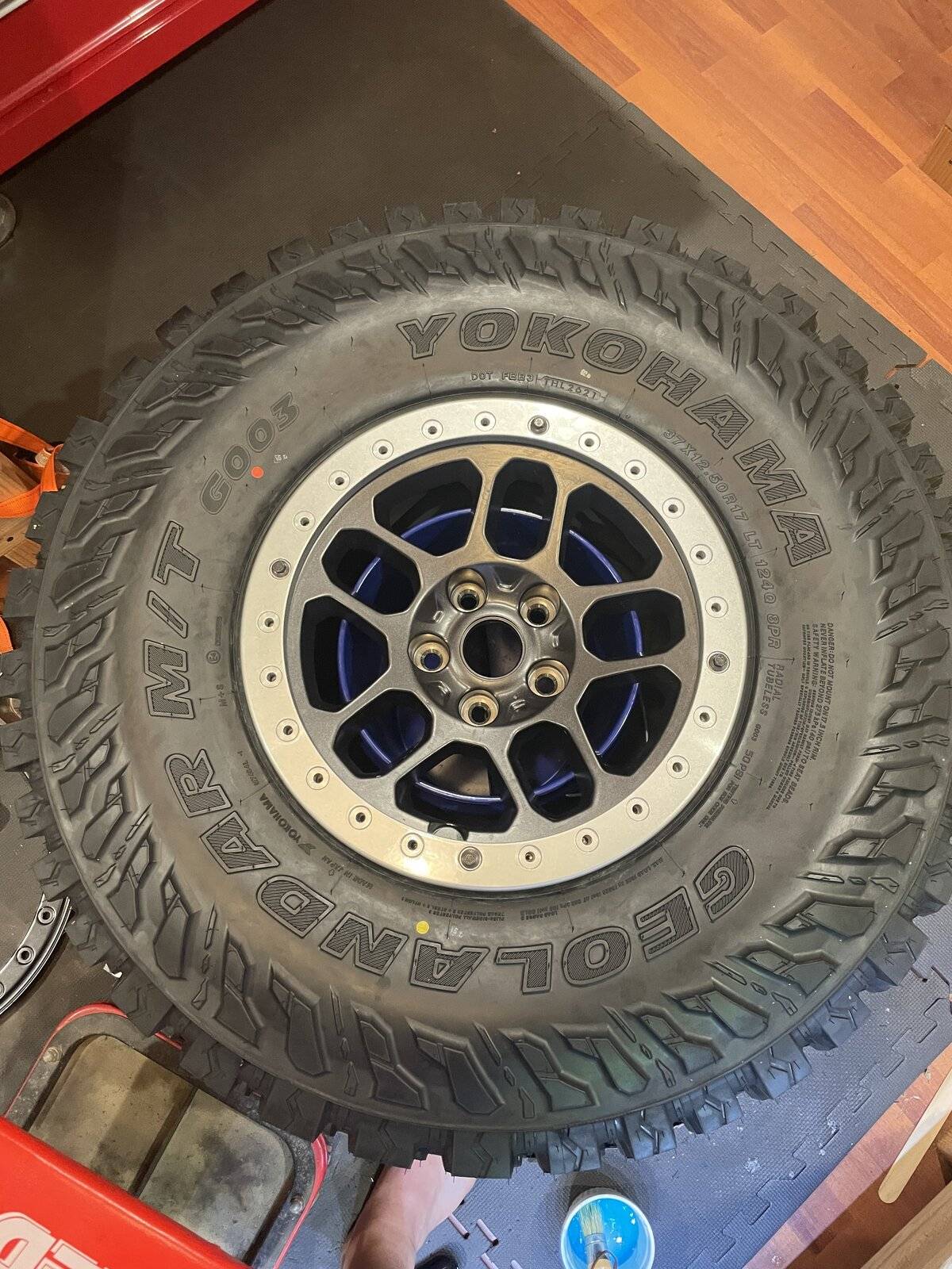

Does his method help at all?
Setting it up as a beadlock. Bead is outside the “rim”. Trying to get it to sit flat on the external “bead” of the wheel is the tricky part. You have to stretch the bead of the tire over the wheel. It’s a pain in the dick. It feels like the tire is too small for the wheel. (I know this isn’t the case but it’s the best way to describe it) when you try to spoon it on eventually the other side just pops off. It seems like you need to pin down the bead in 5-6 places as you work your way around the tire. I just don’t have enough hands to do it.

@Jeepeto - Sorry I haven’t chimed in on this yet, I’ve built at least 50 or 60 headlocks in the past.
Put the wheel on a 5 gallon bucket with a blanket on it. This way the tire sags down and is a lot less likely to pop off one side when getting the opposite side on. With it sitting on the ground the tire wants to pop up.

Not positive but looks like he has it on a bucket 🤷‍♂️
Well damn, my bad, I didn’t look close enough. I haven’t had them fight me that bad before but then again 95% of the ones I have done have been BFG’s so maybe the Yokohama bead is different.
See… I was wondering if the lube might have been hurting me. I kept seeing stuff saying to use a bunch. But I eventually tried to wipe most of it off because I started feeling like it was helping the other side of the bead pop up more than it was helping me pry the bead on. That makes it look WAY easier than my wheel tire combo though. My setup needs to stretch to fit. I’ll see if leaving it to dry out over night helps any
Wes
It’s on a bucket. I’ll try again tomorrow and report back
I’ve never tried but it does not look fun LOL

@joegrasse @wesjtx
Well. Wiped everything down and tried it dry. It’s still a pain in the butt, but I was able to get it mounted. Thanks for the help guys! I’ve got it pinned down with 4 bolts for tonight, I’ll finish the ring in the morning and see what the clearance looks like with factory “lift”, and what the tailgate carrier looks like with 37x12.5
Thanks again guys!
