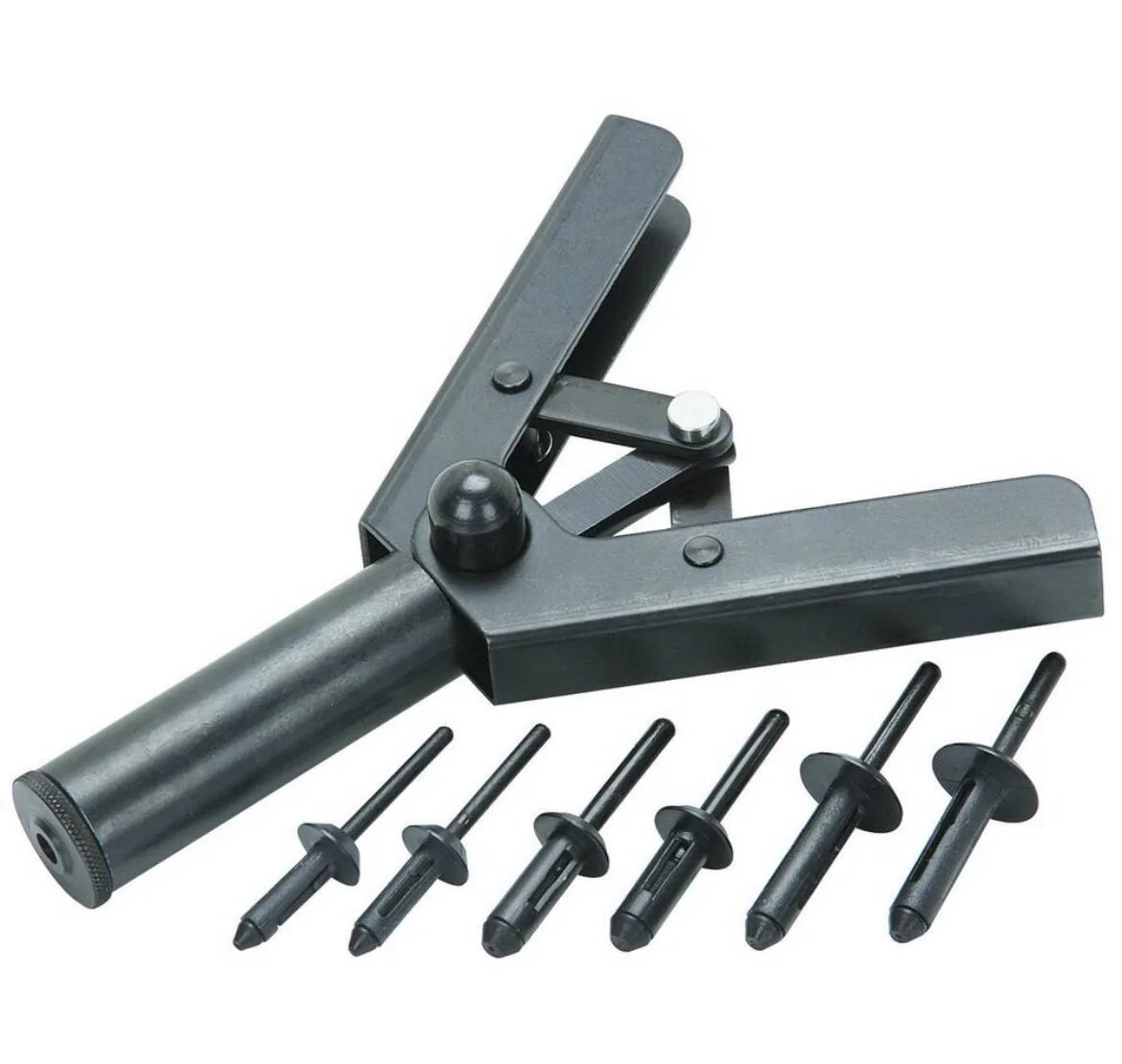

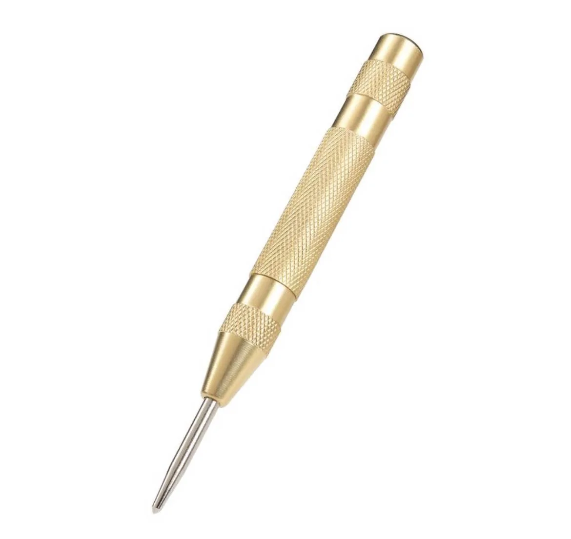

How do you remove those rivets? Are you planning on removing it?
Either mentioned above use a small punch or a small drill bit in the center. I’ve done both. Just get a plastic rivet tool and rivets and reinstall after removing extended lip. 👍🏻
Yep, automatic center punch worked fine on my last JL. Just knock that center pin back a few times and the rivet releases. You will want a trim tool or something to grab the head of the rivet and just pull it out. Then get a plastic rivet tool and some plastic rivets to replace the holes when the fender flair is removed.
