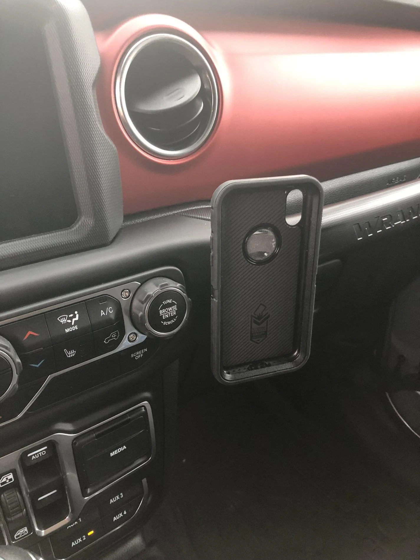

So I wasn't sure what to do with the phone . I use a Otter box case on the phone. I use the Quad Lock adaptor on the phone. I use it for my bicycles also. I got the adaptor and this was about the only place I could find to mount the adaptor. Works perfect! Just need a short cable for the phone to the USB . Anyhow just what worked for me is anyone was looking for suggestions!
I had mine mounted that way, but one day I sat in the passenger seat and noticed that the weight of the phone seemed to be pulling the plastic away from the dash. I have since removed it, but now I have a slight gap between the dash plastic and the grab handle. :headbang:

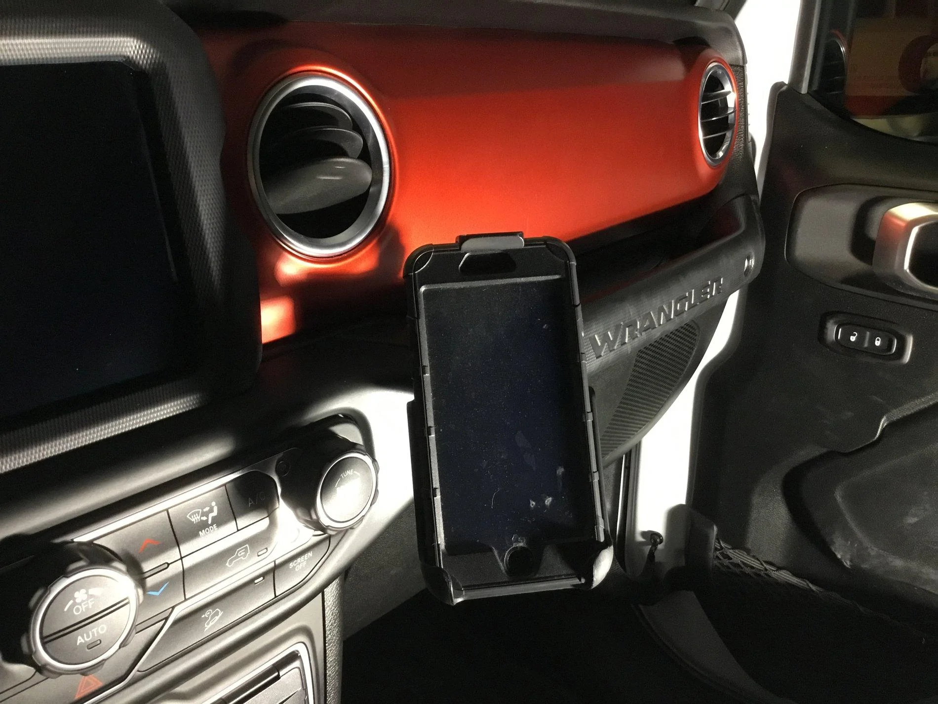

If anyone is interested Ram mounting parts
I like that a lot! I had one of those on my motorcycles I just sold. I wish I had pulled the RAM & Mount off before I sold it.

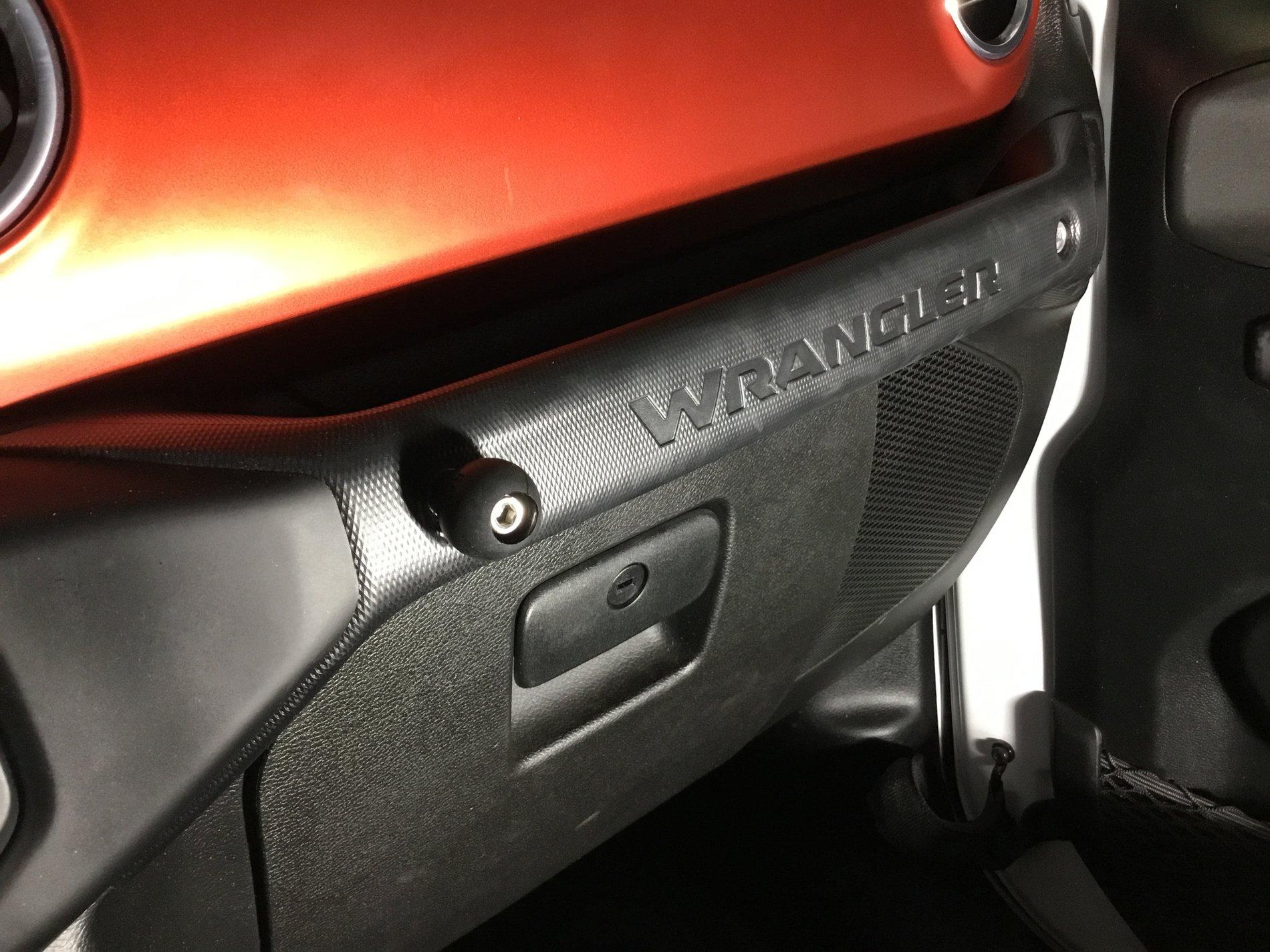

For the ball mount, how did you screw that into that location? The screw there is only into the rubber and is very short. Thanks

Hi don,
I drilled out the existing hole just a bit and threaded in the cap screw into the hole. The rubber is tough and holds very well. Don't drill it to big!

Thanks, so you used the same screw and did the ball have a short aluminum post on it as well?

I did not use the existing screw. It's very short and small. I used one of the cap screws that the ball came with in the handlebar kit. If u purchased just the ball, you need to find a approate cap screw in size and length. Todd

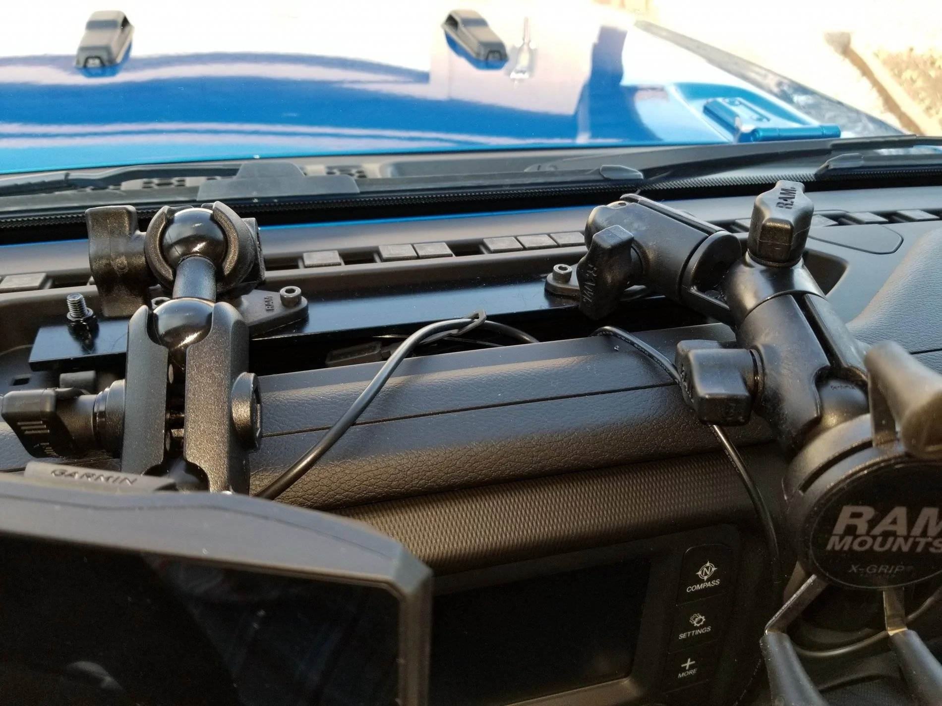

I used the RAM phone mount.

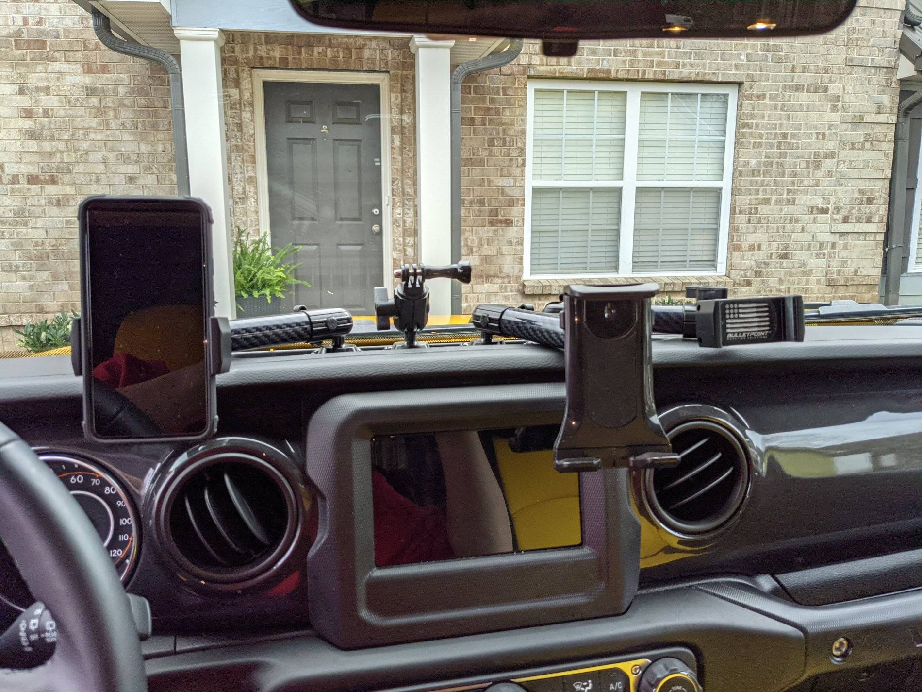

I went with the Rubigrid by Bulletpoint. This gives me two phone mounts, myself and my wife, as well as GoPro and a tablet mount. They do also carry a ball mount that fits in the grab bar like the original post.
