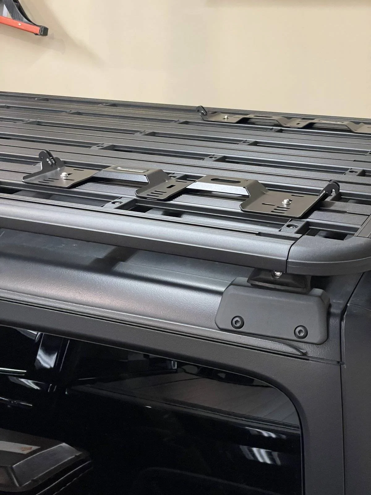

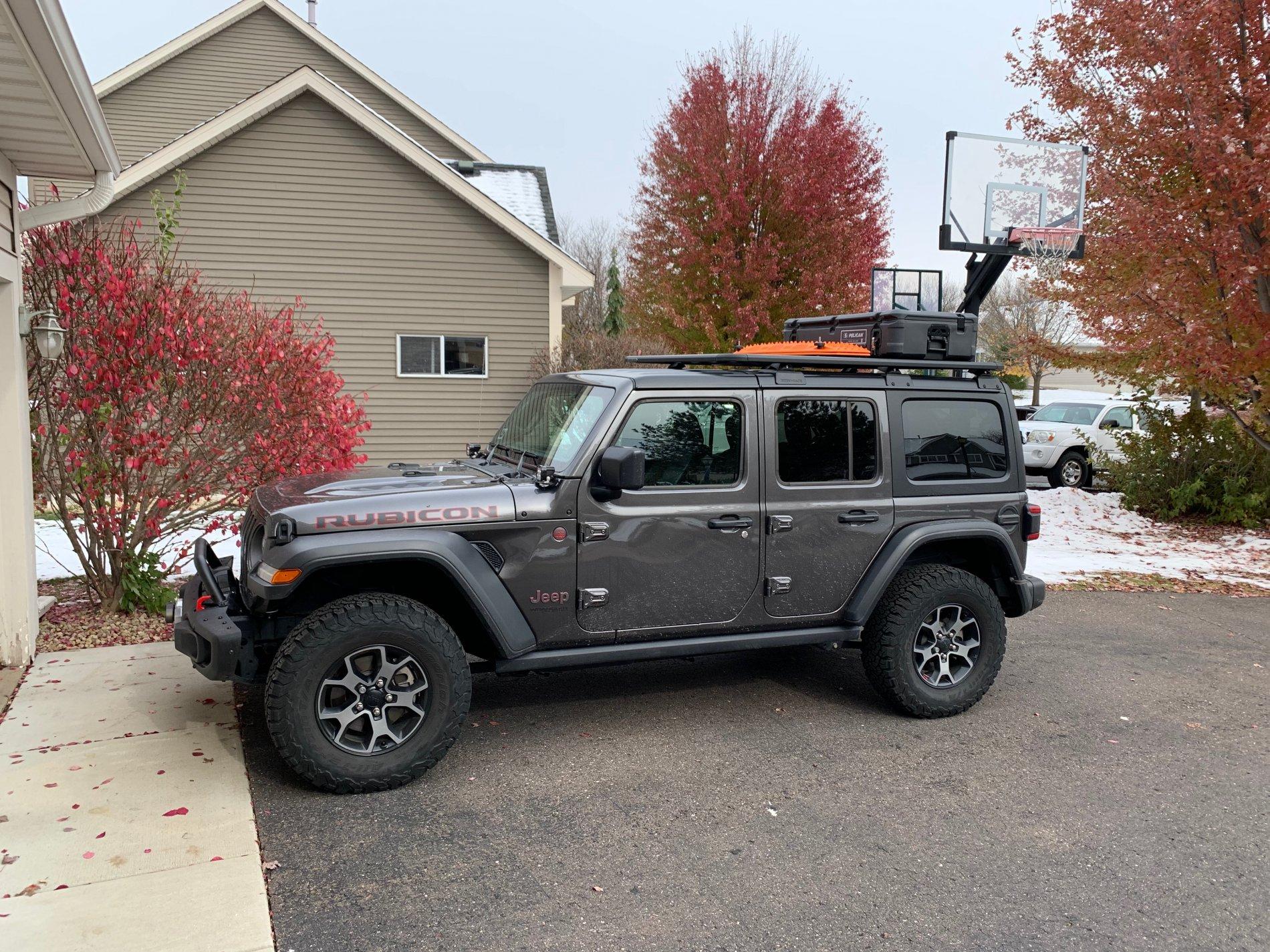

I mount the BX140R case to a Pioneer Platform utilizing the Pelican RFMT001LG Large Roof Case Mount. Very pleased as the case is impressive and mounting is very secure. I lock the case itself and lock it to the Platform with a cable and padlock that winds through the traction boards. As they say it keeps honest people honest. The only downside is the cost of the setup. Not cheap.

Did you need to get some kind of adapter to fit the front runner brackets onto your pioneer platform? Given that the pioneer panels run up and down while the front runner platform runs sideways, is this why your pelican box is mounted facing the front instead of the side? Am really interested in your setup. Just didn’t think it would actually work till I saw yours. Thanks.

I mounted it using the "RFMT001LG Large Roof Case Mount" from Pelican. You can mount is sideways either side, facing front or rear, or even mount two boxes side by side. I just leave the mount attached to my platform. As I have said this stuff is not cheap. But it is of very high quality.
