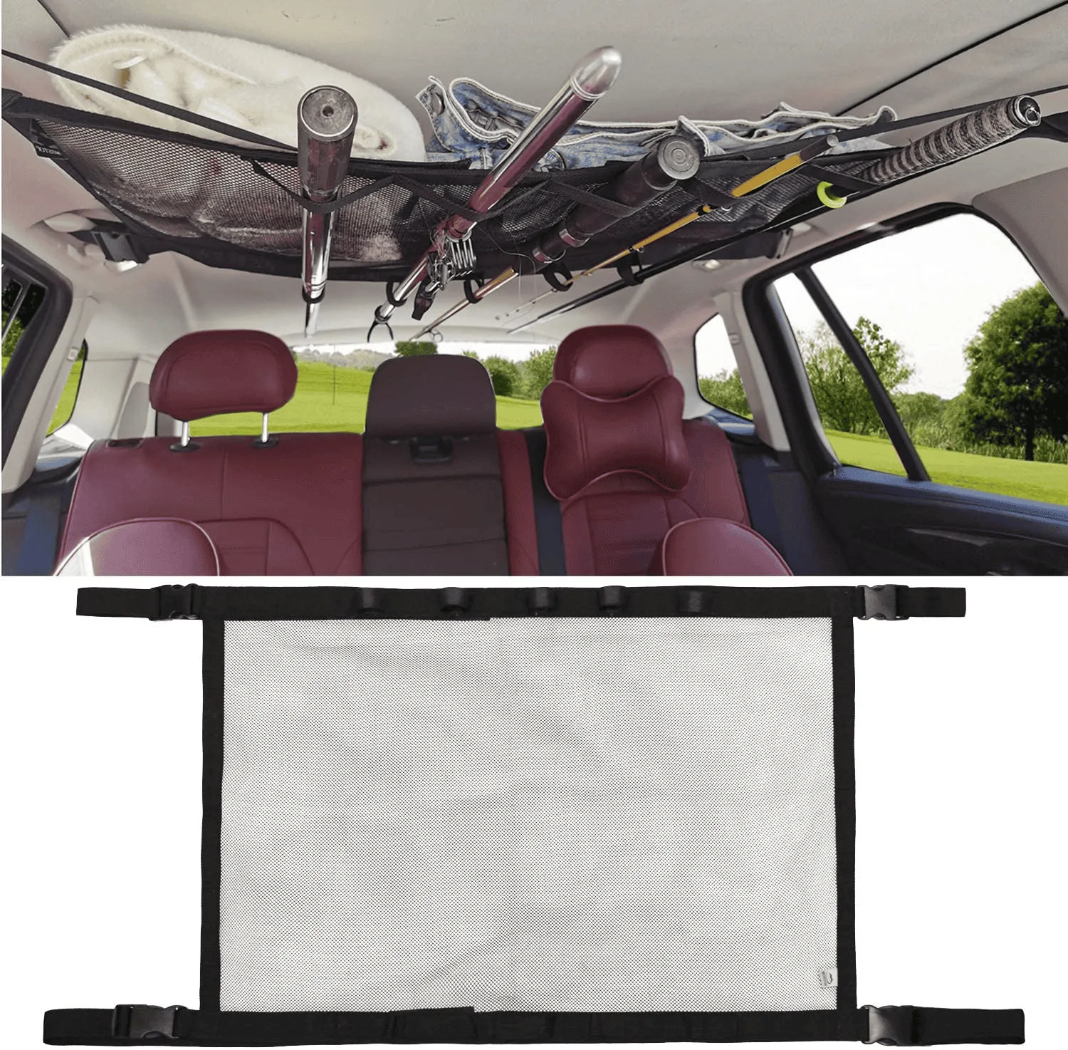

Like this:
Jeep Wrangler JL Is Anyone Using a Rollbar Sunscreen/cargo net For Storage? 1612366594081
https://www.amazon.com/MDSTOP-Inter...ocphy=9004233&hvtargid=pla-915692281561&psc=1
or this:
https://www.harborfreight.com/full-size-pickup-cargo-net-36598.html
I particularly find the first useful not for my fishing, but field and track interests: ;)
You just never know when there is going to be a javelin competition or pole jumping emergency in which my gear will save lives. (NOT!)
Seriously: sure, why not? :)

I orderd the Amazon mesh , be aware the actual size (opening it will cover) is 17"x 41", NOT 19" x "61" ; the latter size includes the strap length. I installed it in the rear section of my 2Dr JL ; to prevent sag, I used 2 Footman Loops to secure the webbing to the underside of the hard top. Self tapping screws into the hollow structural "backbone" . This is for lightweight items only for me, jackets,rain gear, etc. I will probably get another one to span the area above the tailgate, when topless with Dogs secured in the back.
