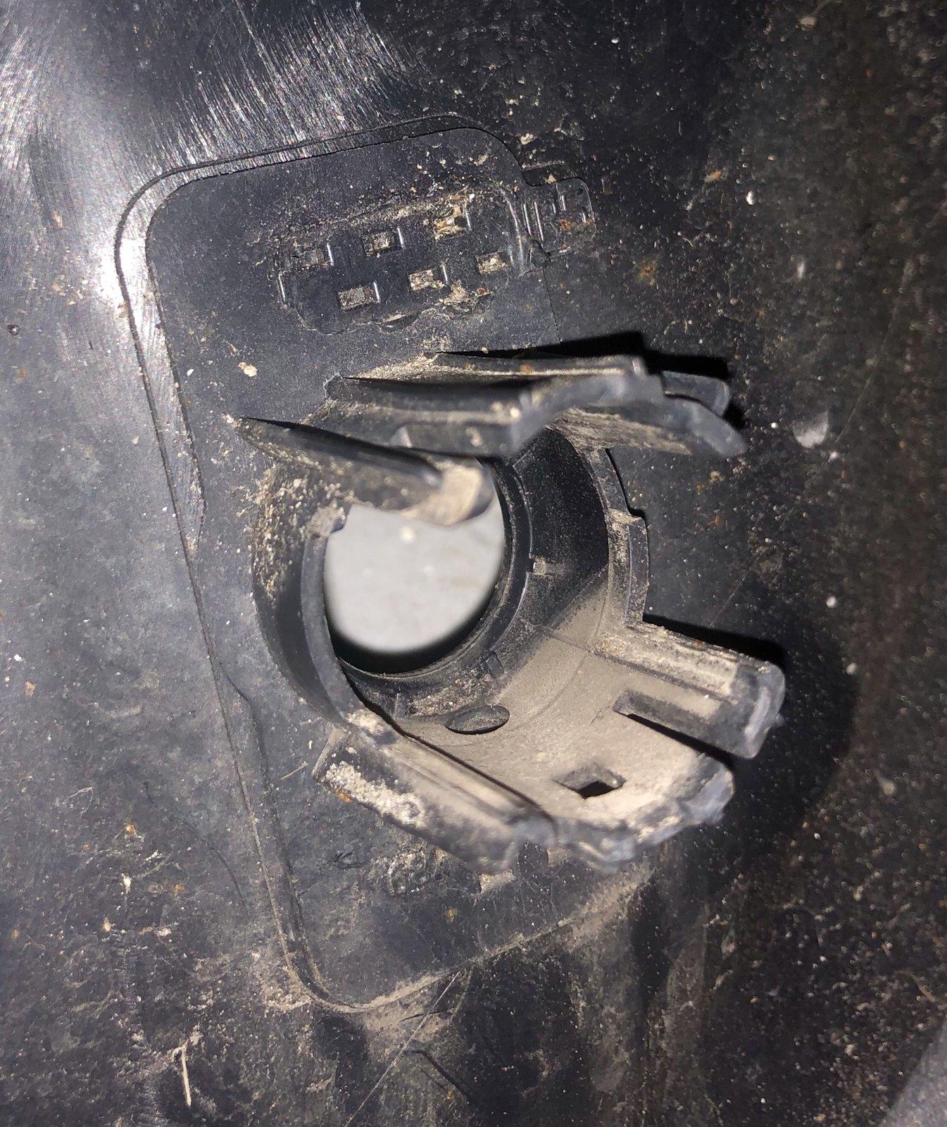

So I attempted to remove one of the brackets that was glued to the inside of my plastic bumper. I broke one of the tabs that is glued to the bumper, so I need a new bracket for a plastic bumper. Can anyone verify that the part #'s for the brackets in this thread will work for the plastic bumper?

This should work for the plastic bumper.

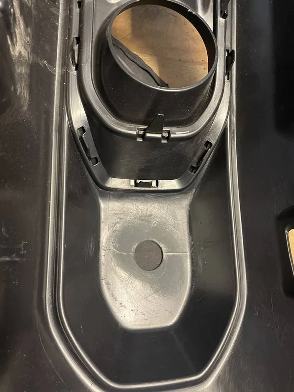

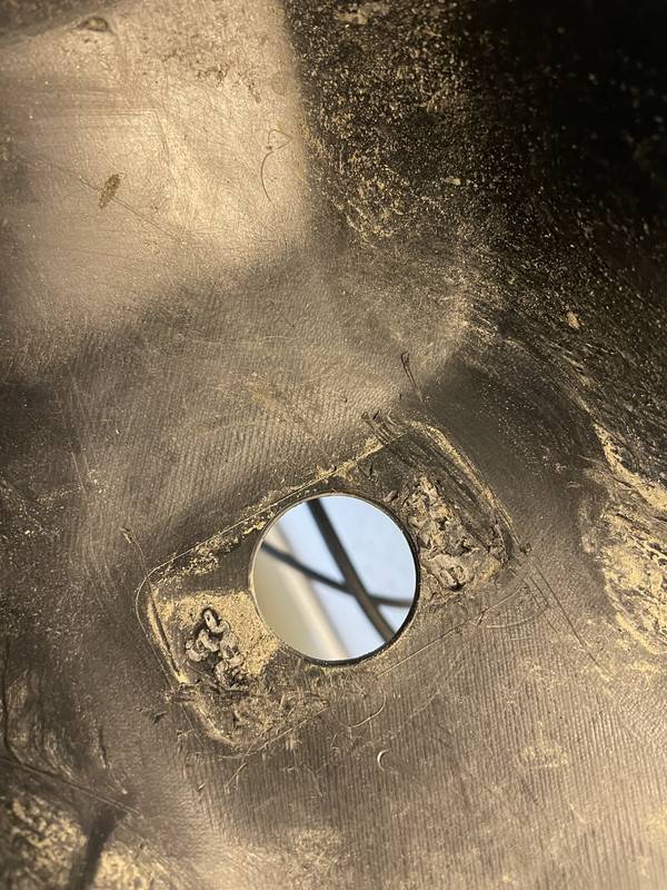

Hey! I can confirm that the measure of the whole needed in the bumper is 19 mm.
I installed my front parking sensors in a Rubicon bumper so I had to remove the brackets from the original bumper, drill 19 mm holes (6) in the US rubicon bumper and glue the brackets so I can re-attach the original sensors.
