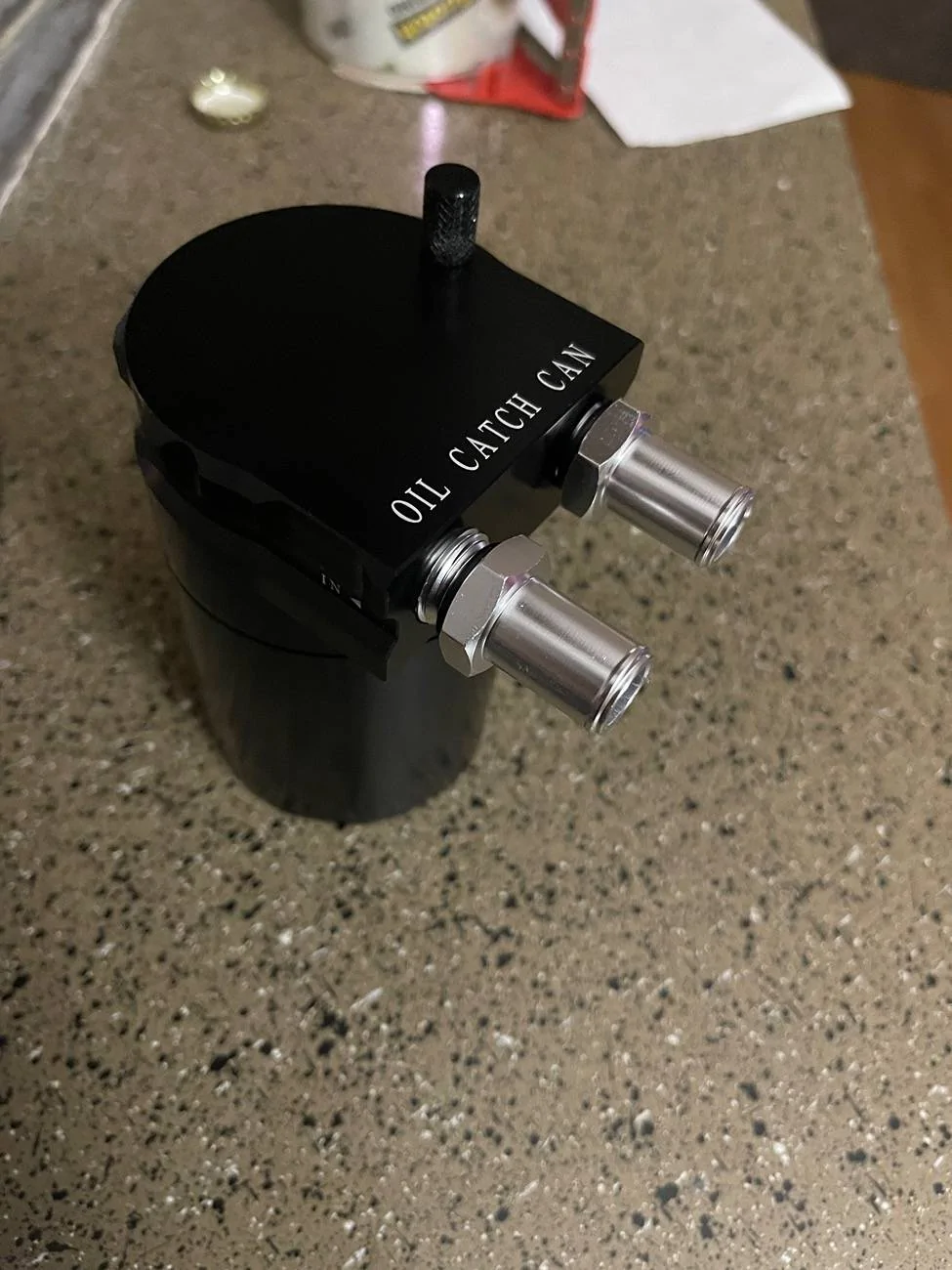

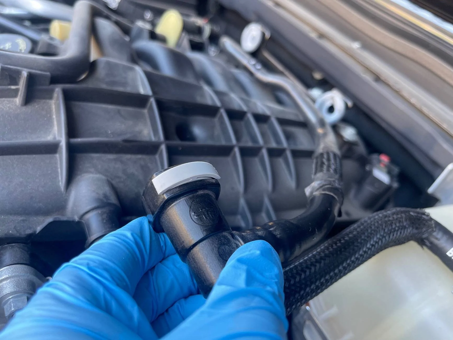

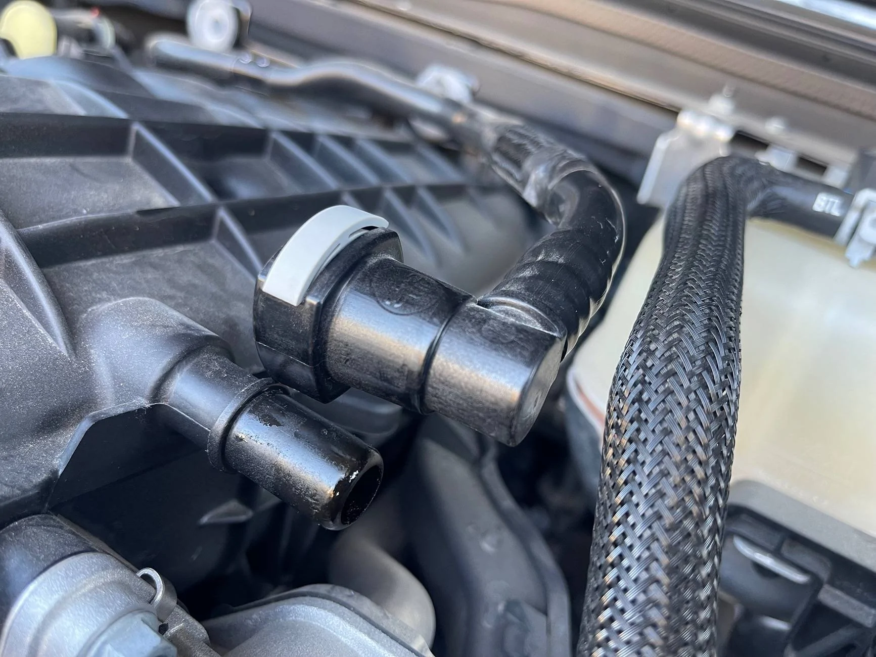

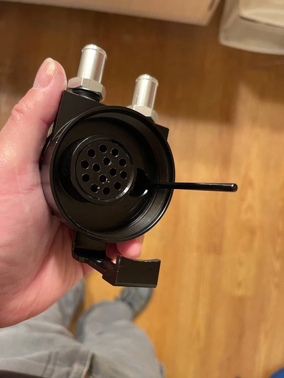

Does anybody have a part number or aftermarket options for the quick disconnects on the crank case ventilation system, a.k.a. the PCV valve? I’ve looked and all I can find are the complete hose assemblies, but I can’t find the quick disconnects. I’m doing an experiment and installing a cheap $22 Amazon oil catch can that appears to be pretty good quality, it’s just missing literally everything.
So I’m fabricating the mounting bracket and obviously fabricating my own hose system. Going to drill and tap the bottom of the can and install a drain cock for easy draining…. Hmmm basically I Don’t want to spend $250 on a Mishimoto! Judge me, I like a good challenge anyways! And… this one comes with a dipstick!
I might cannibalize the existing quick disconnects or just use hose clamps it the prior doesn’t work out.
Yeah yeah, I know catch cans aren’t necessary on our engines, but I’m doing this as an experiment. I think keeping the extra blow oil by out of the engine is probably a good thing. So any input would be great!
Thanks all :)

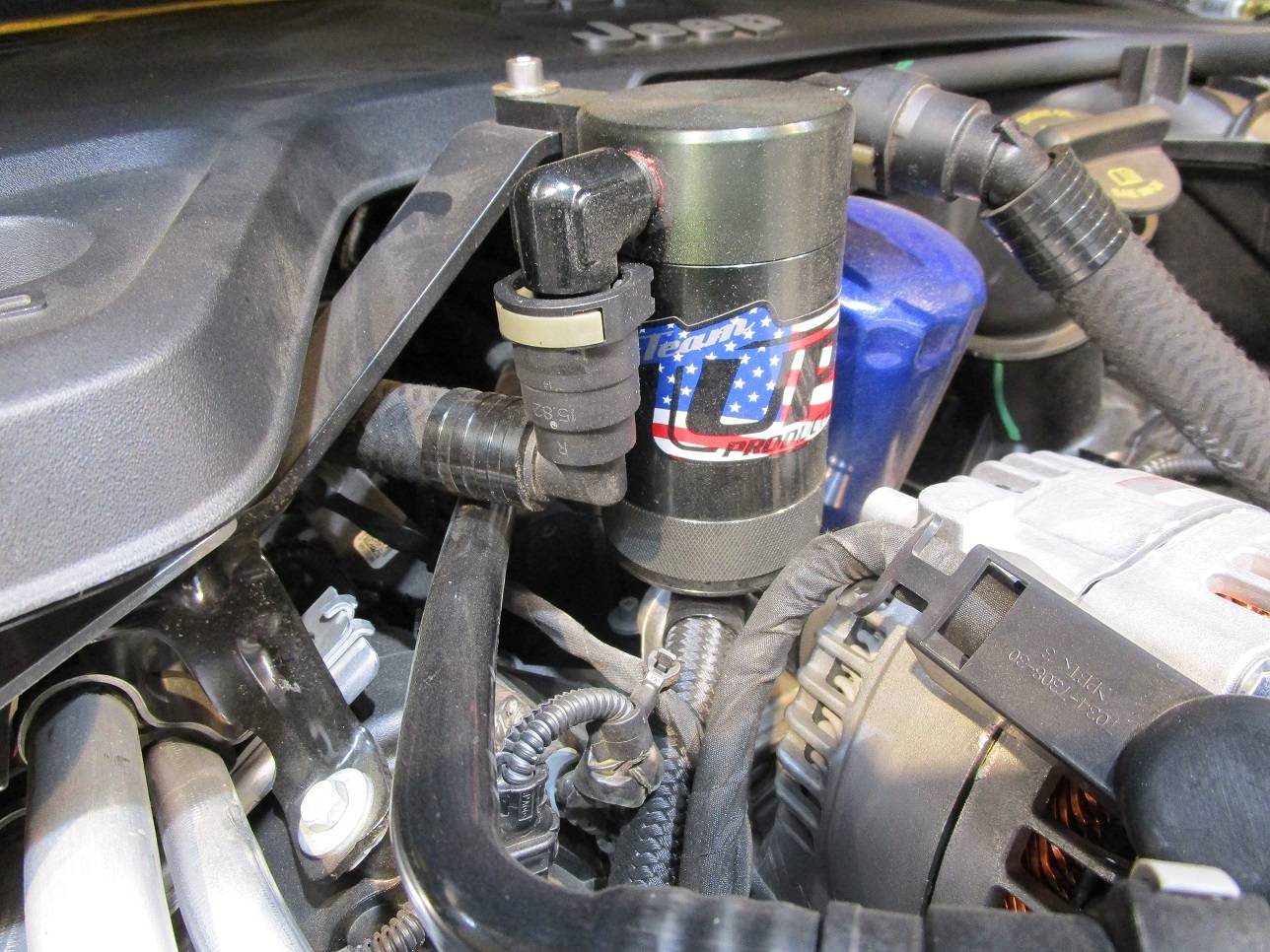

UPR
https://www.uprproducts.com/upr-plug-n-play-pcv-snap-fitting-45-angle-for-oil-catch-can-3-8-1-2-5-8/

I’ve read the horror stories with the UPR fittings a while back but I have no idea if they’ve updated anything since then. That’s why I was in search for an OEM part number for the fittings. I’m pretty good at fabrication, that’s why I’m making the custom mount. The only thing I wanted to do was have OEM fittings or screw clamps will work as well. I’m also going to check out the brand that Fczabala pointed out.
The whole point of the install is to do it as cheap as possible, but still have that quality there. Thanks for the reply.

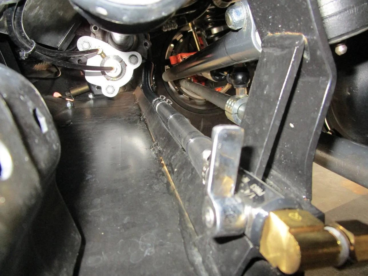

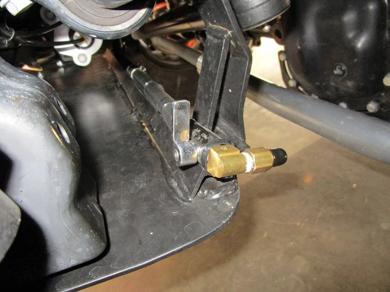

What I did to prevent oil build up in the can was add a 4ft X 1/2in. drain hose on the bottom of the can doubling its capacity. Never have oil in the can its all in the drain hose.

Nice setup dude! I’m going with the same concept of having a drain hose at the bottom with the drain cock. People can talk all the trash they want about the oil can debate, but they work! like I said, I was shocked at how my throttle body looked only after 49K on the engine. I don’t have the tools to do it so I’m gonna have a machine shop drill and tap the bottom of the can but after that, I’m gonna buy a piece of 2.3 mm stainless steel and fabricate the mounting bracket myself.
