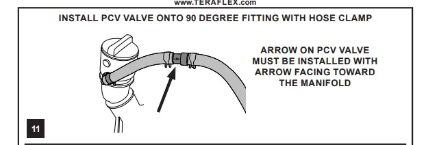

For those that have it, which way did you install the added PCV valve? The instruction say towards the manifold but the pic shows it pointed away from it.

This has been a popular question in the past few weeks, and I can shed some light on the subject since the terminology in the instructions can be confusing. The inline PCV valve needs to have the arrow pointing towards the intake manifold, (along the hose) and away from the adapter on the oil fill neck.

See thats where the confusion is, when its pointed in that directions its actually facing AWAY from the intake manifold in the physical sense but the "flow" is in line with the manifold. Maybe the instructions need a clearer description. Maybe something along the lines of "have the arrow facing towards the T fitting so the flow of air is towards the manifold".
