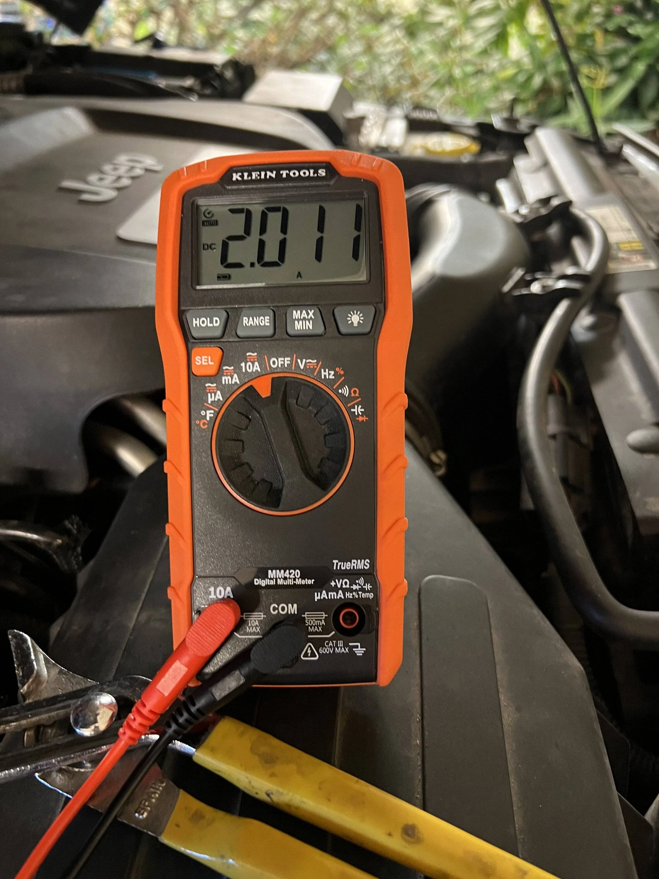

I have attached some pictures of my multimeter doing a test on my 22 JKUR Diesel. The first picture was taken at 3:17pm and shows the wake up pulling 2.011A:

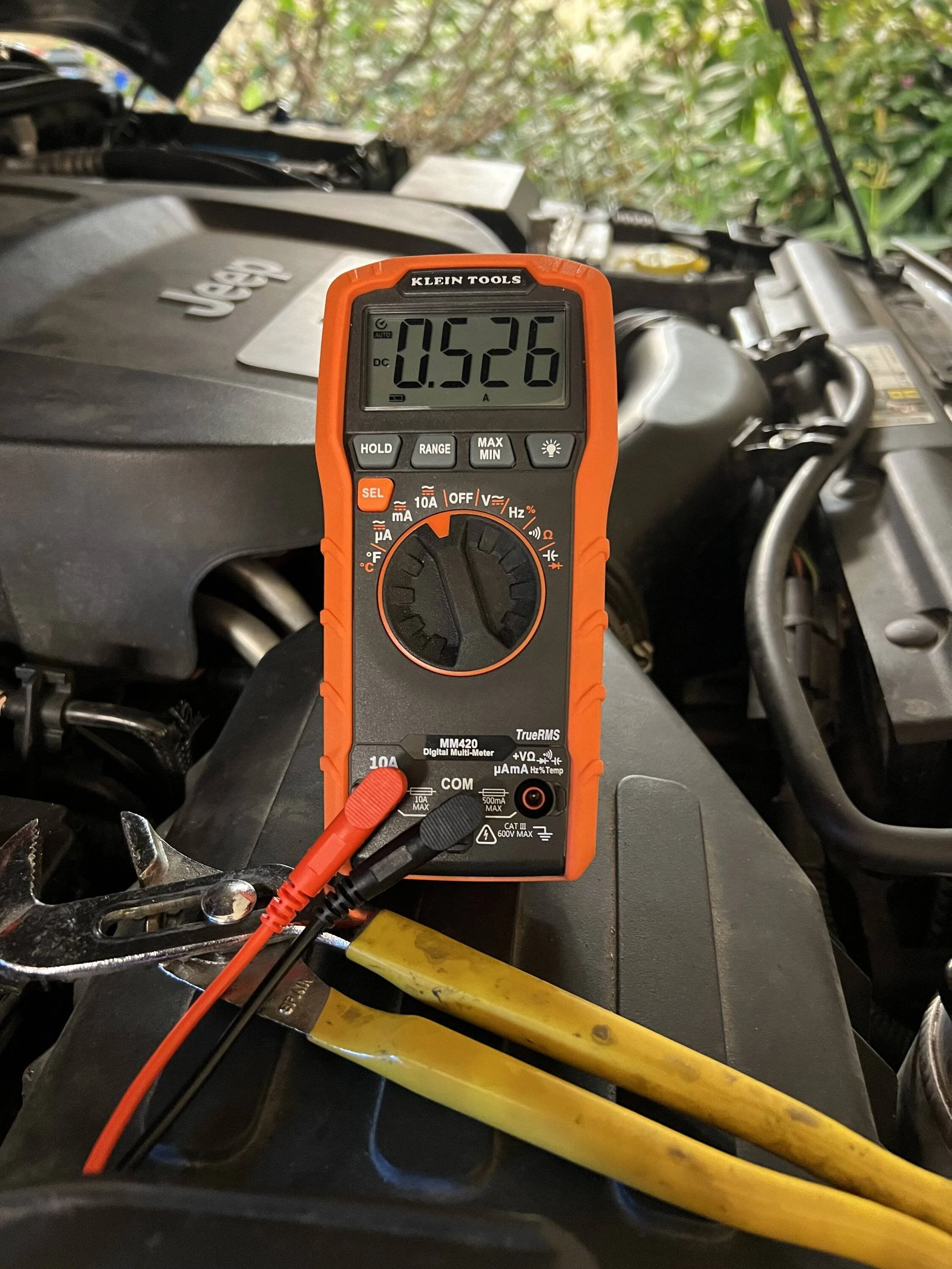

The next picture taken a minute later at 3:18 is pulling .526A (five hundred twenty six milliamps). This would be huge problem, but wait:

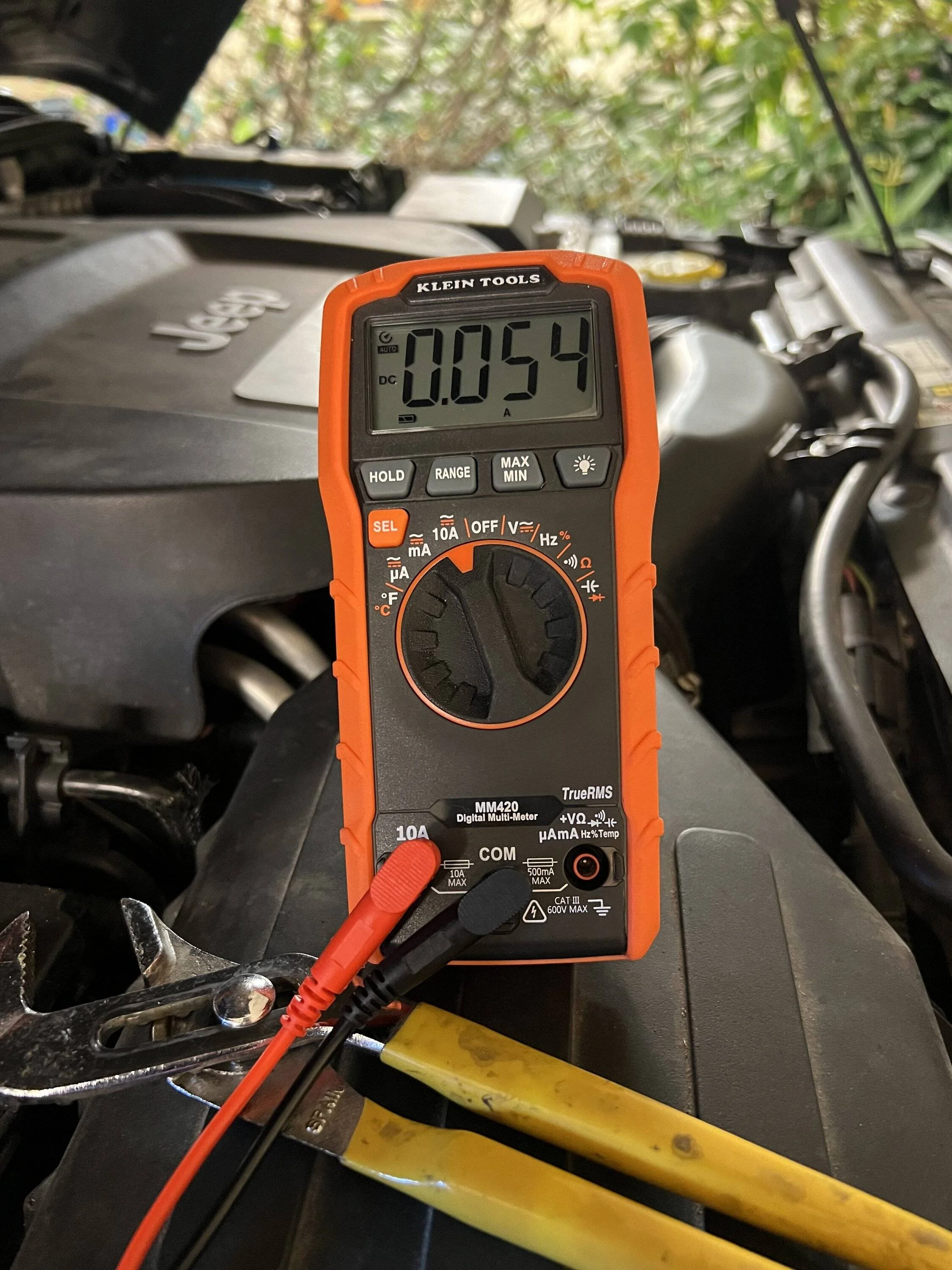

Two minutes from the start it is reading 54 milliamps:

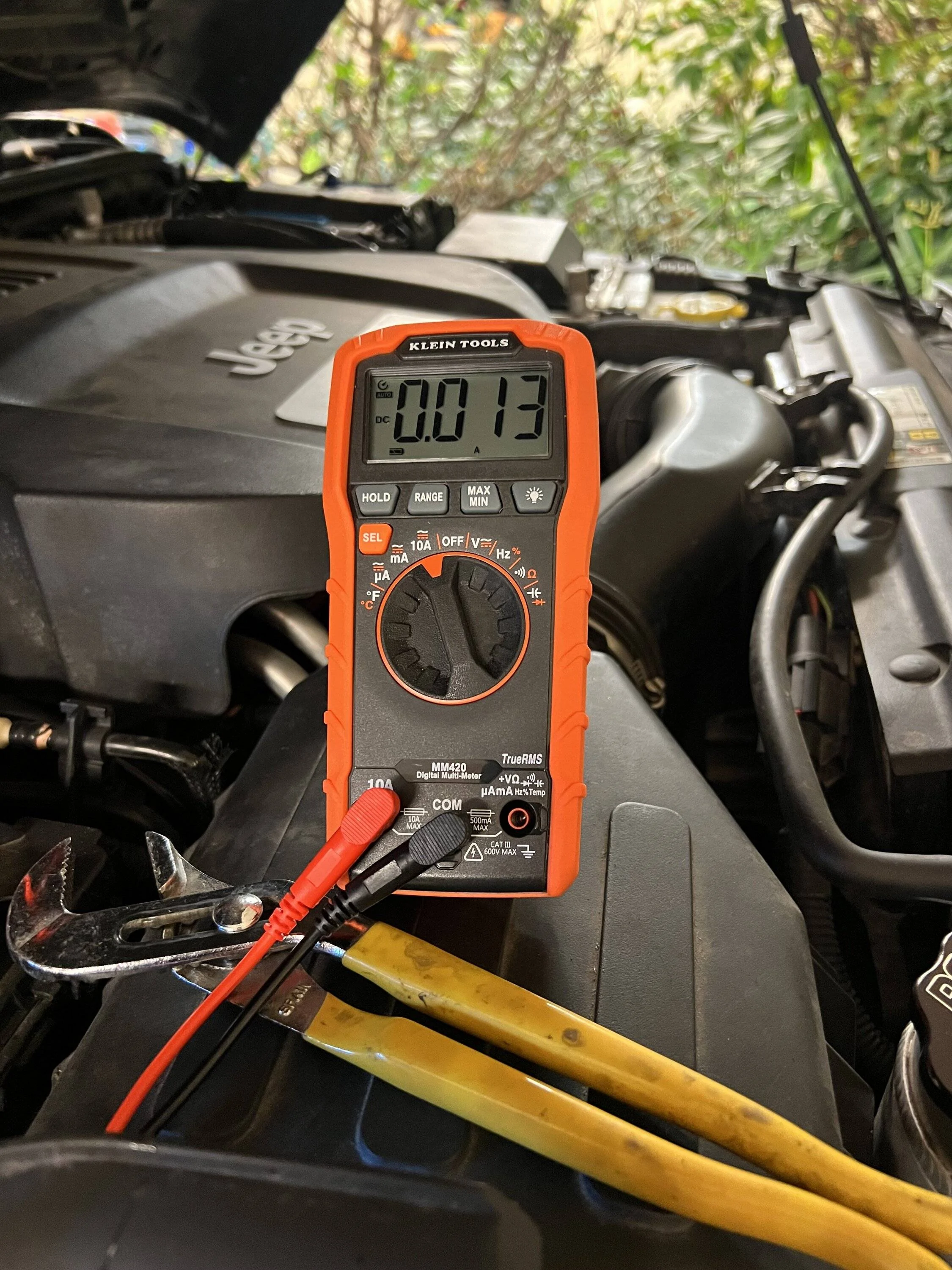

Then it reaches steady state four minutes later at 3:21 at 13 milliamps which is entirely acceptable. Generally you want under 50 milliamps, lower the better.
