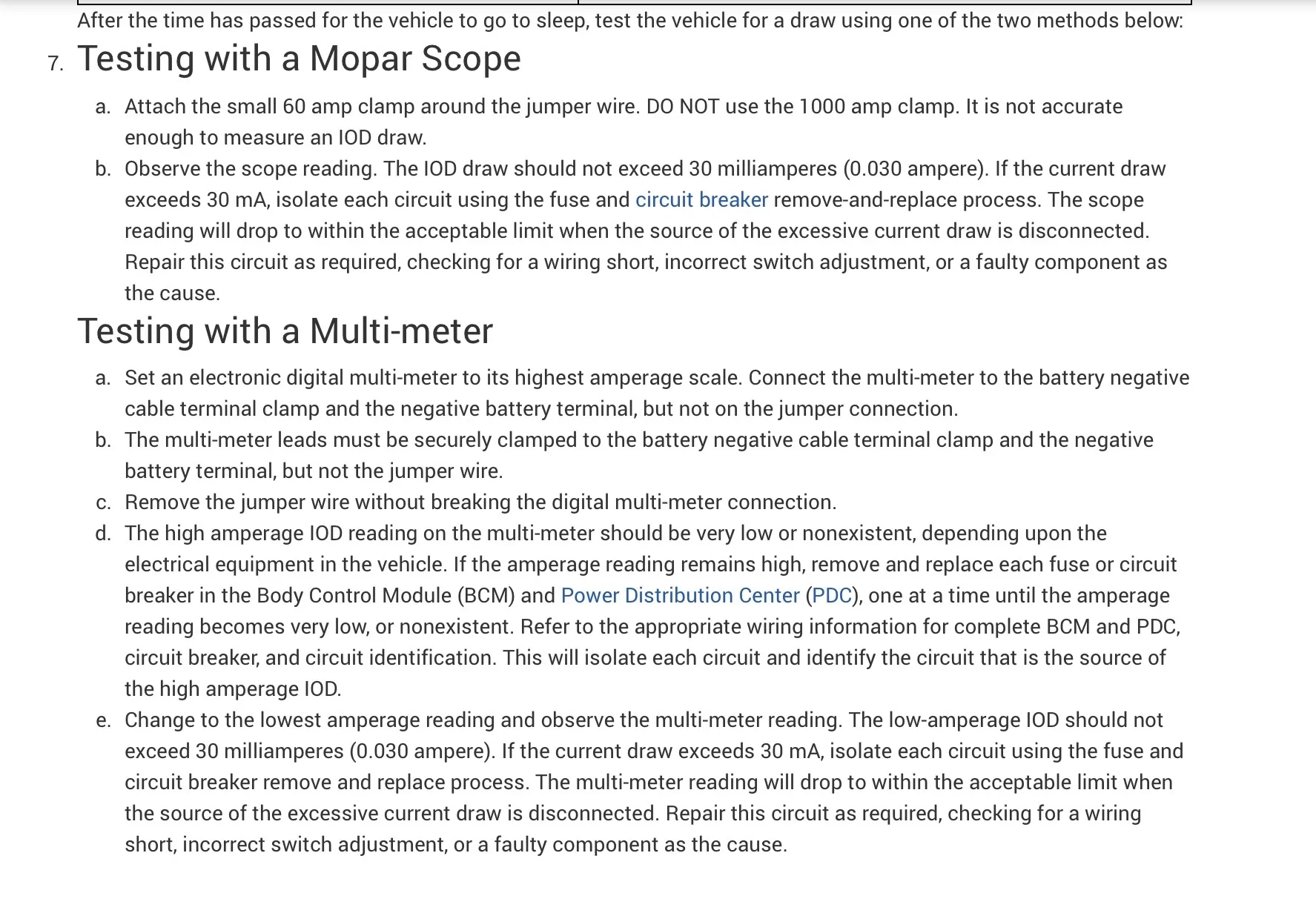

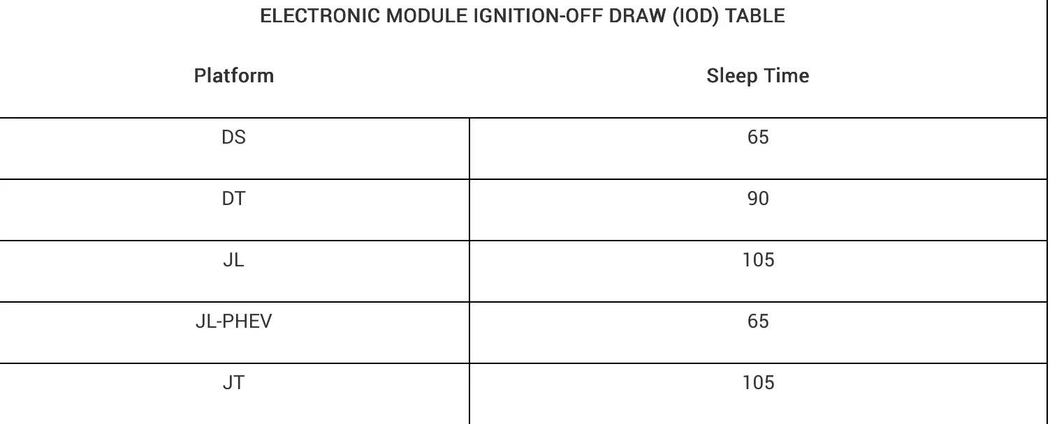

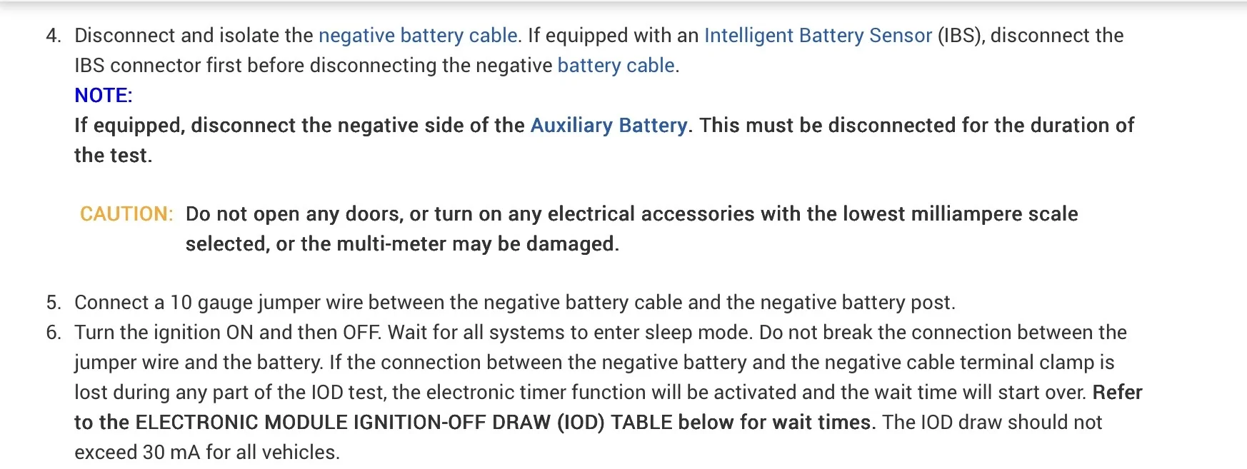

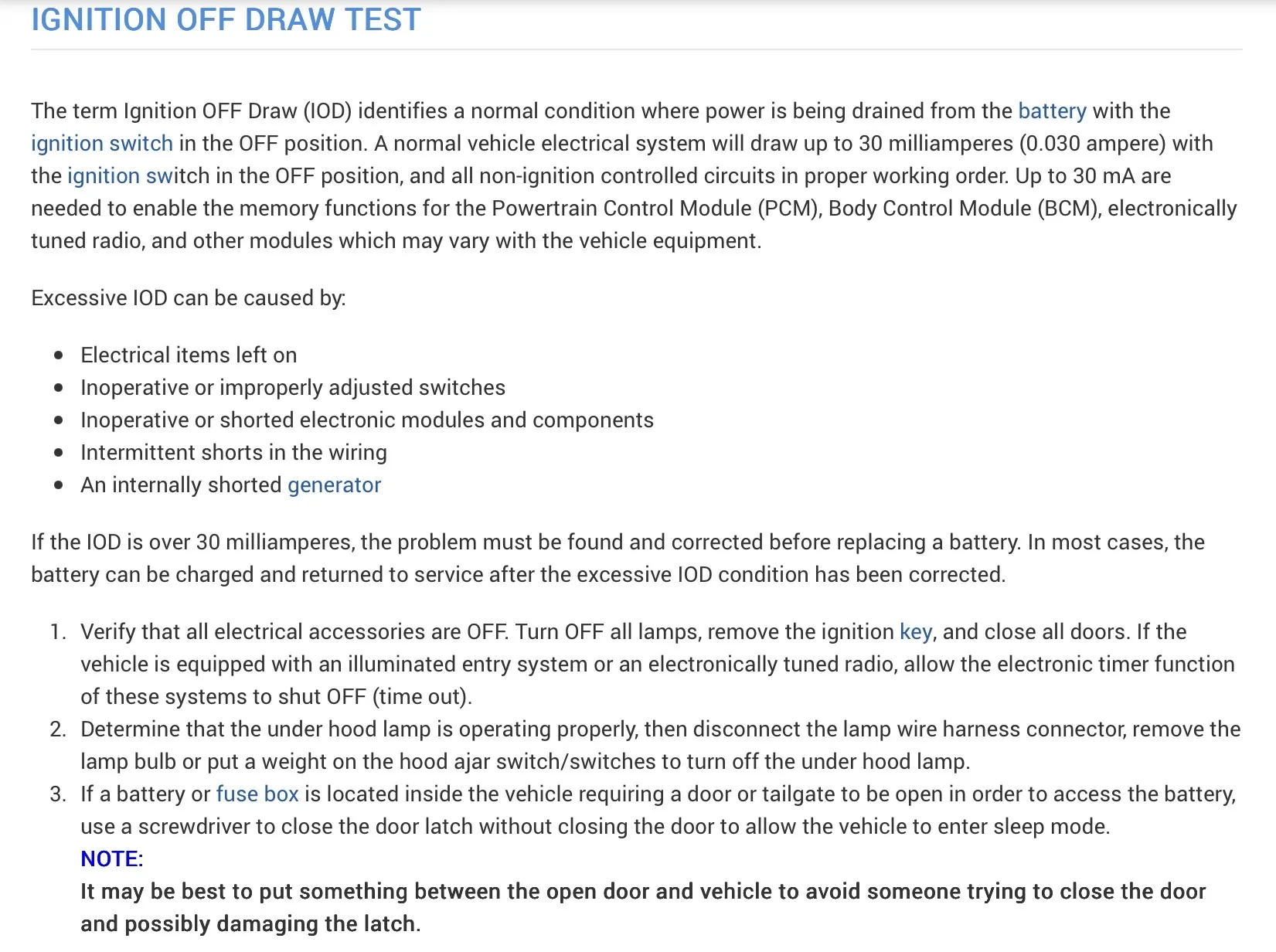

Supposedly Wrangler repair manuals suggest quiescent current should be 50 mA or less, and owner measurements are commonly under 25 mA.
But it's important to understand quiescent current can bounce around some (as you noticed), and allegedly spikes when the Jeep wakes up every 12 hours. So, it wouldn't hurt to take multiple current draw measurements at different times during the parked period, and/or reference IBS Lifetime Charge Received/Released.

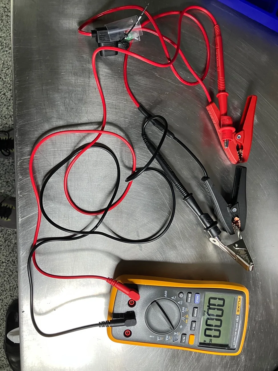

@ScotM, just curious, what's your current draw measurement setup?

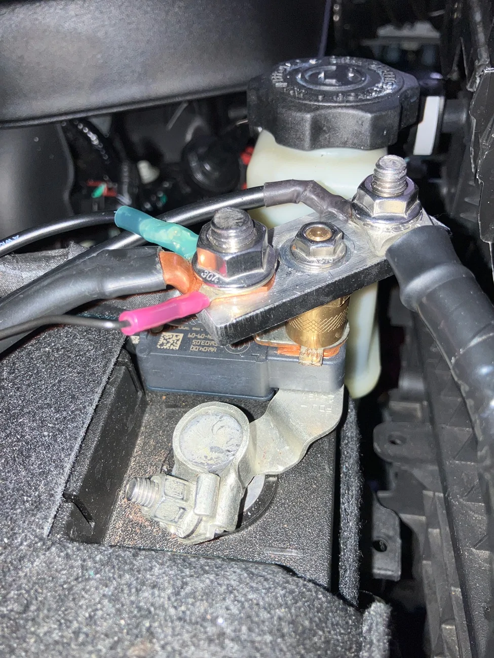

I’m using a fluke multimeter set on the amperes with the red plugged into the 10amp fused input. I have fashioned a jumper cable see picture that connects the black to the negative battery terminal and the red goes to the negative cable/ibs/ all my accessory grounds. That way when I disconnect one of the jumper leads - red one- the multimeter is put into the load without blowing any fuse. I had the dash cam unplugged during my test
