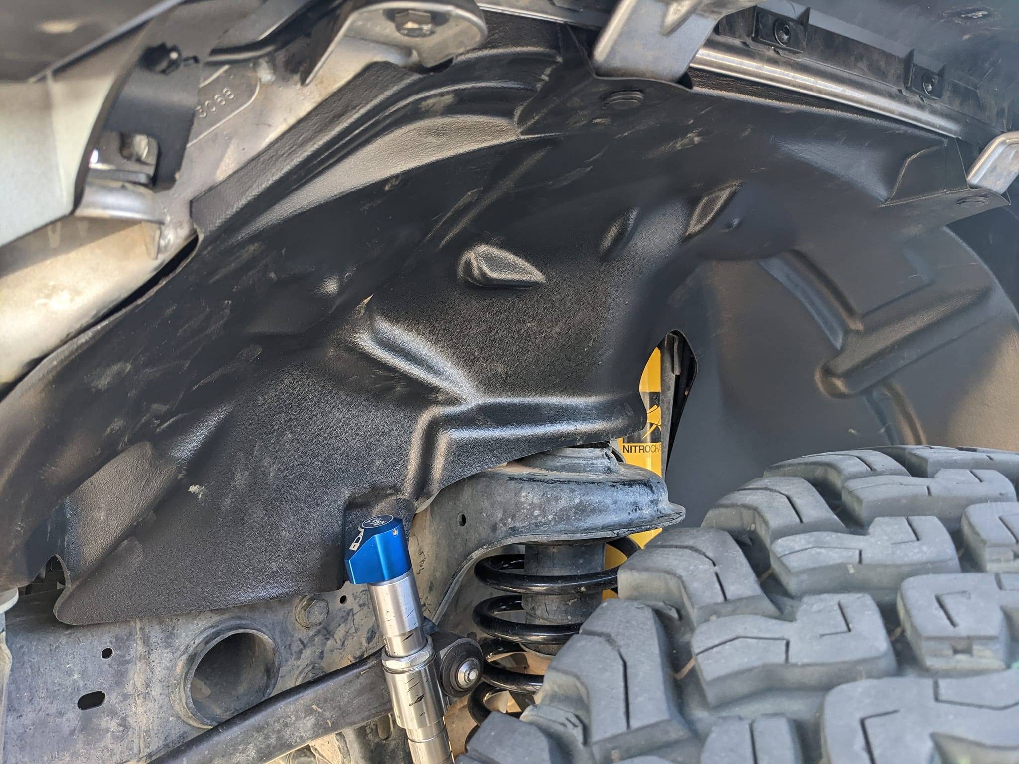

It might be due to my Apex endlinks, but does anyone else have an issue with the sway bar bolt hitting the liner. I had this happening on my OEM liner, but the Paramount ones seem even closer to the sway bar end link mount bolt. When the suspension moves up and down, disconnected or not (more noise when disconnected), the bolt scrapes up and down and makes an annoying noise.
I'm either going to have to drill a small hole in the Paramount liner and run a long zip tie around the frame to tuck them back more (might not be enough), and/or trim that area out completely with a dremel.

Yes my boy has same issue. We used a roto zip and notched them perfectly.

Great. Thanks for that. I just drilled a tiny hole near that area and ran a long zip tie around the frame there. Seems to have minimized the issue. If it doesn't, I just picked up a battery operated rotary tool and will trim that area down. Does your friend happen to be able to send me a pic of the final cuts he made?
I had to remove the inner fenders so many times over the past few days that the hardware completely destroyed itself. Ordered a universal plastic fastener kit off of Amazon, so hopefully I can get them mounted up again today.

Yes I'll send you a Pic. And yes the Amazon kit works great. I have a big bag I carry in my kit for back up.
