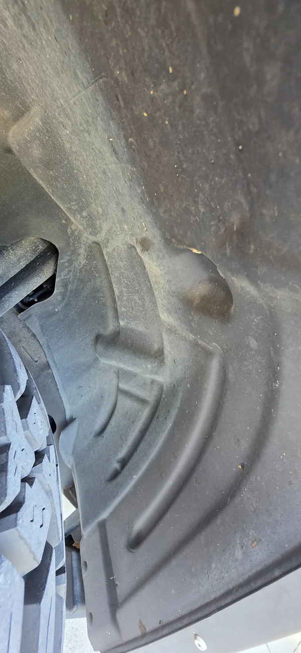

After trading in my JK, I went off road in my new to me 2021 4-door JLUR while it was raining. Got a lot of orange sand all over it and had some fun in puddles. It's been 4 weeks and sand is still coming out of the junction between the painted OEM fenders and the inner fender liner. I'm sure there's a post on this but I can't find it.
Questions:
- How do I get the remaining trapped sand in there out?
- I don't want to remove them since they're painted and have the OEM LEDs, so what are my mod options to keep sand out?
- What have you done to prevent sand, etc from getting trapped in there?
Thanks!!

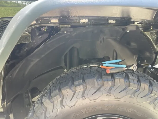

It was one of the earliest mods I did yea May 2023 after I bought it Dec 22. On board air, switches, LCA & Shock skids then the chop. Shes way more modified these days than the early pic at the end.

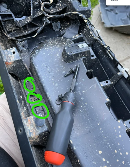

Those rivets are what hold the liner to the fender not the 2 pieces together. This is the underside of the fender with the liner removed. The circled bits are where the 2 halves are plastic welded together.

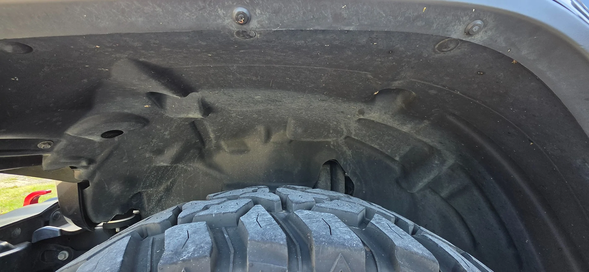

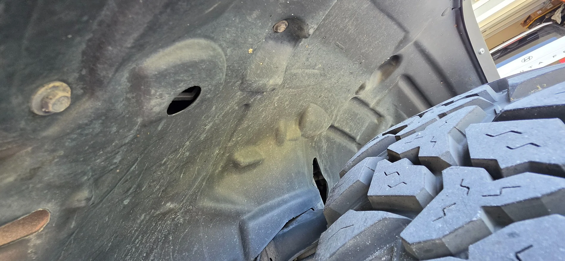

Sorry if these suck 😂. My liners don't seem to have the same welds? Maybe I'm missing something?
The liners have to come out for you to see the inside of the fender I pictured up there. The liners are held on with some screws and all the rivets along the bottom of the fender you can see in your last picture. When you do the fender chop you will have to either cut up the stock fender like I did in the picture I posted or get aftermarket ones.
Ohhhhhh... Gotcha. I see that now. Many thanks!
