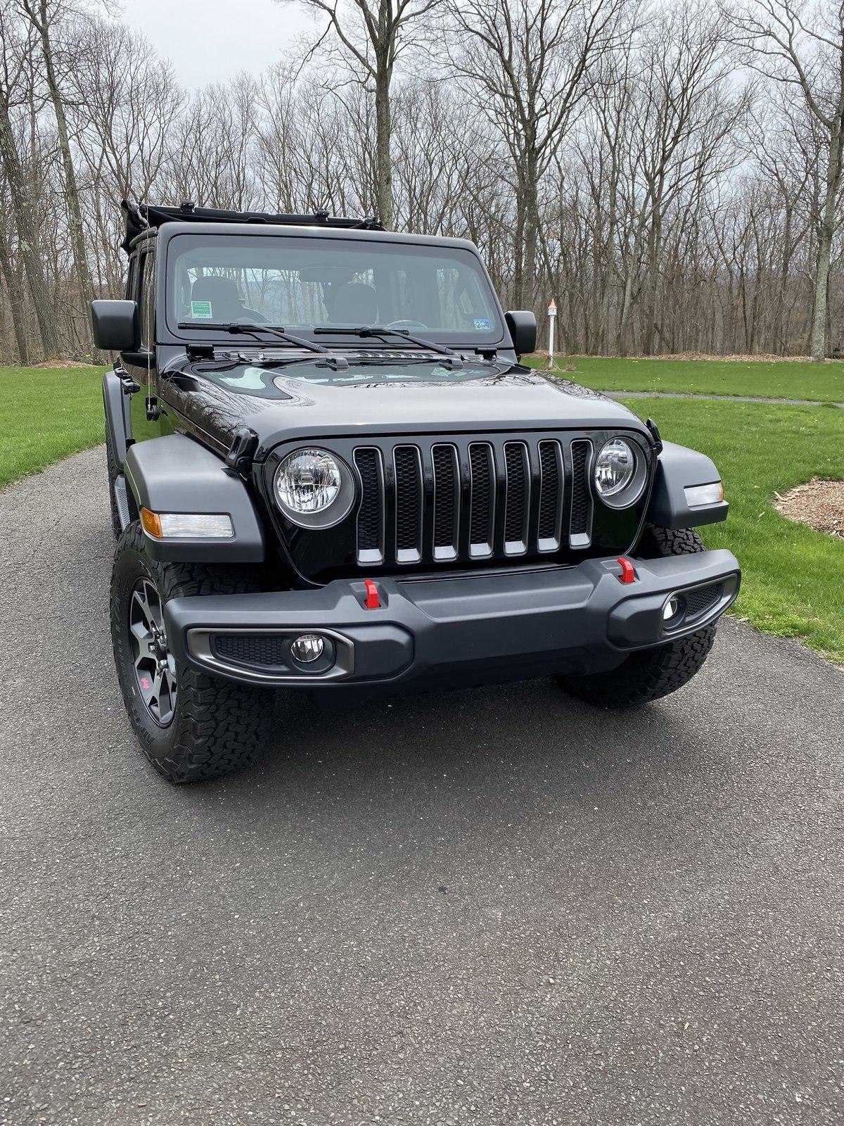

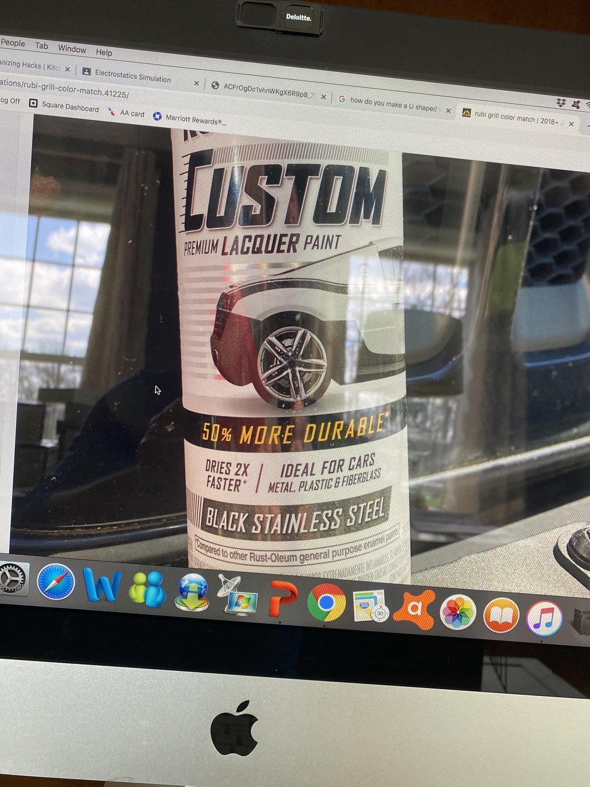

I’ve been searching this post for the color of the Rubicon grill inserts to no avail, until NC Jeeper gave me the goods.... painted them this week and swapped out my black tow hooks for red ones. Came out fantastic. Thanks NC Jeeper.
This is actually a Sport and I painted the eBay plastic inserts. Just primed them and put like 4-5 coats on.

hi there. i love what you did with the red tow hooks. what brand and color did you use or did you actually buy OEM Red hardware?

I actually bought ones off of someone’s Rubi on this forum.

Just to confirm, you used that rust-oleum Custom black stainless steel lacquer paint on the grill and bumper inserts? It looks great, just want to confirm the color. I’m about to do this exact thing in my gladiator overland.

Yes. Got it from auto zone. I primed them with a plastic primer as well. If I did it again I may have scuffed them up a bit to help the paint hold even more. Also, may have put a few coats of clear on top to protect them. They get a little chipped up. I just touch them up with a small artists brush and it’s fine

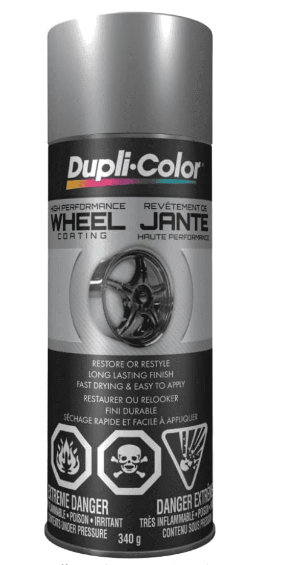

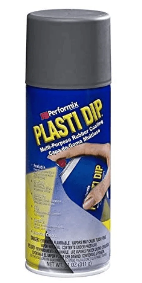

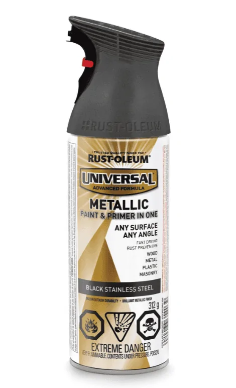

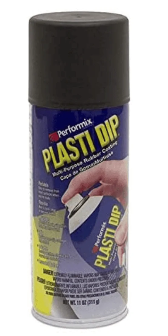

The paint spray mentioned in this thread is not generally available in Canada :(
I am trying to decide between the alternatives I have found and would love your suggestions on what is the closest in terms of Color, adhesion and long term durability of the finish
My wrangler JL Sahara color is Sting Gray

Rust-Oleum Universal Metallic in Black Stainless Steel

Dupli-Color CHWP10207 High Performance Wheel Coating, Graphite

Performix Plasti Dip True Metallic Anthracite Grey

Performix Plasti Dip Gunmetal Grey
