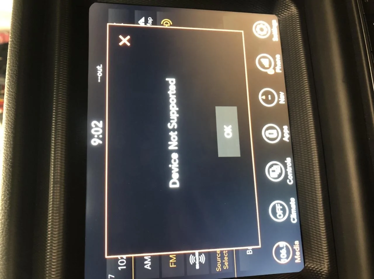

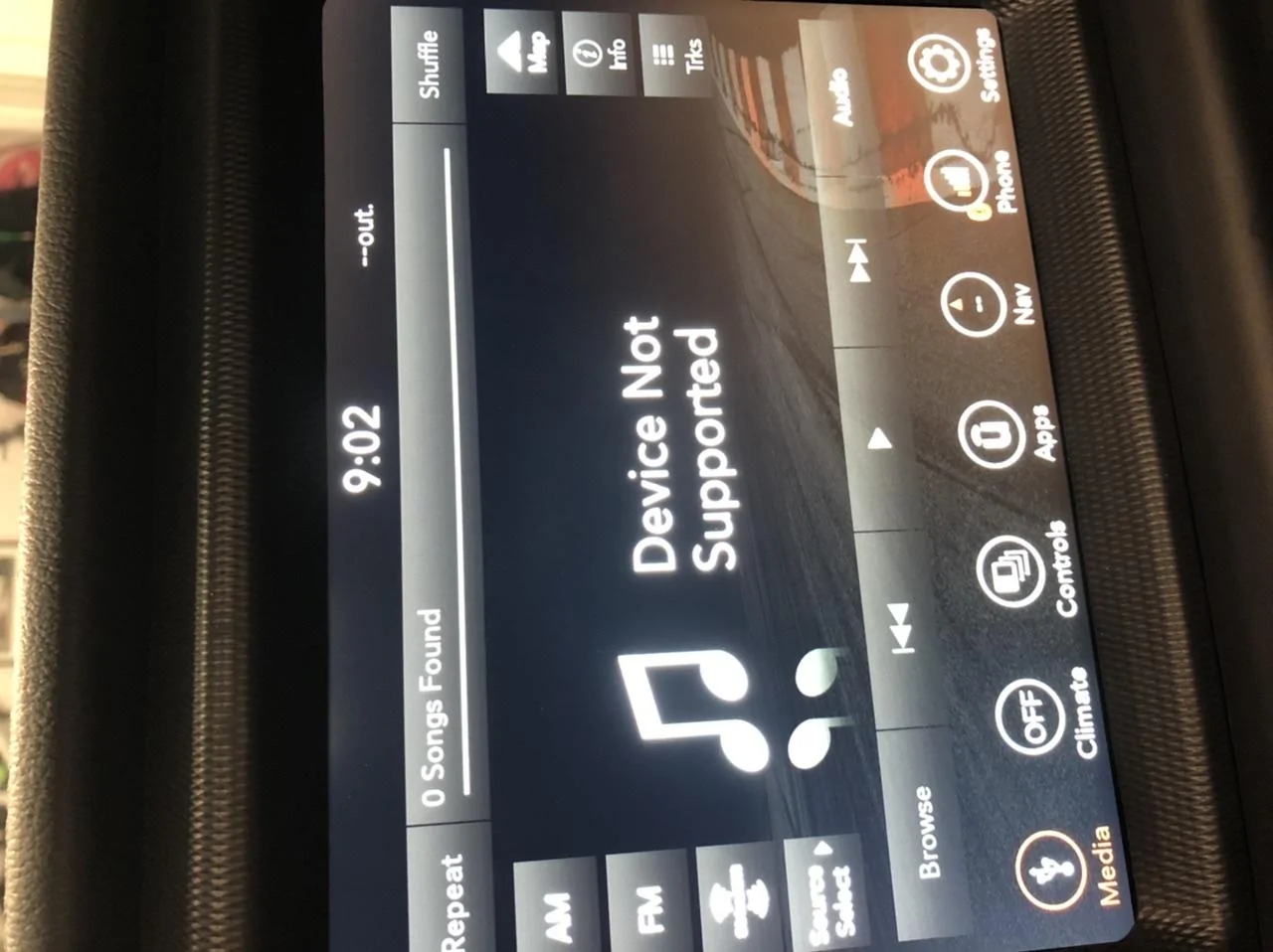

Thanks. These are the screens I get now connecting the same device that worked before the recall.
Jeep Wrangler JL Over the air update issue 14094D93-B891-4F40-823C-A1806A100361
Jeep Wrangler JL Over the air update issue 4F56FDAB-EB07-4F10-9333-5A900B9CDA8A
Thank you for sending this over. I've passed them along.
