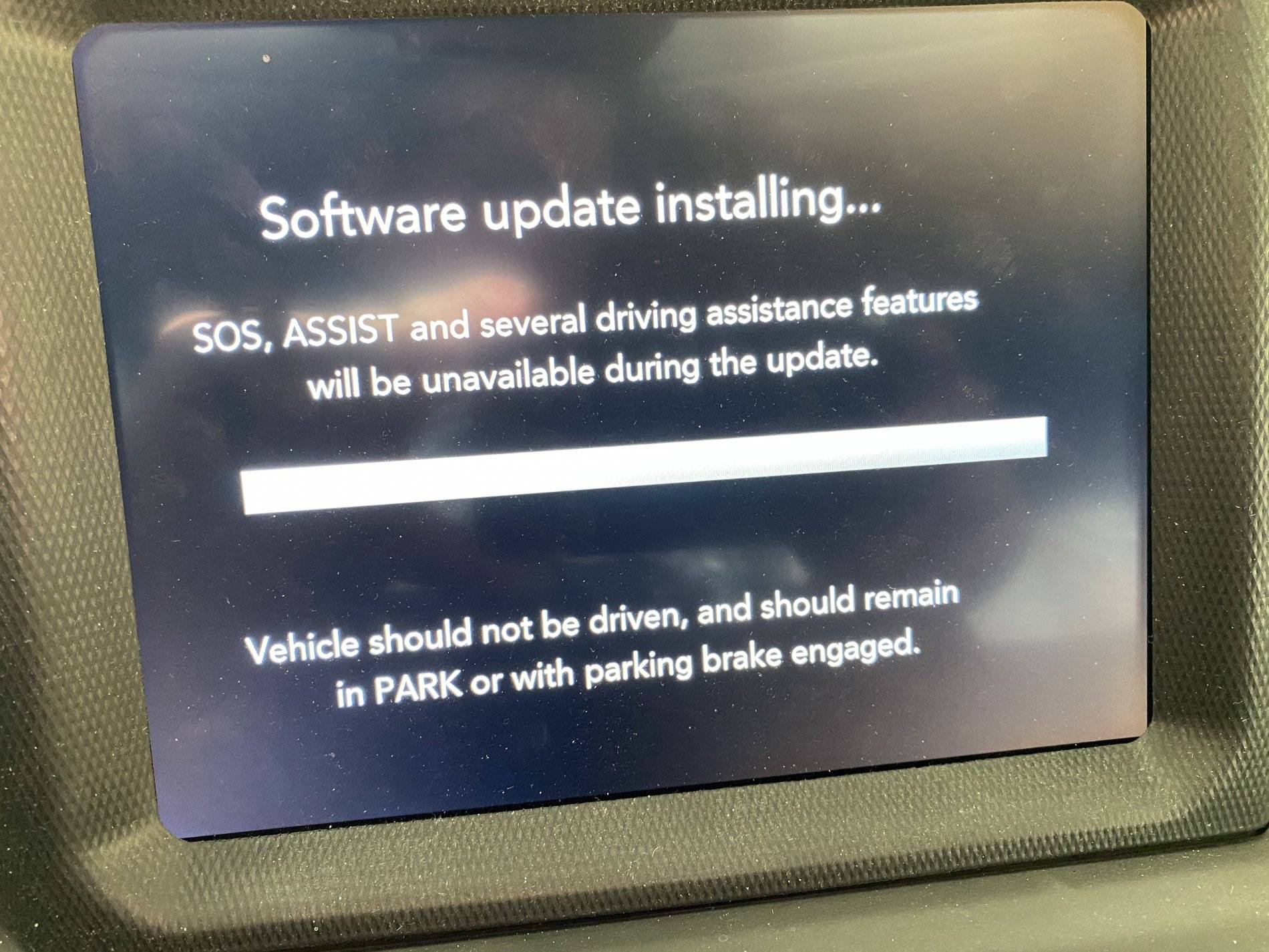

Update started yesterday afternoon, and screen is still the same.
We were out with the Jeep when prompted to update. It gives zero prior warning or indication that once it begins, you are not supposed to drive the vehicle. Once update begins, then it states not to drive. We had no choice, and drove it until we were back home.
Low and behold, the same message is on the display still today. I pulled the fuse which removed power to the radio, but it returns to the same screen once fuse is replaced.
Any tips or tricks other than a dealer visit?

Dealer update #2: Needs radio for certain. They tried bringing the radio back to life by removing both batteries from the equation. This did nothing for the radio, but they were unable to start the Jeep after reconnecting the batteries. They had to replace the "star" connector, now the Jeep starts as normal.
Getting a loaner and they will keep the Jeep until new radio arrives...whenever that is.

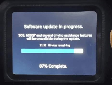

This is what I got yesterday:
I came back out an hour later and got this:
Regardless, hope you guys get it worked out!
