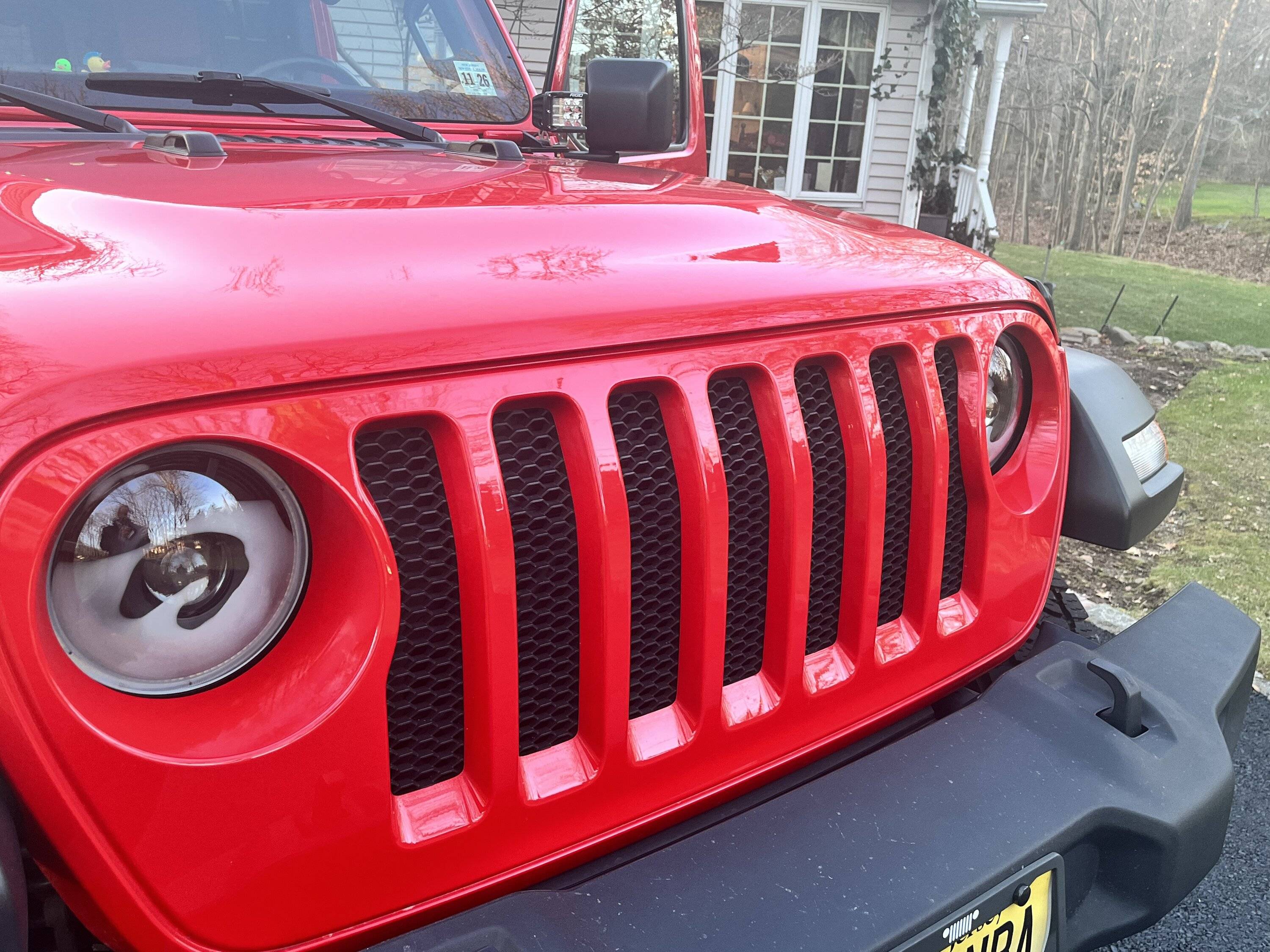

Appreicate your helpful involvement here. I am having the same issue with my brand new Oculus lights. If my garage js heated and I live in the northeast (where its fairly cool right now 40’s) would that potentially be the cause of the lights fogging up when I go out with the vehicle?
I also have a lot of oncomjng traffic flashing me which seems to indicate my leveling is off but also wondering if the fog might be creating glare?
I had the lights professionally installed by a distributor of yours.
Thanks

Condensation or fog is 100% normal when first installing headlights. You can find other references from members where they have seen this due to a change in temperature and just installing the product, and after a week or so, this completely dissipates. This is not a problem with the lights itself.
For the adjustment you may need to do this. You can follow the steps below:
It's a necessary step to check & re-aim any headlights when replaced. Here's step by step instructions on how to aim the Oculus lights:
  1. Park the Jeep 15-20ft. away from a wall on a flat surface
  2. Measure from the ground to the center of each headlight
  3. Mark the same height on the wall with tape
  4. Locate the adjuster bolt on the back of each headlight covered by a rubber cap
  5. Aim the cutoff lines to meet the marked spots on the wall using the supplied allen tool.

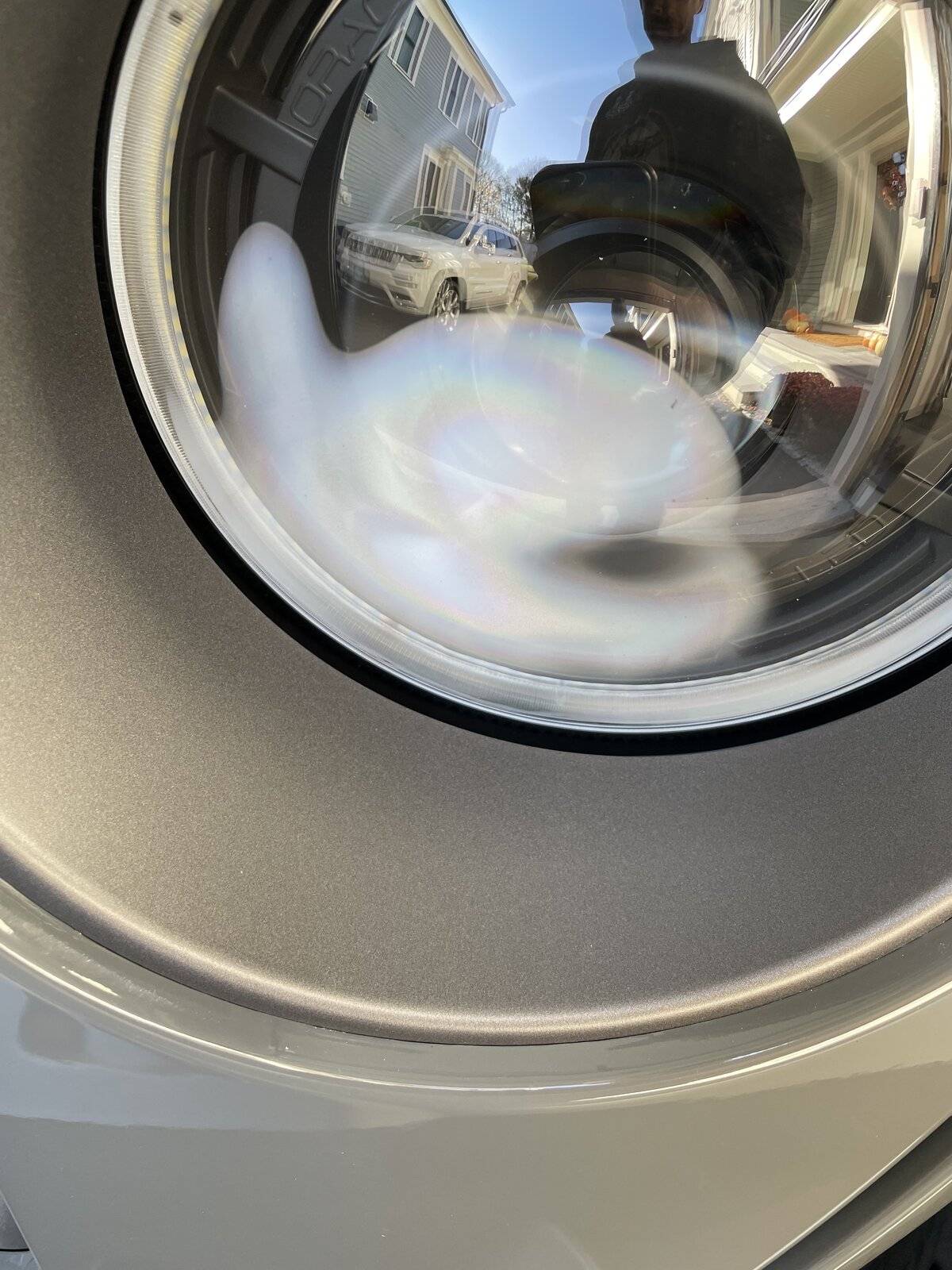

Are you people still experiencing fogging with your lights? If not, how long before it went away? I just installed a pair on my JL and noticed fogging after a few days. This was the second pair of Oracle headlights that I received (first set was returned because one of
the lights had a random screw rolling around inside the lens). They give off great light but, so far, I’m unimpressed with the quality. I have a Quadratec return label and am debating sending them back for a different brand or keeping them with the hope the fogging stops after a few weeks.
I would HIGHLY suggest waiting for the condensation to dissipate. We have had a select group of customers experience this, especially with the change in temperatures from our area to colder weather.
After about 1 week almost all customers no longer had this effect.
Please give it time! If you do not see anything lessen, please reach out to us directly for assistance.
