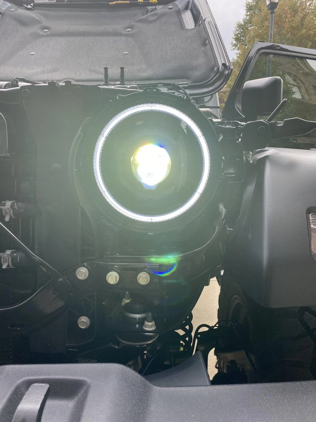

the new JL came with halogen so I had to upgrade. I went with the Oracle oculus bi-led. I also upgraded the fog lights to the 20w high output fog lights.
the head lights went in super easy and wiring the drl halo was simple. Everything was plug and play. The worst part was pulling the grill off.
I will tell you they do not include instructions. They are quick to email you back but offer little assistance other than a video they will direct you to.
I was able to get both sets for significantly less than a pair of mopar led headlights (900$)
Now I just need to adjust them.

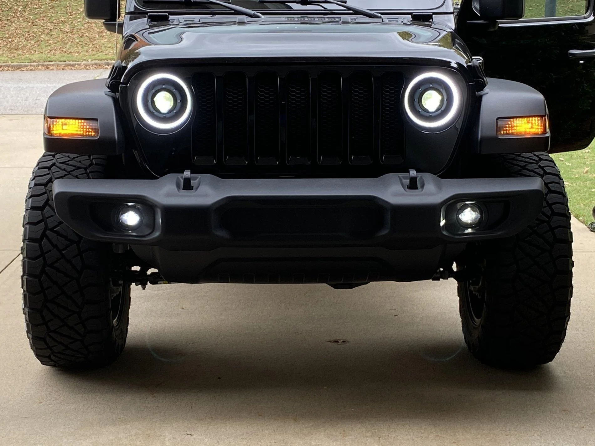

They are the led 20W fogs. There are no directions so when you install they say use the plug and play which happens to be the red plug coming out of the tan bracket. I was about to cut and butt connect until I happened to pull on the red plug and realized what it was.
there will be a lot of extra wire and you will need to split the black wire with the o ring for the ground post and the red wire for the fuse box about 6-7 inches.
thanks for the compliment. They are so much better than the stick halogen
I just need to adjust down a little and adjust the fogs a bit.
good luck with yours
