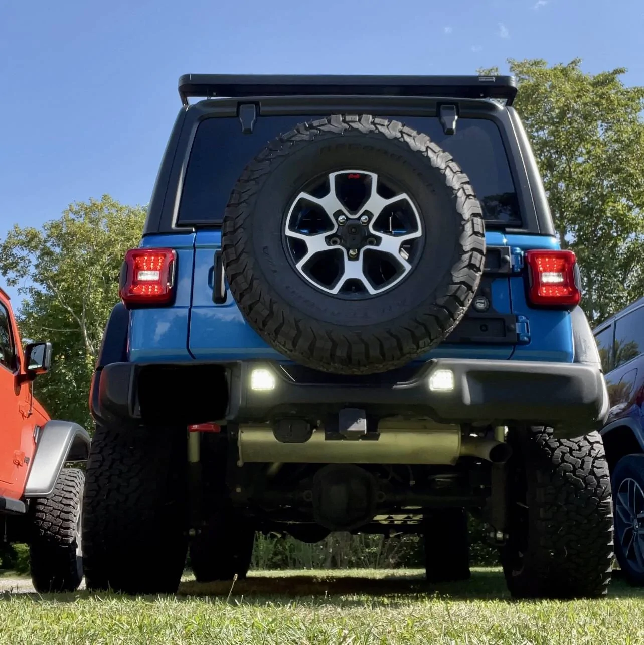

I used the plug and play harness on my ‘21 JLUR when installing the same Oracle reverse lights and had zero issues.
It was 100% plug and play for me.
The biggest pain was having to remove the entire bumper just to get the red reflectors out.
