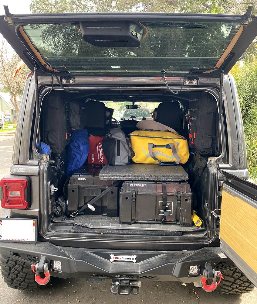

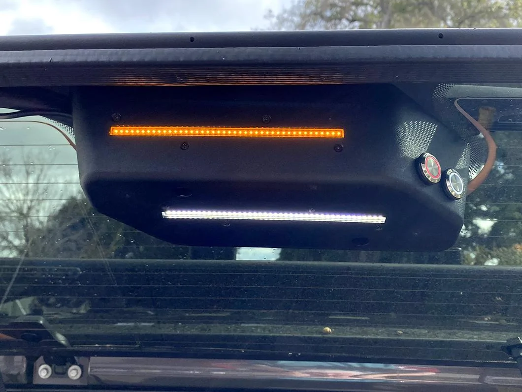

Installed the Oracle Cargo light
Finally got around to getting rid of the wiring mess had a Dometic fridge socket installed for the frideg and the oracle hardwired with a switch much better that the cig lighter socket with triple

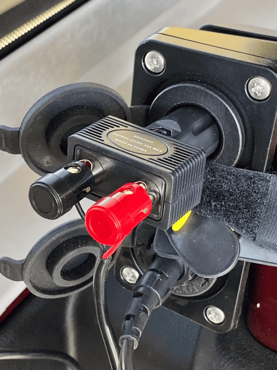

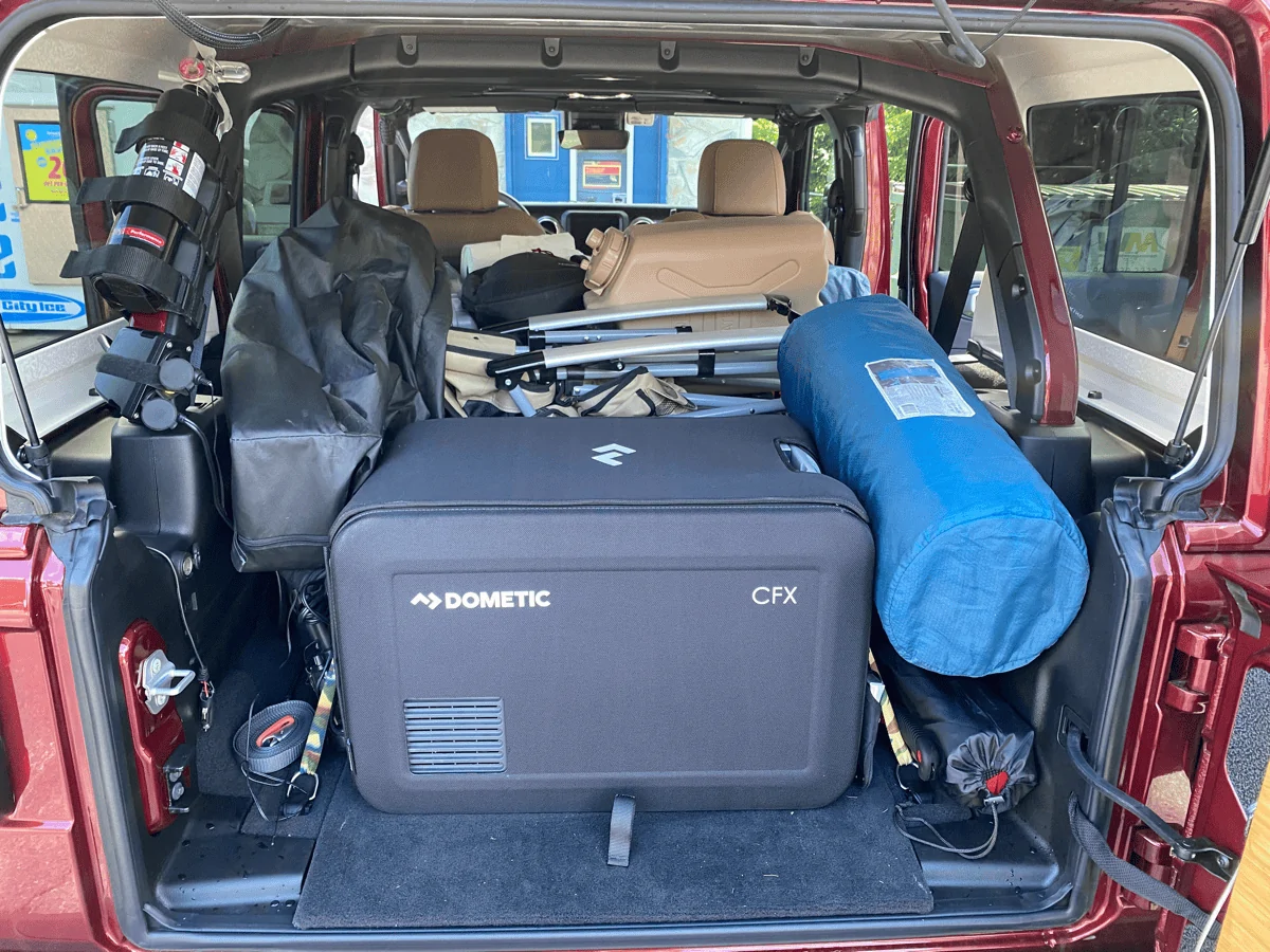

I smashed the Accessory Power adapter, as expected. In hindsight, I should have run it to my ARB hard wire extension, that I ran to the battery. Zoom in the to bottom left to see the carnage. Picked up a replacement Accessory Power adapter at Love's Travel Shop. Note I strapped the ARB hard wire extension to the roll cage base.
Dometic fridge connects to the 2 pin, and the Oracle light connects to the accessory port...the ARB hard wire extension runs through the panels to the firewall and over to the battery (comes with enough wire for a JLU).
