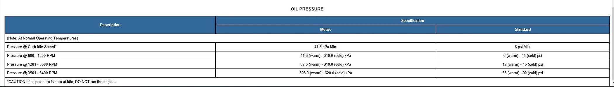

Curious what you are seeing in normal driving. I am normally around 30psi but sometimes jumps to 75psi when it downshifts to maintain 70-80mph.

During initial start up, take off and while above 3000 rpm, it is at ~75 psi, and at 32 psi under 3000 rpm after it warms up. On traffic stops while idling, it would be at 29-30 psi.

based on that my psi is on the high side as my oil temps were 200-219F and was ~75psi in the 3000-35000 range.

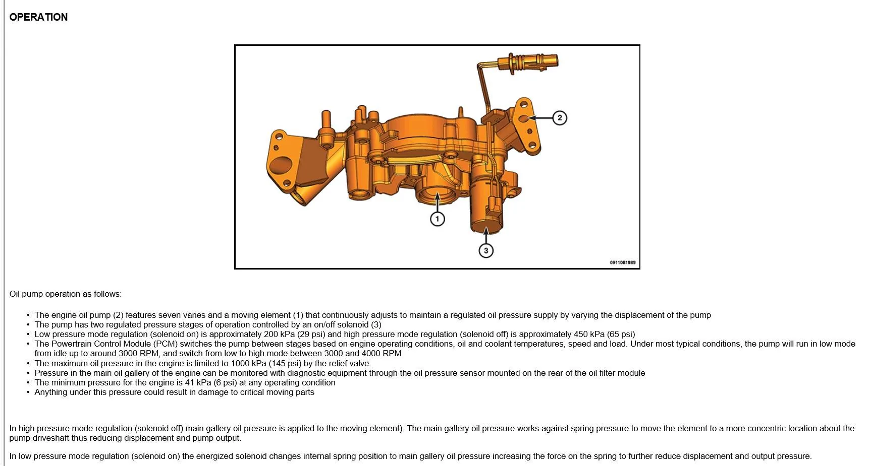

Second stage of the oil pump kicks in right before 3000rpm. Under that it should be in the 30s.
What you are describing is normal.

Mid 70s is what I was seeing on my 3.6
