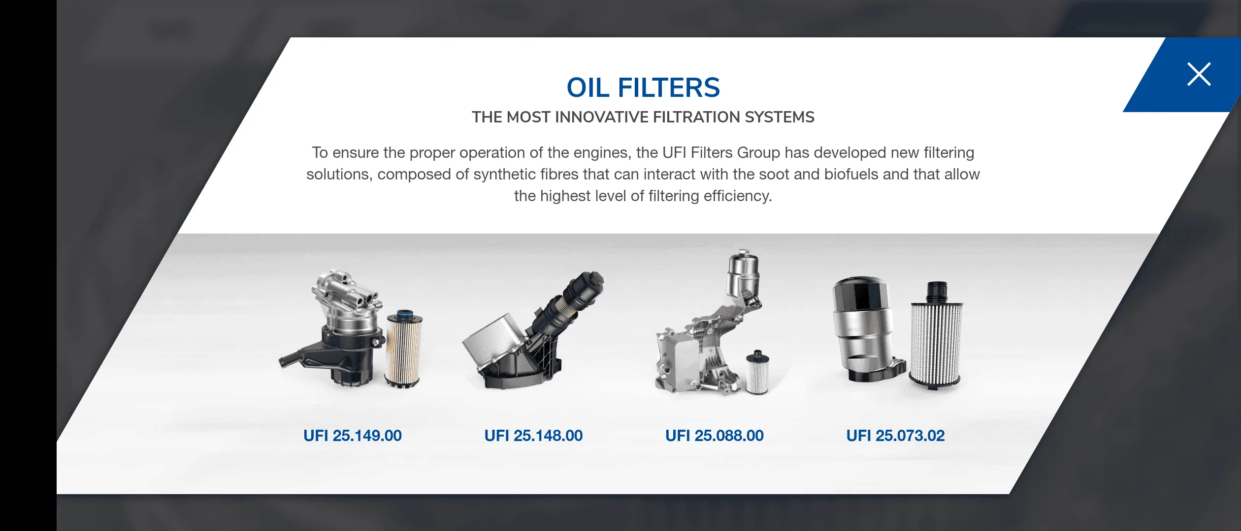

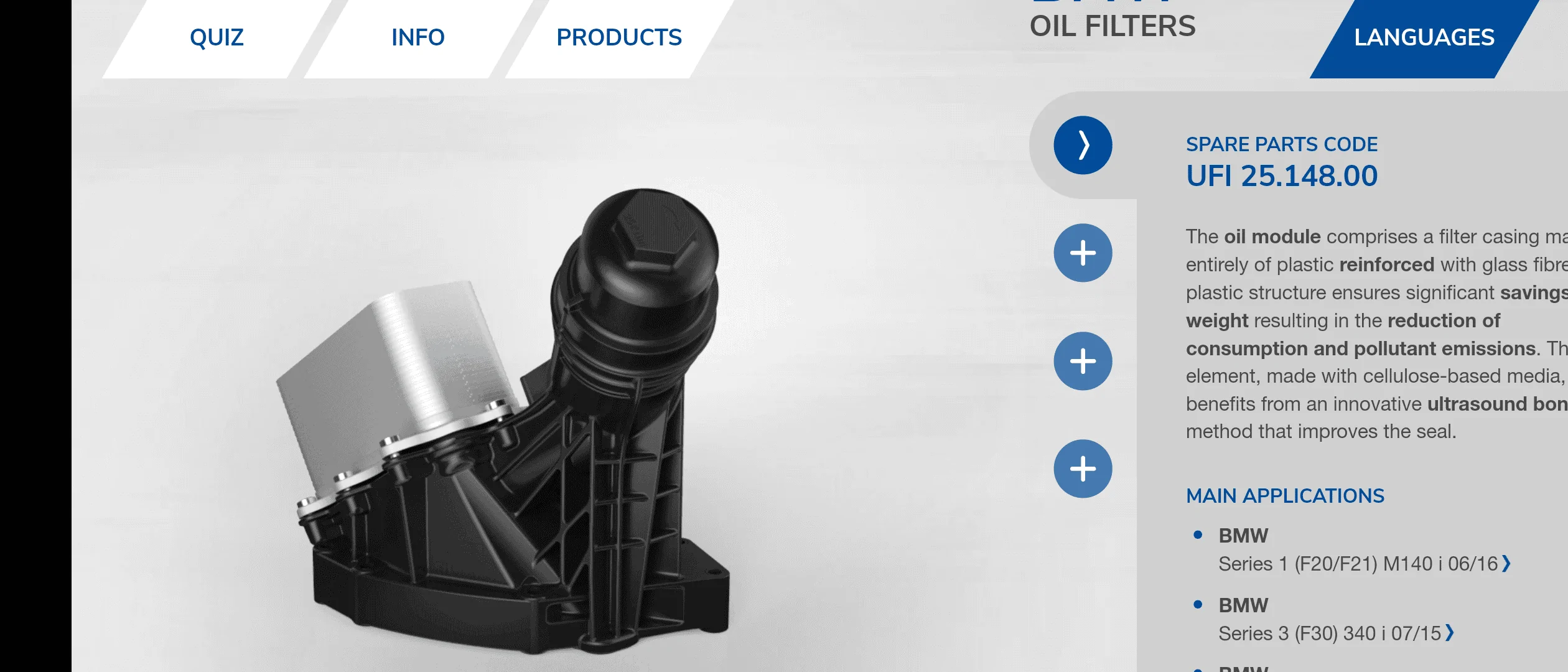

The oil filter housing is made by UFI, happens to be a company based out of Shanghai.
Jeep Wrangler JL Oil Filter Cover Thread Size??? Screenshot_20230224-175122
Jeep Wrangler JL Oil Filter Cover Thread Size??? Screenshot_20230224-175514
The same oil filter housing is found on certain BMWs.

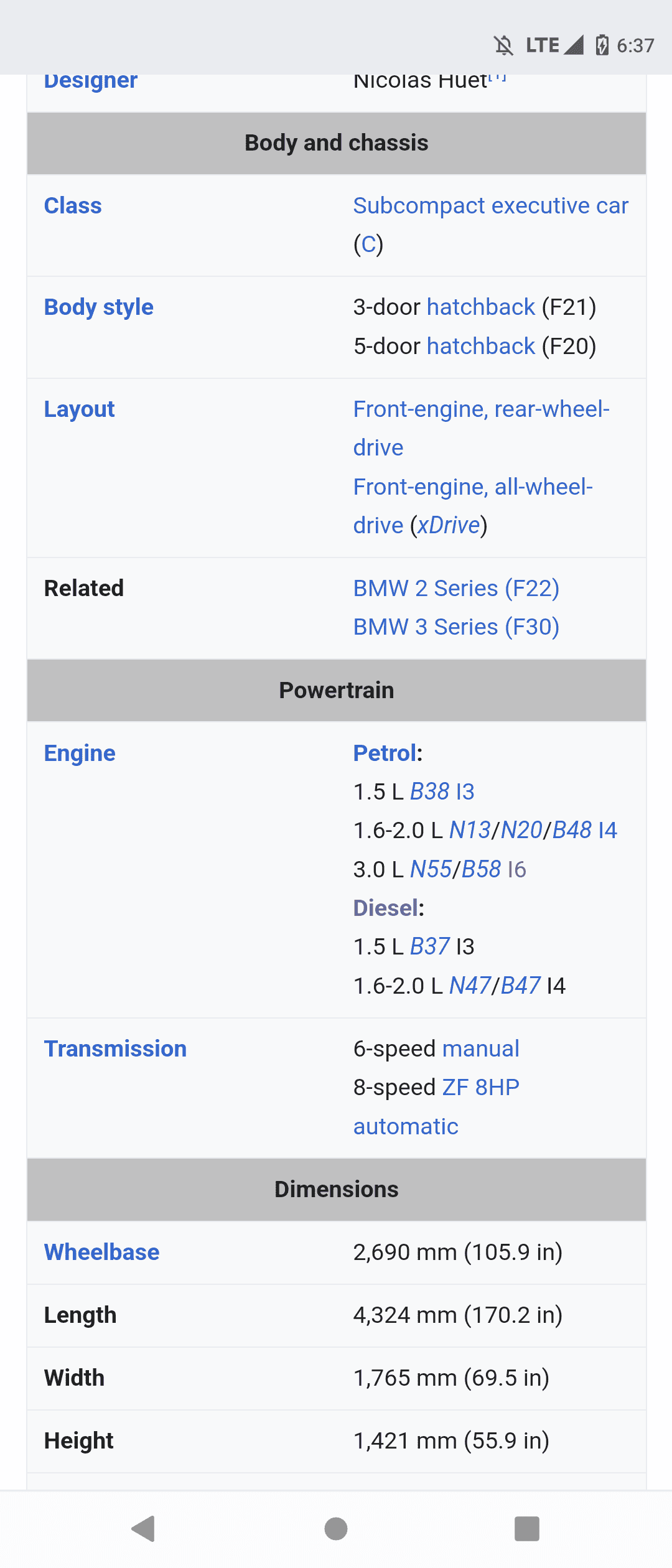

The BMW series 1 (F20/F21) hatchback has the Fiat 3.0 I6 Diesel. Without doing any research I would have to guess it's maybe the predecessor to the 3.0 EcoDiesel. Fiat as it turns out has been using different generations of the 3.0 EcoDiesel for the last 20 years.

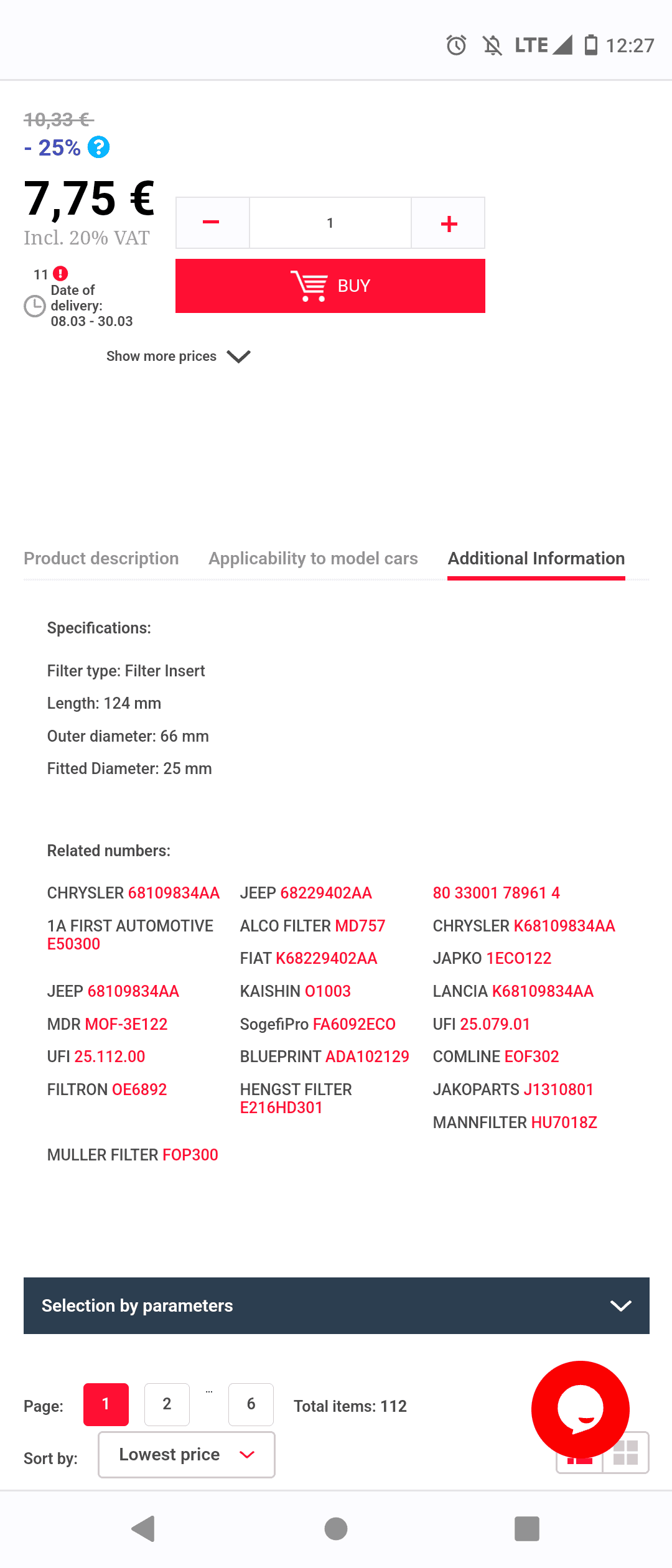

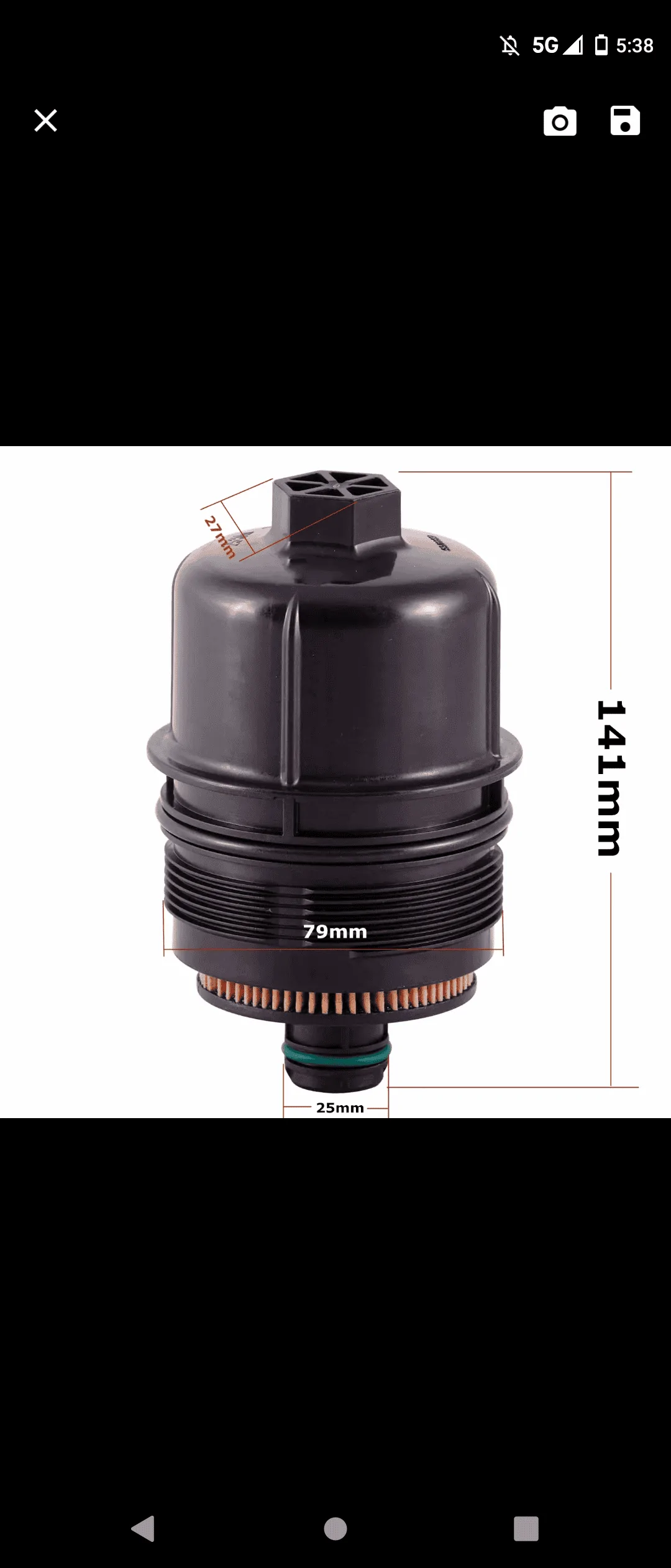

Above is a screenshot of the filter on the EcoDiesel, which is also applicable to those other vehicles.
EDIT: I should add that the dimensions in the photo above are for just the filter, not the filter cover. So the outer diameter is going to be rightfully smaller than the cover diameter.

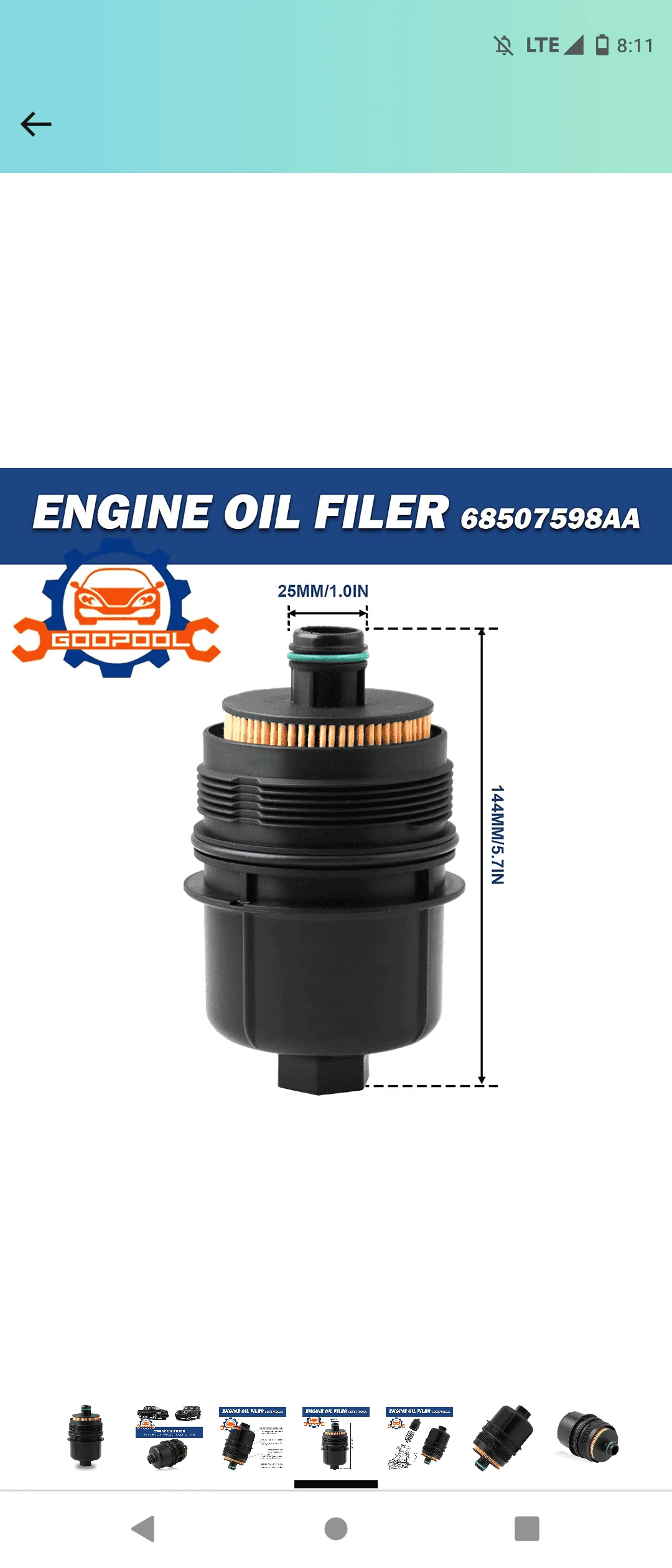

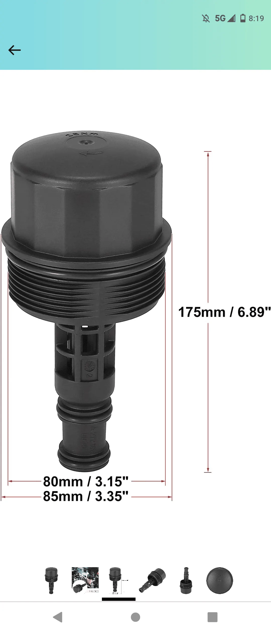

It's a process, but I figure my best bet is to figure out the threading on the oil filter cover and then use the diameter of the oil filter cover to find a adapter that would fit.
Being that UFI is a Chinese company I figured I'd have pretty good luck finding information on AliExpress. Go figure I found the diameter of the oil filter cover.
Jeep Wrangler JL Oil Filter Cover Thread Size??? Screenshot_20230224-173836
79 mm is the width of the threaded section. I have the diameter now I just need to get the thread size. And then all I have to do is pray that they have a adapter that is made in the same size. On the flip side I could actually have one custom made too once I get those specifications. It might be a little expensive, but I'd be up to give it a go in the years to come if I have to have one custom made.

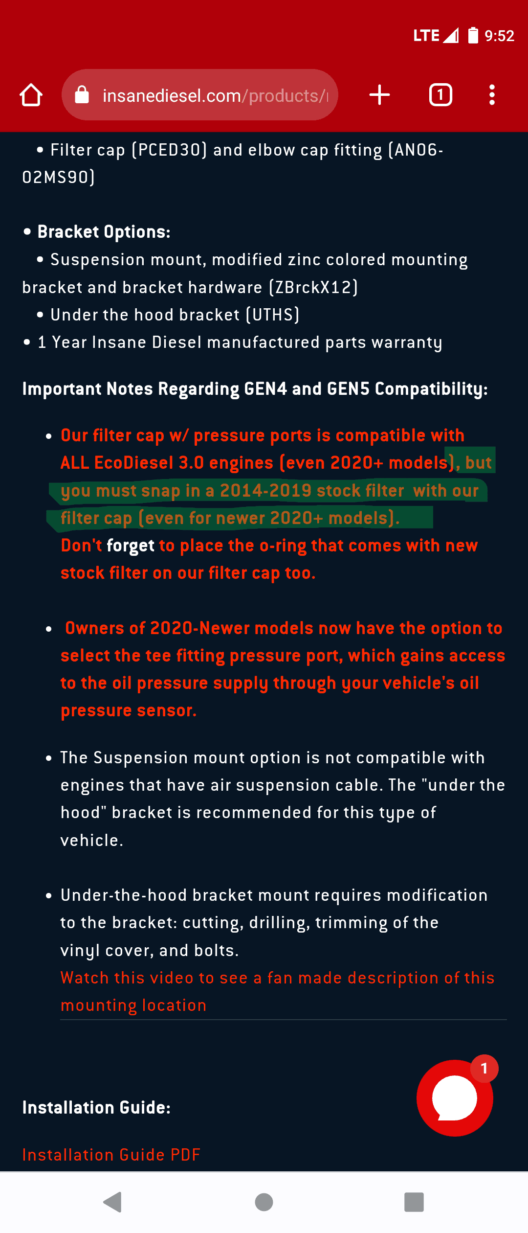

I was noticing that, I was planning on looking more into the Insane Diesel Bypass Oil Filter system. They do just that, obviously from the name. But I haven't been able to find a good video showing the parts and or how they work enough to see if they actually go to each port, the inlet and the outlet.
Deleted User 38384
Aug 4, 2020
140
6,081
10,669
  • Thread starter
  • Banned
  • #8
Jeep Wrangler JL Oil Filter Cover Thread Size??? Screenshot_20230226-095356-109
https://insanediesel.com/collection...gler-3-0l-ecodiesel-bypass-oil-filtration-kit

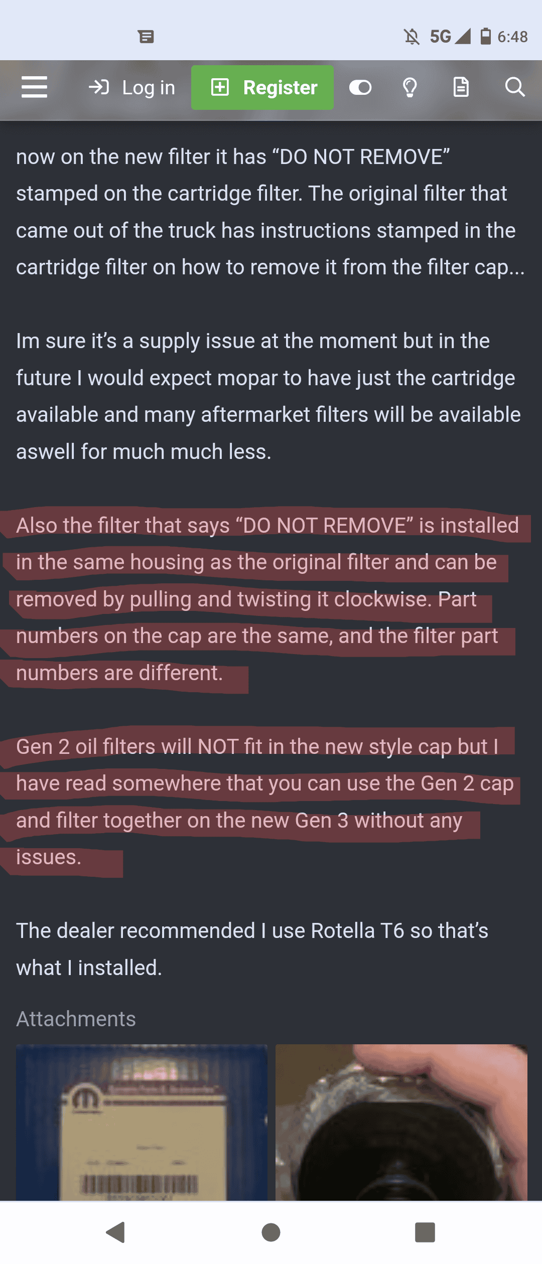

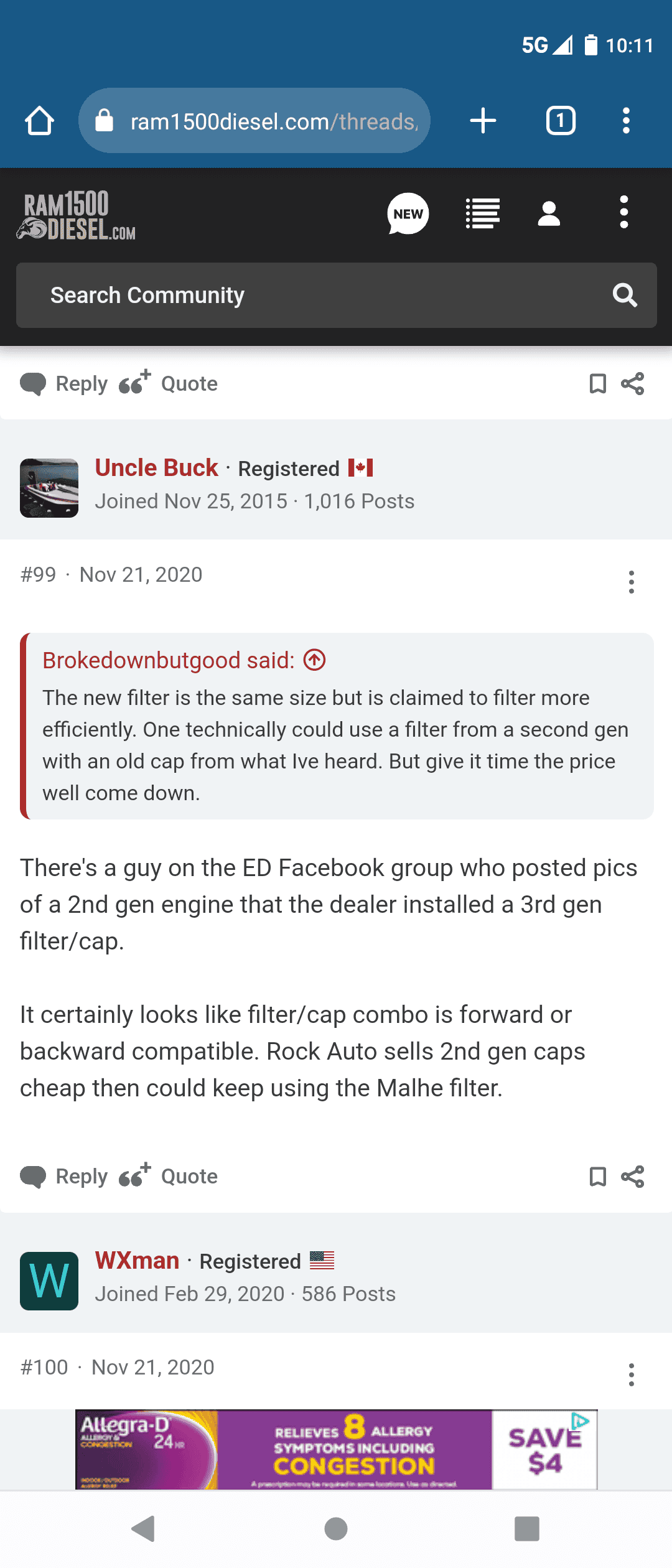

Per the Insane Diesel website, to make their oil bypass system work, you need to install an old Gen 2 oil filter. If a major company like that is insisting that you use a Gen 2 Mopar oil filter with their system, after all of their R&D, that leads me to believe that the speculation is correct and that in fact a Gen 2 oil filter will in fact work on the Gen 3 EcoDiesels.

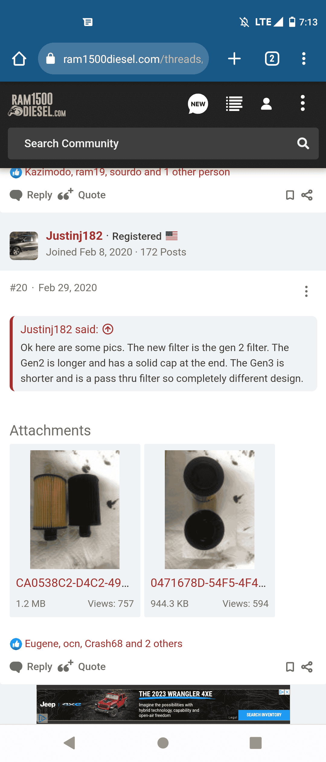

https://5thgenrams.com/community/threads/gen-3-ecodiesel-oil-filter.18970/
Jeep Wrangler JL Oil Filter Cover Thread Size??? Screenshot_20230226-191317
Jeep Wrangler JL Oil Filter Cover Thread Size??? CA0538C2-D4C2-4957-B36C-71F7CA12F505
Jeep Wrangler JL Oil Filter Cover Thread Size??? 0471678D-54F5-4F42-A357-7BE6FABE7612
https://www.ram1500diesel.com/threads/gen-3-ed-oil-filters.67923/

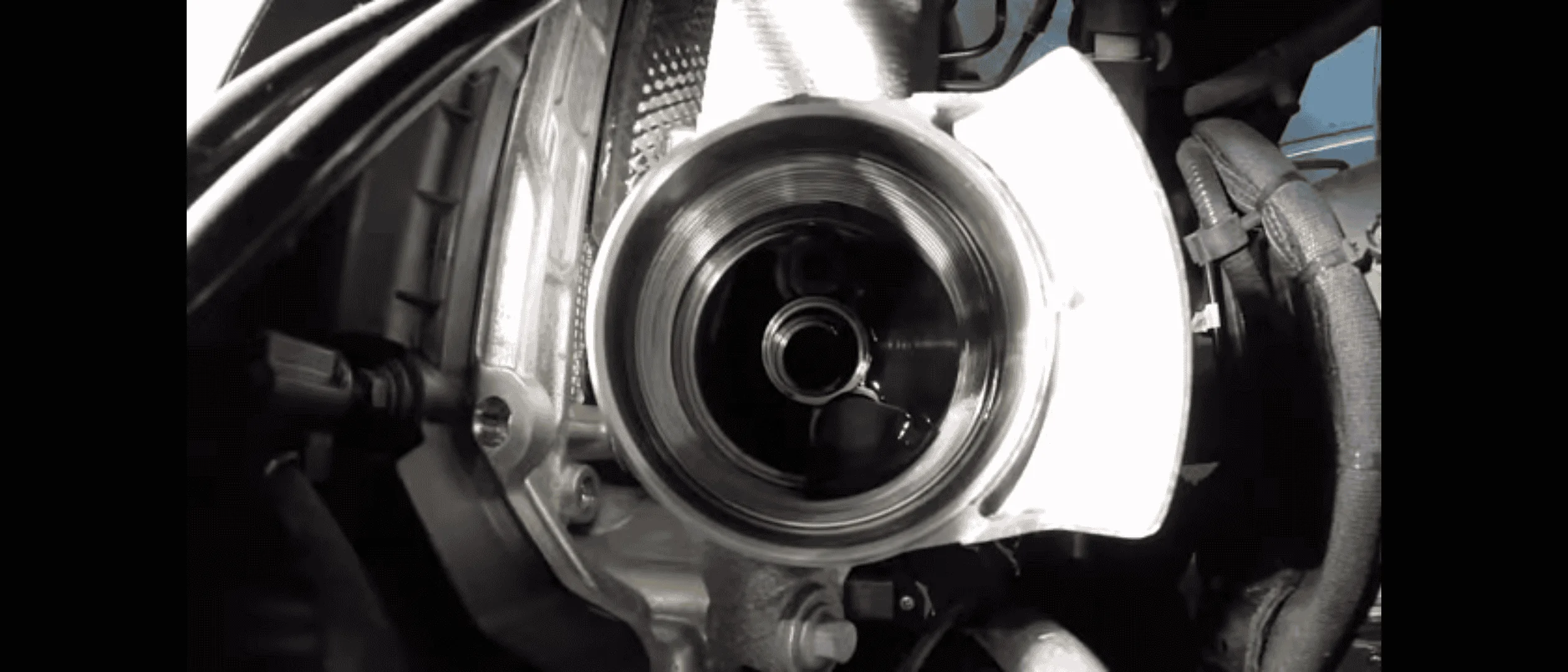

So this is the assembly entrance I guess you could call it for the oil filter/cap on a third gen 1500 EcoDiesel.

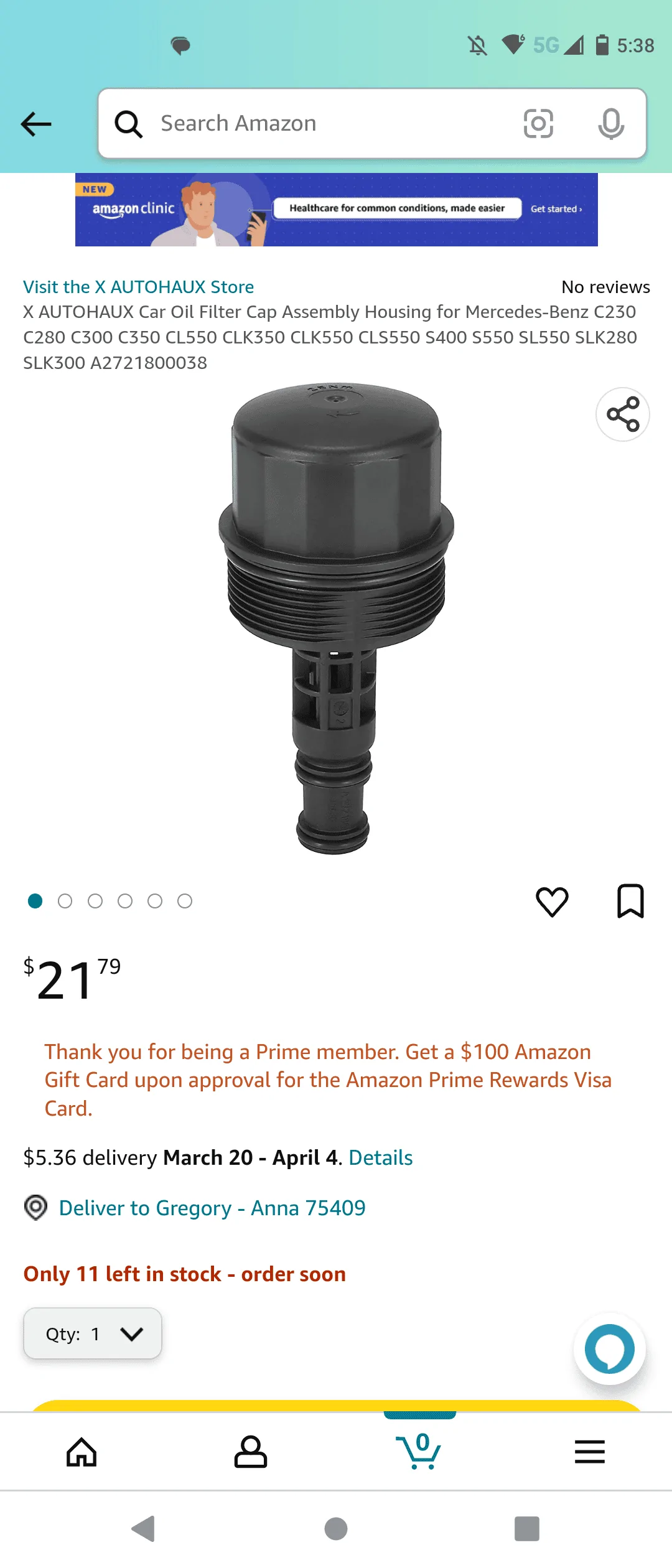

This is the oil cap to a Mercedes diesel from the early 2000s which also fits into an earlier version of the same UFI oil filter assembly that's on the EcoDiesel Wrangler.

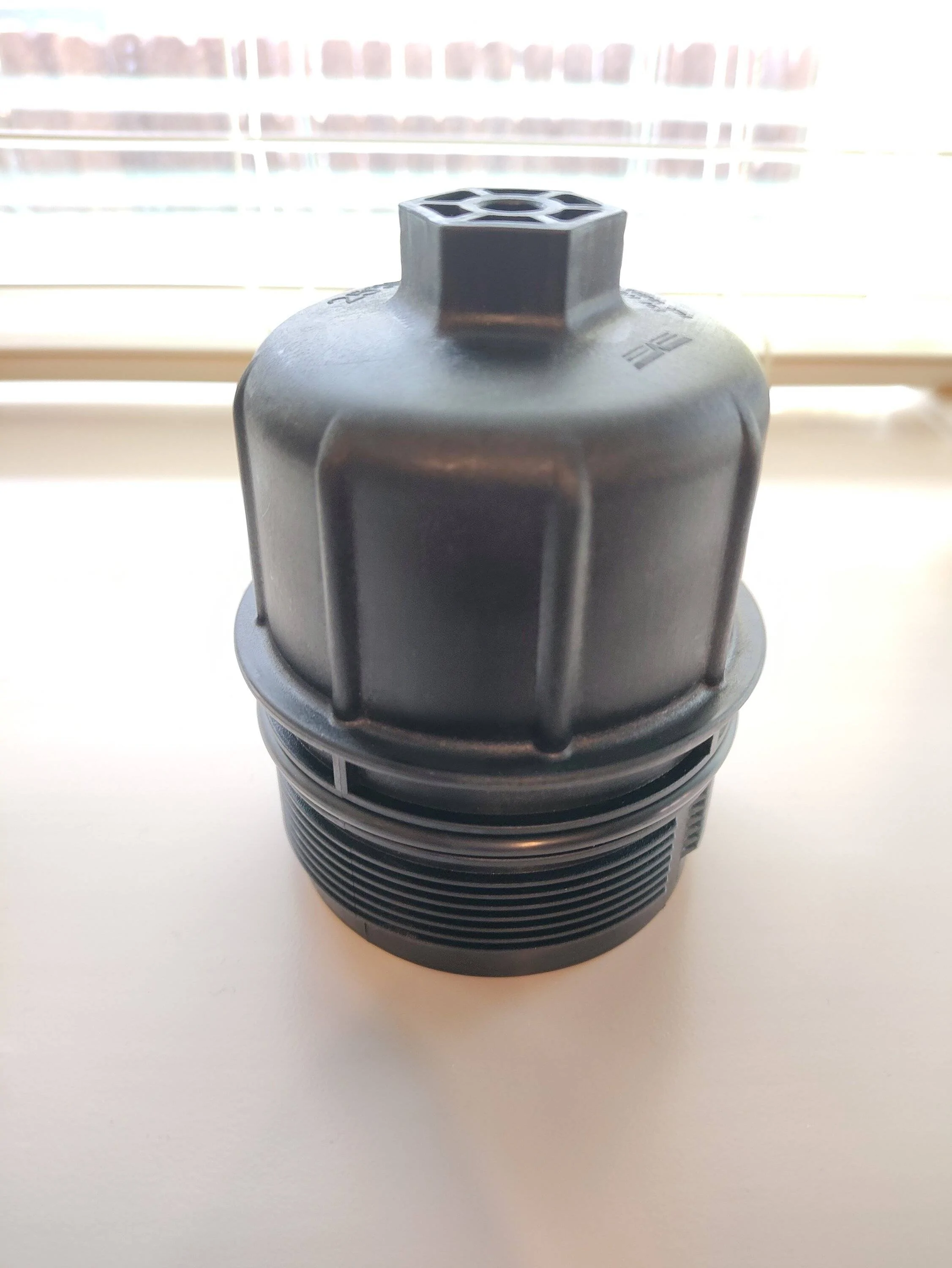

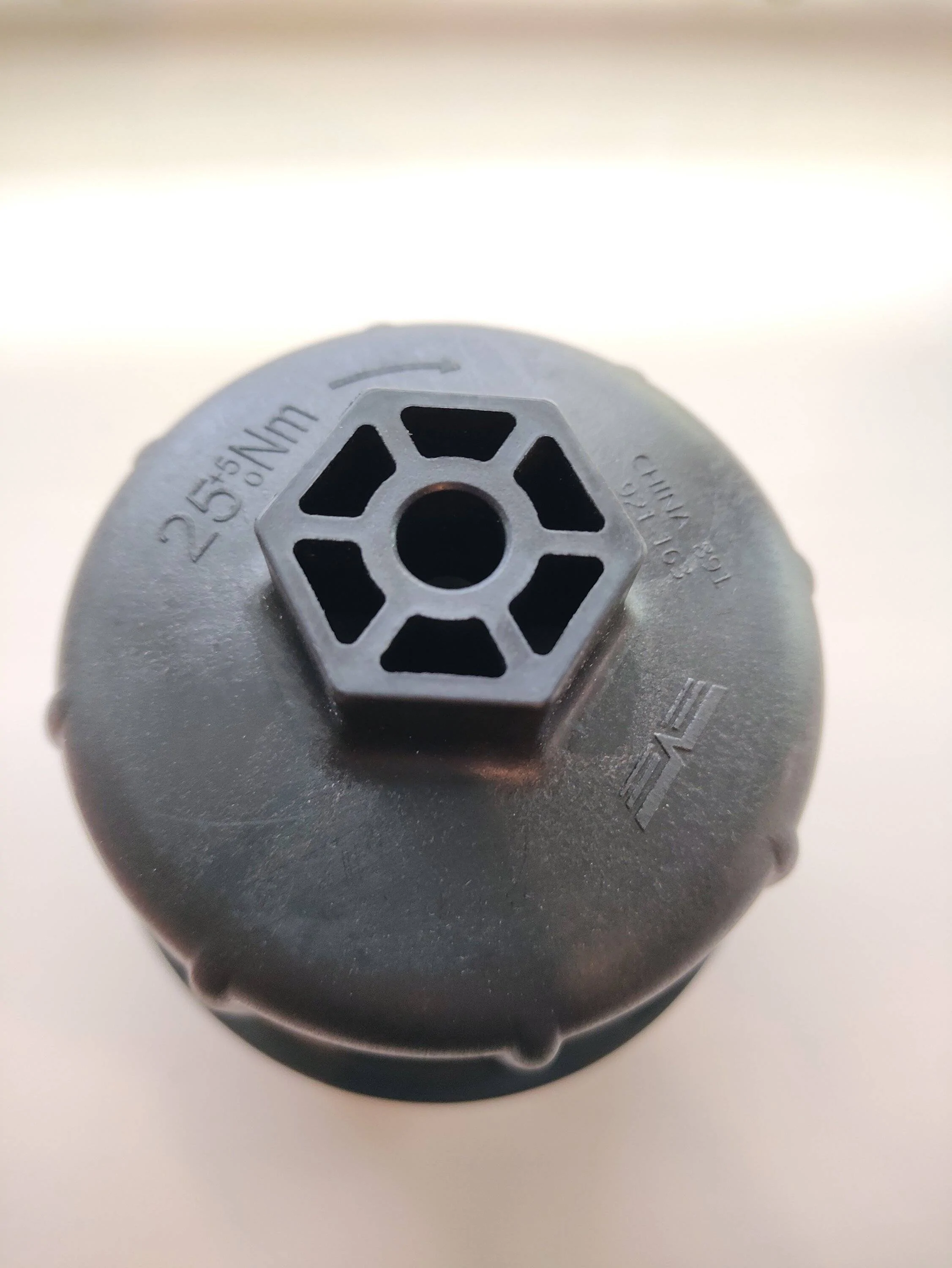

This is the Dorman oil filter cover for the 2017 Jeep Grand Cherokee 3.0 EcoDiesel...
Jeep Wrangler JL Oil Filter Cover Thread Size??? IMG_20230524_182659464
Jeep Wrangler JL Oil Filter Cover Thread Size??? IMG_20230524_182632605
Jeep Wrangler JL Oil Filter Cover Thread Size??? IMG_20230524_182654251

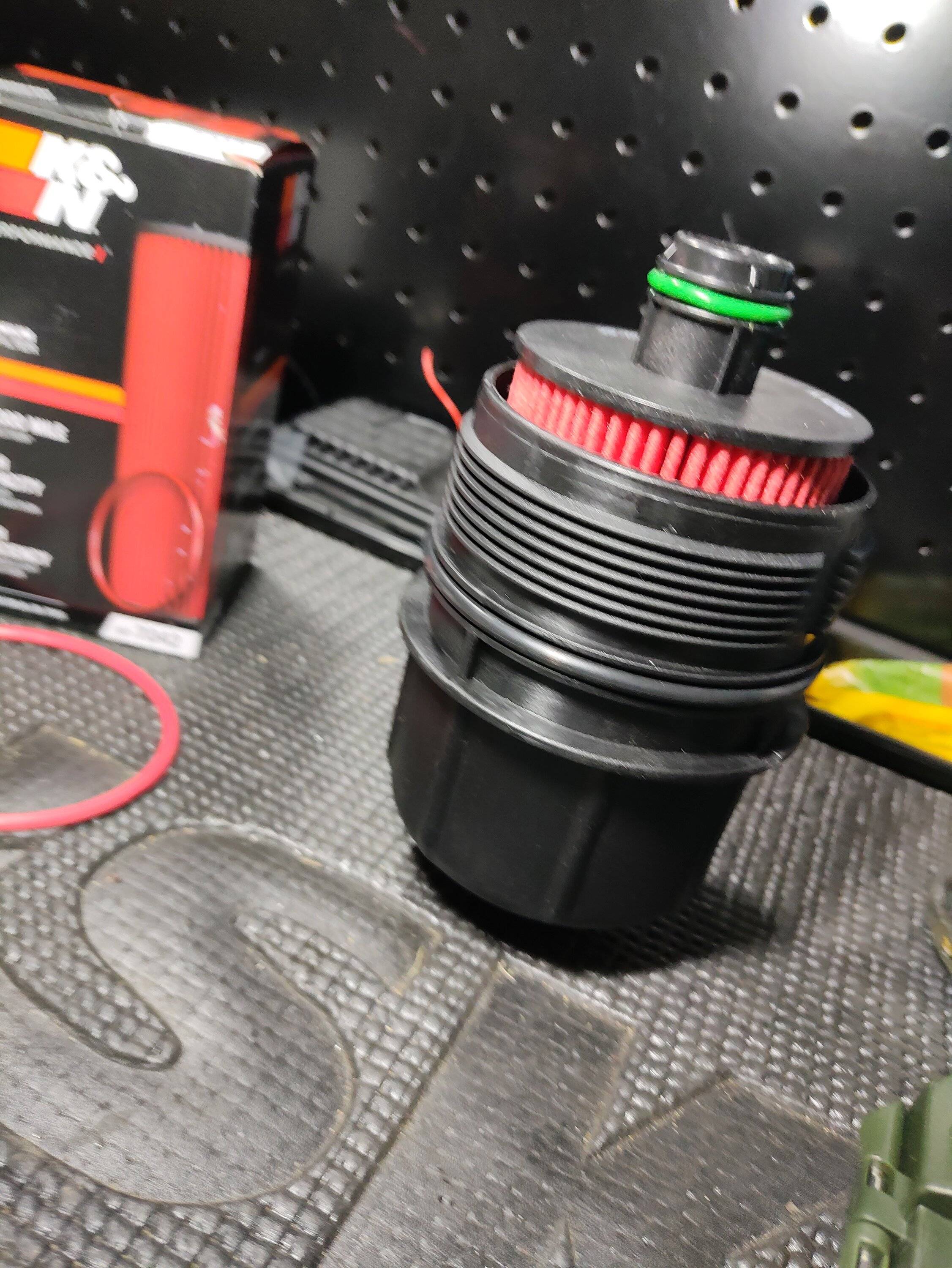

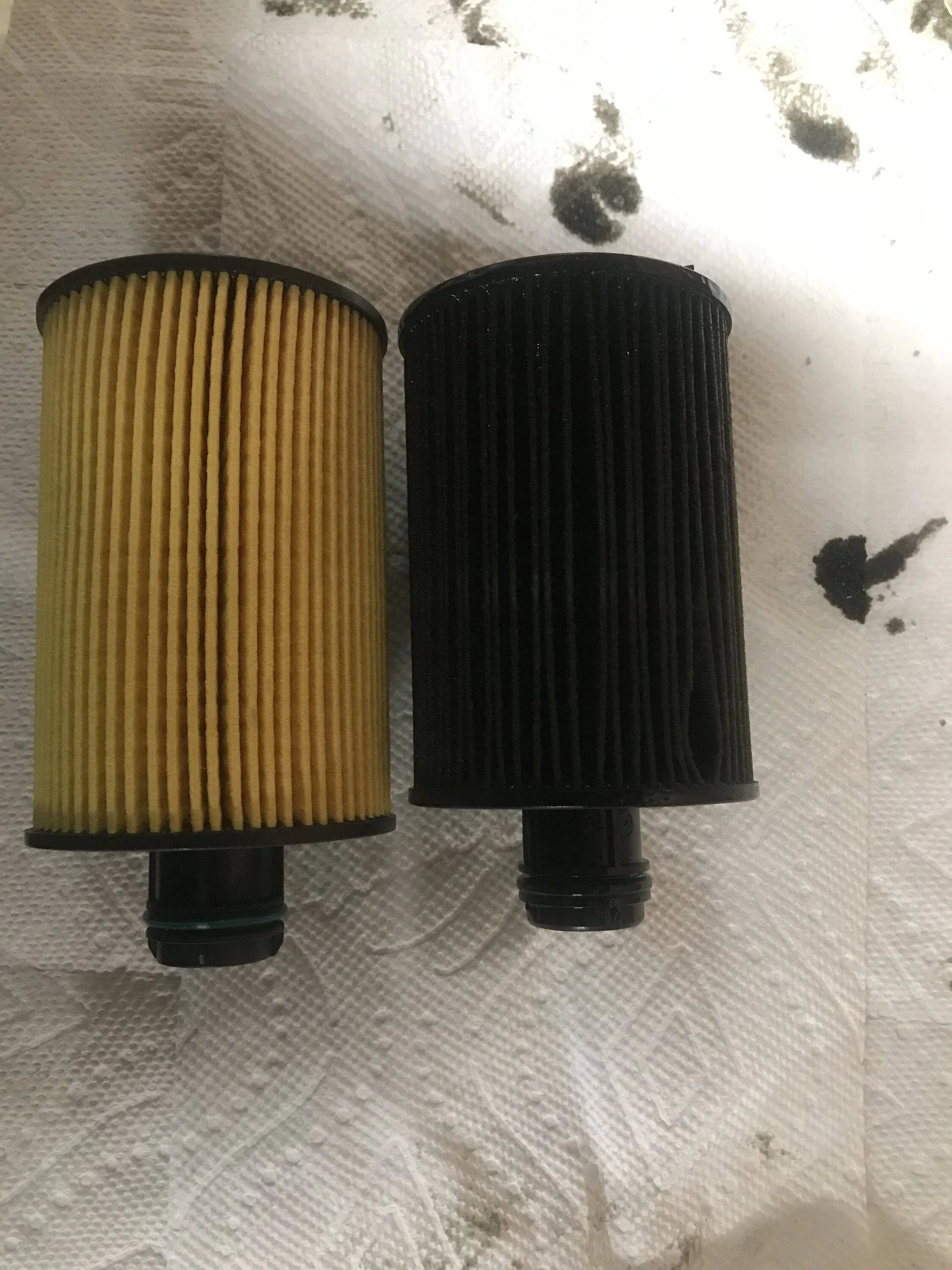

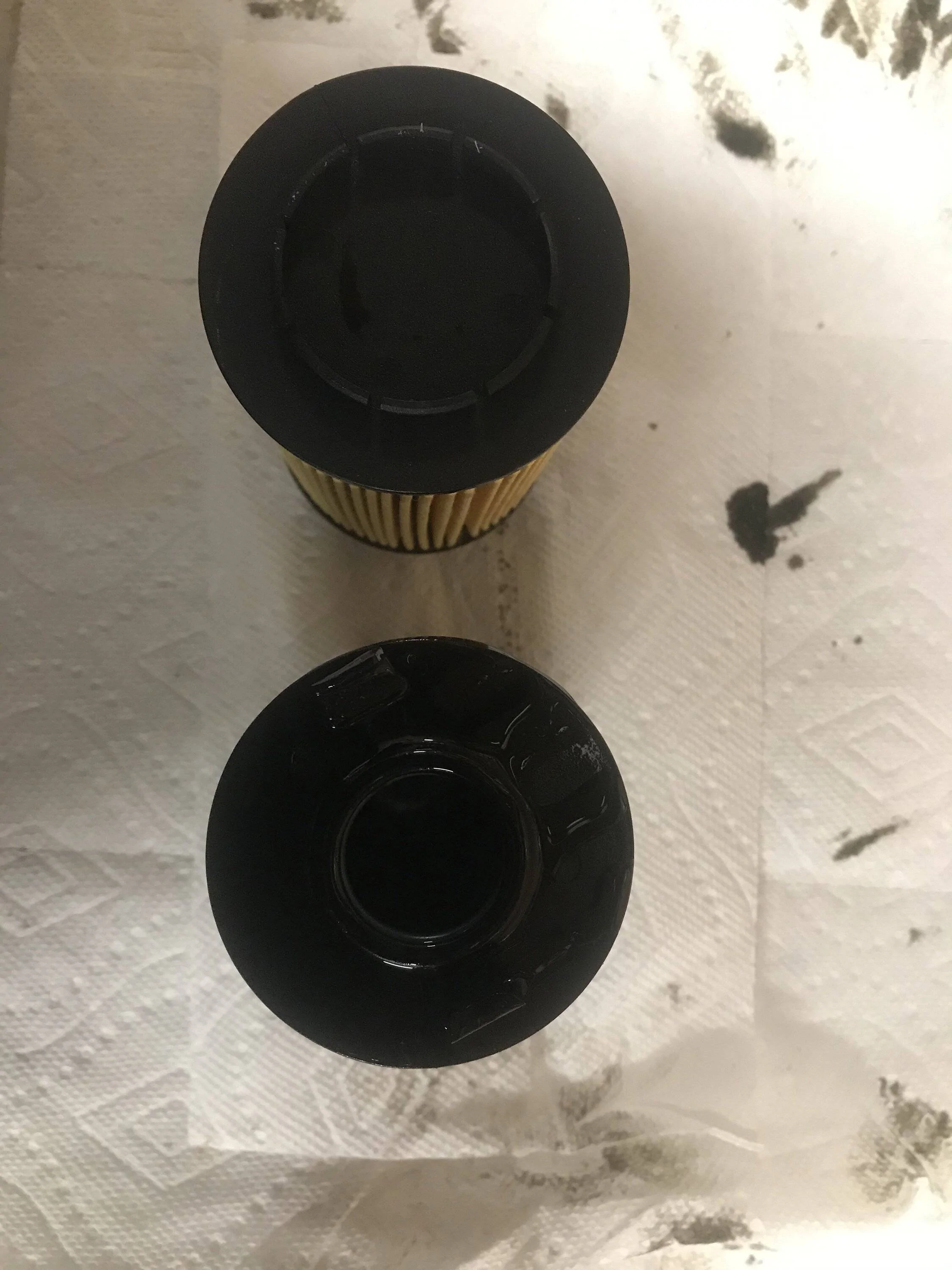

After a lot of people's recommendations, I decided not to skimp out on the oil filter itself. Turns out K&N makes an oil filter for the older 3.0s. Only $14 on Amazon!!
Jeep Wrangler JL Oil Filter Cover Thread Size??? IMG_20230530_182556318
Jeep Wrangler JL Oil Filter Cover Thread Size??? IMG_20230530_182653551
Jeep Wrangler JL Oil Filter Cover Thread Size??? IMG_20230530_182621381
So now the cost savings is complete. I'll probably order a second Dorman oil filter cover soon just in case I break the first one. According to the RAM forums, it's always good to have a second one on hand.
So after I have the initial two Dormans, which were $30 with shipping. $60 total if I have two. And another $60 for two five quart jugs of Pennzoil, Plus this $14 oil filter, I'll have an initial oil change cost of $134, with a reoccurring cost of $74 USD... Not bad!
